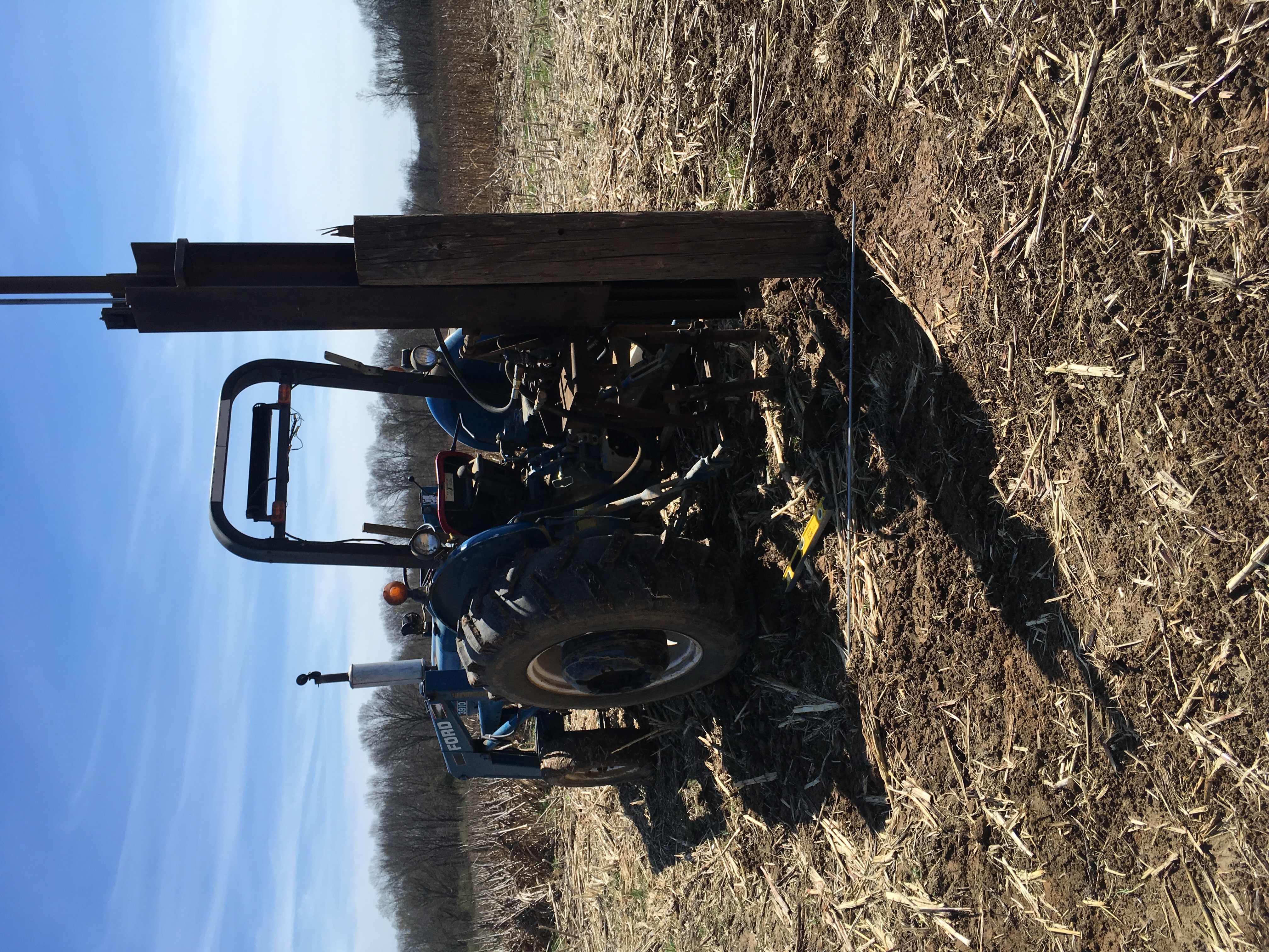

I've got an old Shaver HD8 that works pretty well, it would be nice to have some of the more modern safety items and I could see where the hydraulic adjustments would be nice rather than the screw cranks. But the screw crank adjustments aren't horrible to work with either.
Two days ago I put in a few posts for a new pasture I'm fencing off, this is a 9" post at the small end and I put it 3' deep. I did sharpen a point on the end as it is a big post, the ground was plowed about 10" deep a month ago. As always the usual first 12" is easy, I will add the wetter the ground the better and it will still be solid.

I live in colorado, and I have a post driver, and yes the soil gets dry and the soil gets like a rock,
I prefer putting in posts in the spring when things are wet, they drive very easily, when it is hard, I use a steel pipe that has been pointed and drive it first, (some companies call them rock breakers,) actually I have two of them oen about 3" and one about 6 1/2" I will drive the small one and most of the time I acn then drive the wood post, if it is really hard, I will drive the larger one as well and pull it and then drive the wood post,
I made my post driver, and I think it works well,
