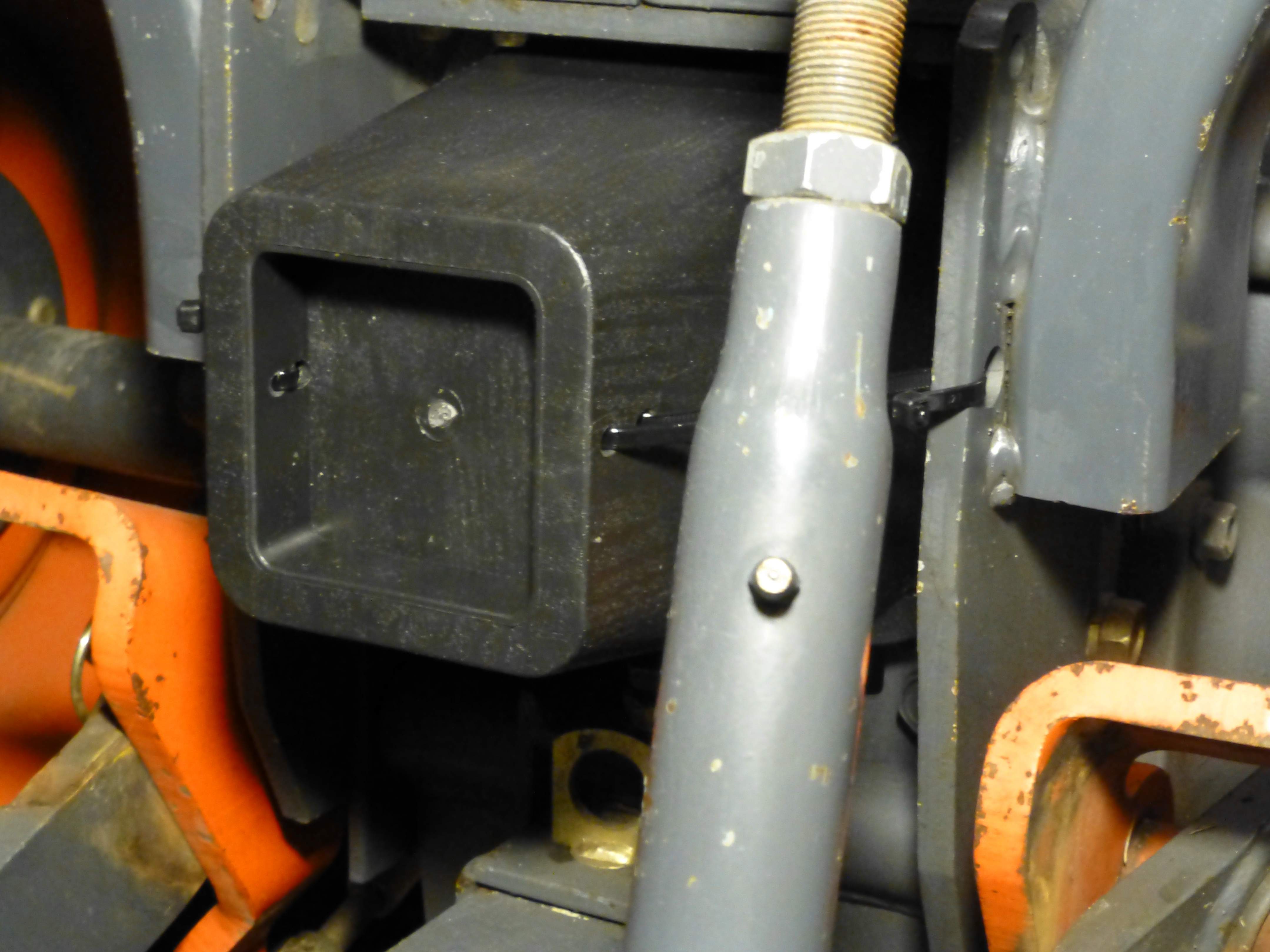

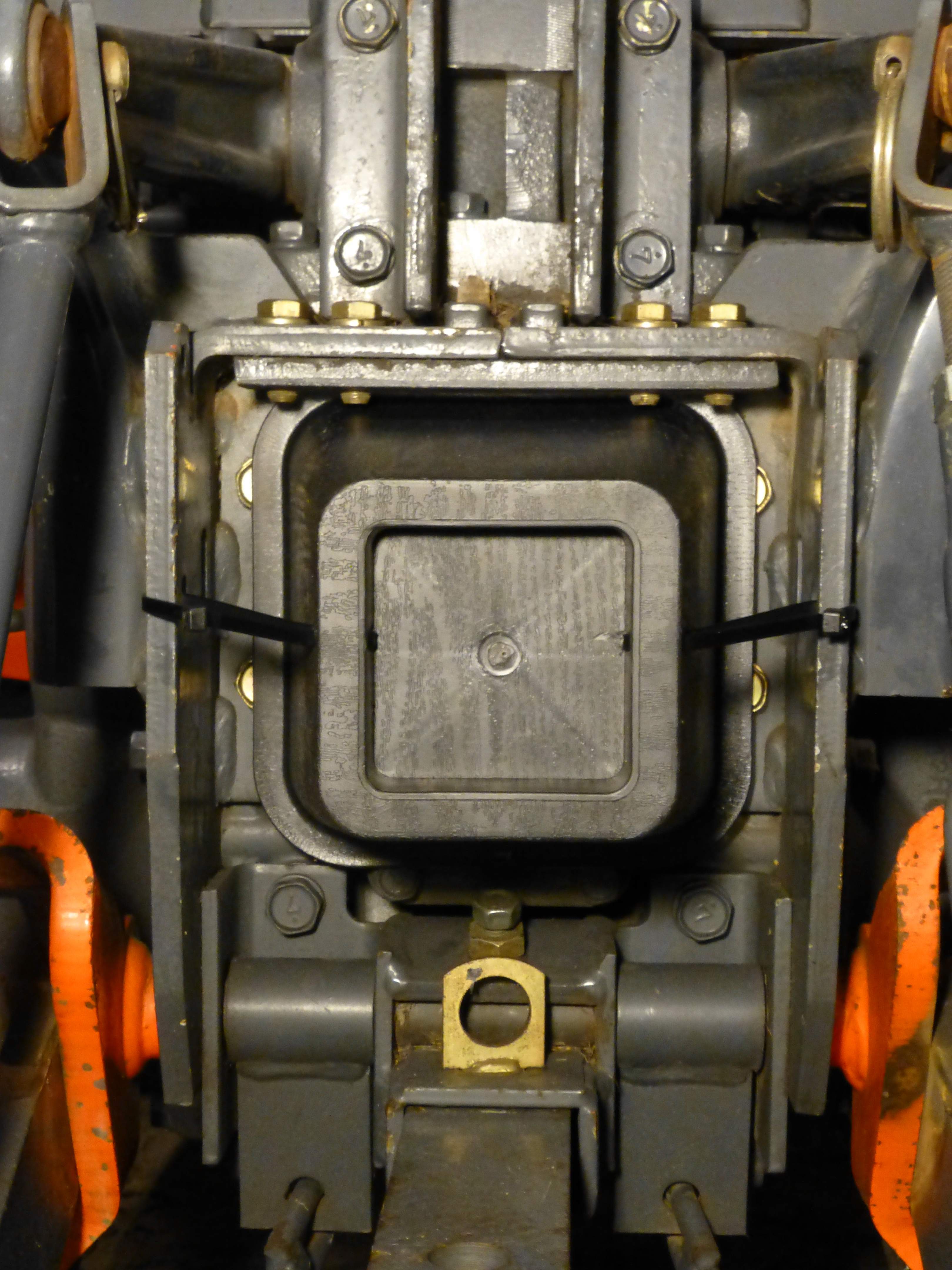

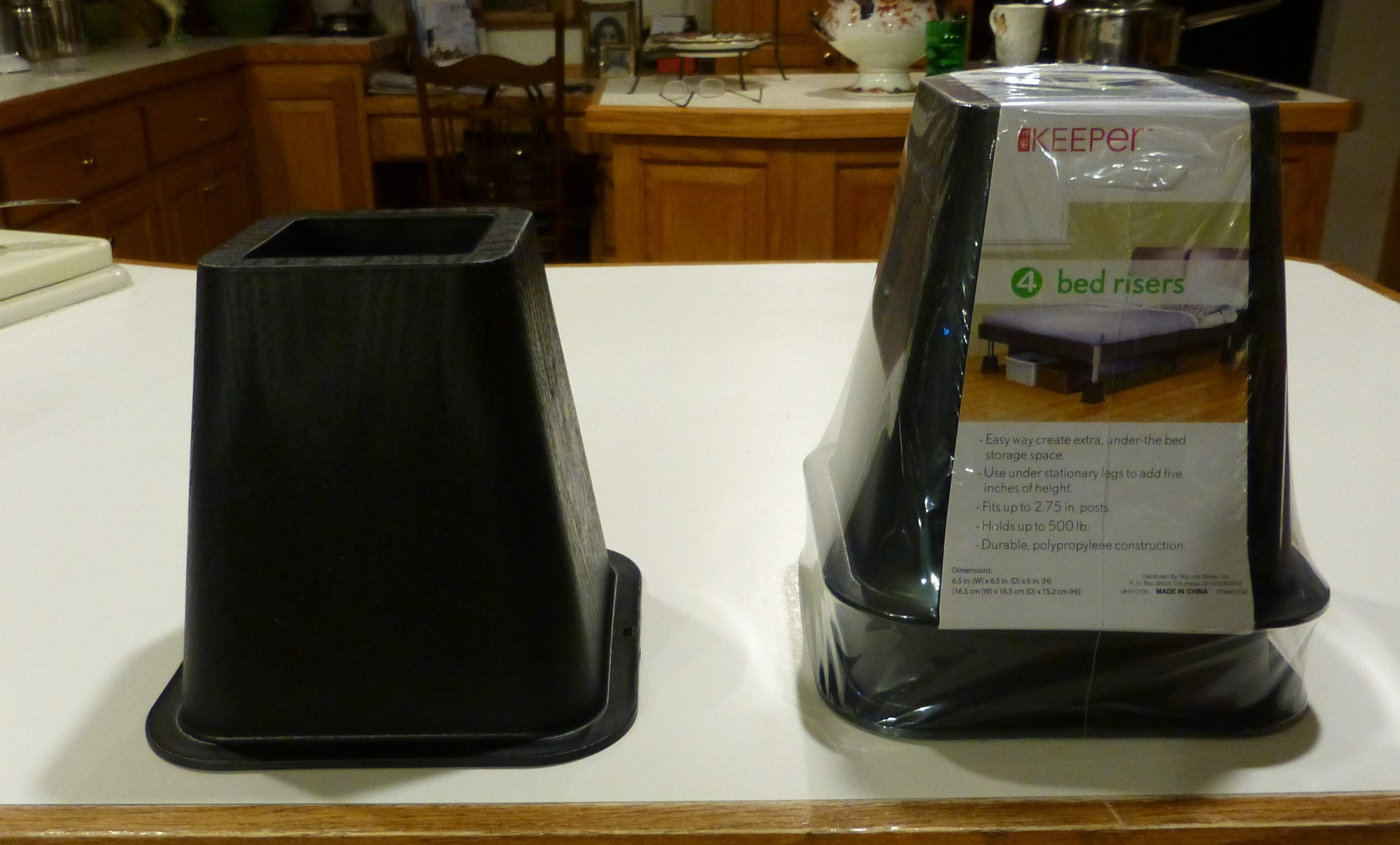

Mission accomplished. While shopping in our local Big Lots store I came by a set of 4 heavy black plastic Keeper Bed Risers.

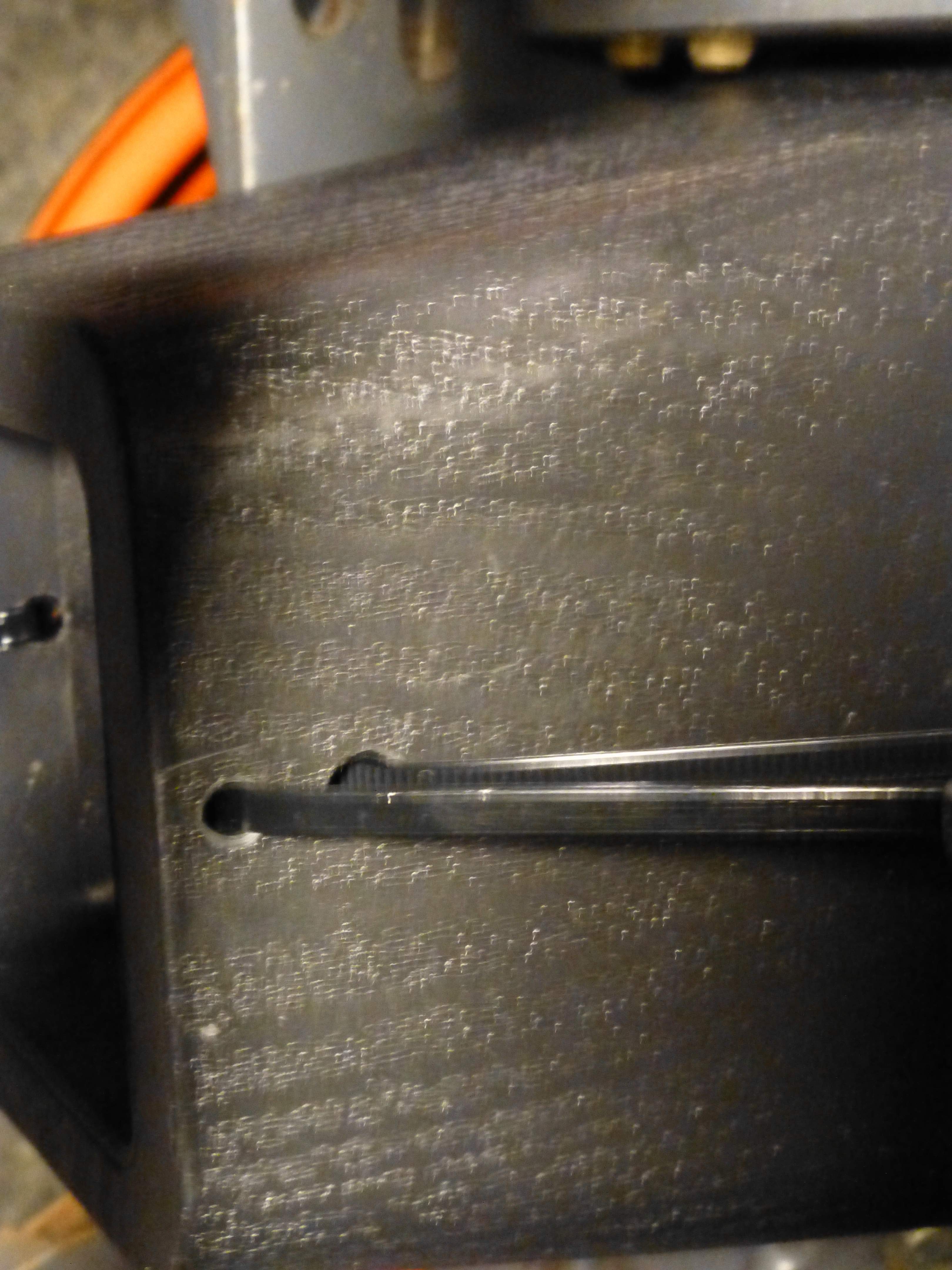

They fit great and completely cover the rear pto. Just drilled 2 small holes in each side and fastened with 2 black wire ties.
The price for a package of 4 is only $5.
Very sturdy and the way they are designed, they are out of the way of the PTO operation.
Need to hook up to the PTO, just cut the 2 wire ties and you are ready to go.
I will post a photo asap.
could you post a picture? It might help others.
