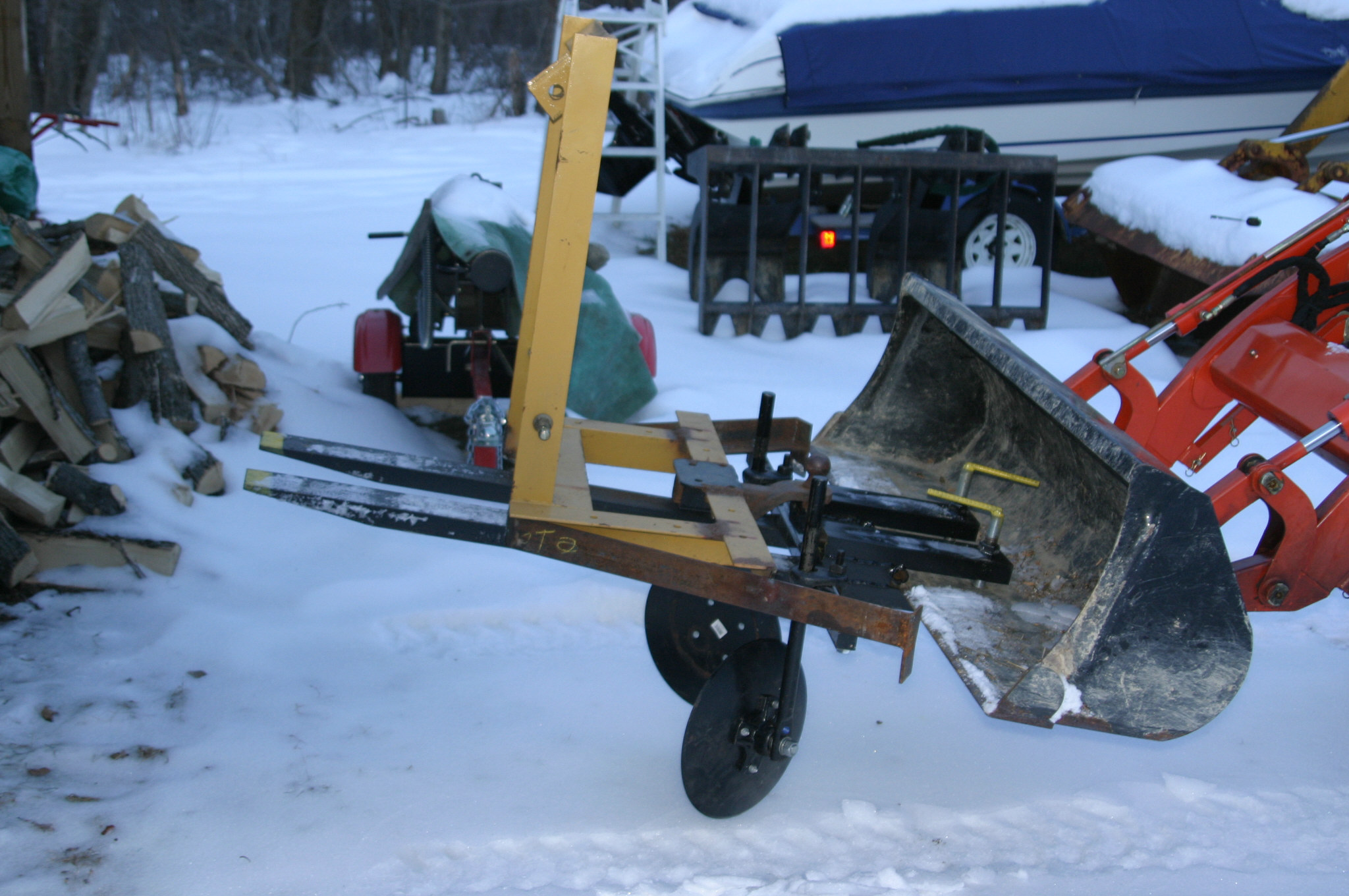

I built one;bought a cultivator fromTSC($150.00 or so),removed the center two springs,added the hiller disc(AGRI SUPPLY).I can removed and use the cultivator as intended.Note in picture;disc should be reversed from the way I built it ,but it works fine for making rows in the garden.I think AGRI SUPPLY sells a complete unit,or build your own from their parts.

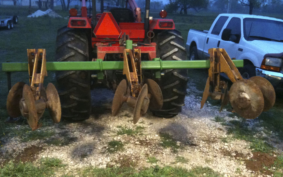

I visited a junk yard for farm equipment and bought 10' of 4" x 7" John Deere tool bar, the U bolts, and several sections of real hipper. I use a Speeco quick hitch, so I also of course made the hipper so I can just back up, lift, and it is attached.
My tractor is a M6800. You may need something smaller.
The tool bar was $7 per foot, the hipper sections were $35 each.
At one time I wanted a tiller. Now I just disk, and use the hipper. I guess that is why the farmers do it they way. They already know.

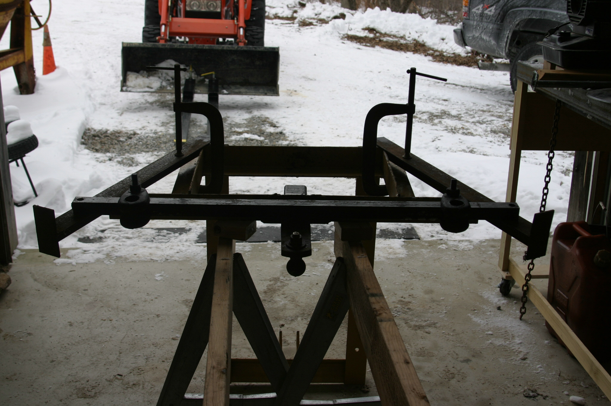

Here's mine, can't wait to try it out..
