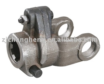

I would say that if your original sheer pin broke after 1.5yrs of use and then you broke 3 in a short period of time with the replacement gr2 I would stick a gr5 in it.
Are you sure there suposto be a gr2? Gr2 is piss poor chinese quality bolts. You can hardly get them tight with out stretching it.

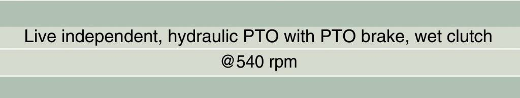

Who offers hydraulically driven PTO? Other than Power Trac, skidsteers and a couple others, but those are different types of machines in the first place.
Shear bolt works just fine and I do believe it's a better option for inexperienced users that don't know or neglect to maintain slip clutches.
We have this style that's very easy to change the shear bolt. Just a simple M8 grade 5.8 bolt. When it shears, it's as simple as pulling both halfs out, take the nut of the broke piece and slap a new one in.

Kubota does and the OP's MX5400 tractor has oneView attachment NEW_MX_KCL.pdf

"hydraulic PTO" could mean 2 things.....A PTO that is engaged by a hydraulic clutch OR a hydraulic driven PTO. My Toolcat has the latter...a hydraulic motor driving the PTO. I would assume the OP's MX5400 has a hydraulic CLUTCH on his PTO.

I copy and paste the line from the pdf, it is pretty clear: hydraulic pto, wet clutch

Well, you mentioned "hydraulically driven PTO" on your previous post. It a totally different thing than a wet clutch setup.
Yes, most tractors will have wet clutch for the PTO these days. The wet clutch uses hydraulic pressure to engage the clutch but the PTO is still all mechanically driven from the flywheel to the shaft at the back.
Hydraulically driven PTO is an hydraulic motor with a 6 splined shaft used to power PTO attachments. Pretty much same concept as an hydrostatic transmission, as in it's basically driven by fluid and therefore fall on efficiency versus the mechanical drive.

That is why Kubota's description of the MX5400 PTO doesn't make sense. You don't need a clutch if the PTO is hydraulically driven as all you do is turn on the hydraulic flow.

Tractors MX-5400, Brush Hog (aka Rotary Cutter) Is a Land Pride 6 Footer. I broke my first shear pin after having the brush hog a year and a half (but with only about 35 hours on the brush hog) Pretty good run and it's kind of expected to break one every now and then. I looked in my garage and couldn't find any 1/2" x 3" Grade 2 bolts so went to the hardware store, no luck there, only grade 5 and grade 8, so then went to dealer and they were out. So then went to Tractor supply and bought a 5 pack of country line shear bolts and broke 3 while mowing a half hour lol.

The Shear Bolt is to protect the drive line and gear box from over load. If you install a grade 5 or grade 8 bolt the dealership's parts department will love you. Instead of breaking the shear bolt you will break the drive line or the gear box when you hit that big rock or stump. Your call, but a 25 cent bolt is not very expensive.
If you decide to get a slip clutch, you will need to maintain it at least once a year by loosening the springs on the clutch, block the rotary cutter or rotary tiller so the clutch will slip and get all the dirt and rust out of it. Then retighten the slip clutch bolts to the factory setting. If you don't do this the slip clutch might not slip and you will be in buying a drive shaft.
