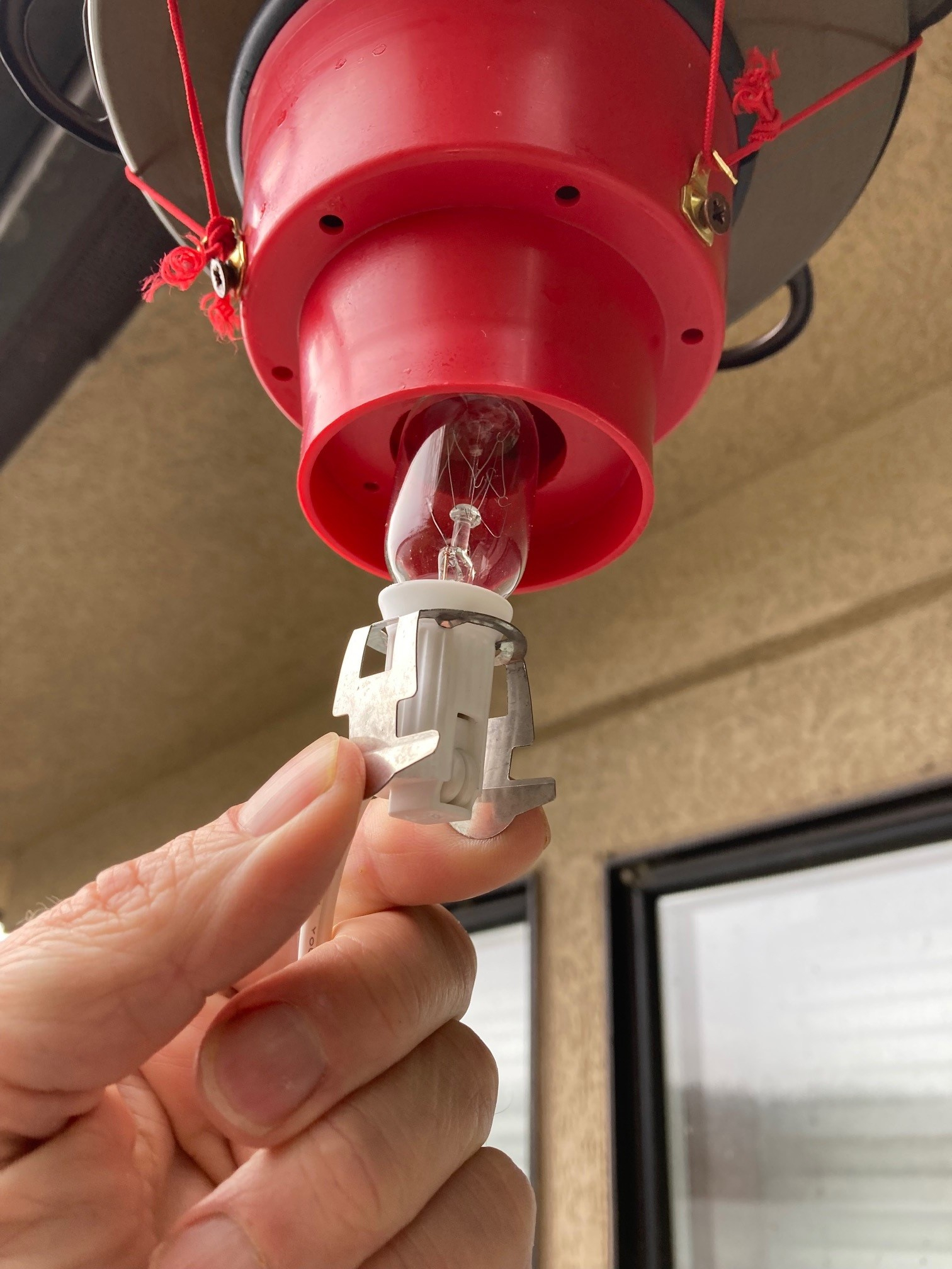

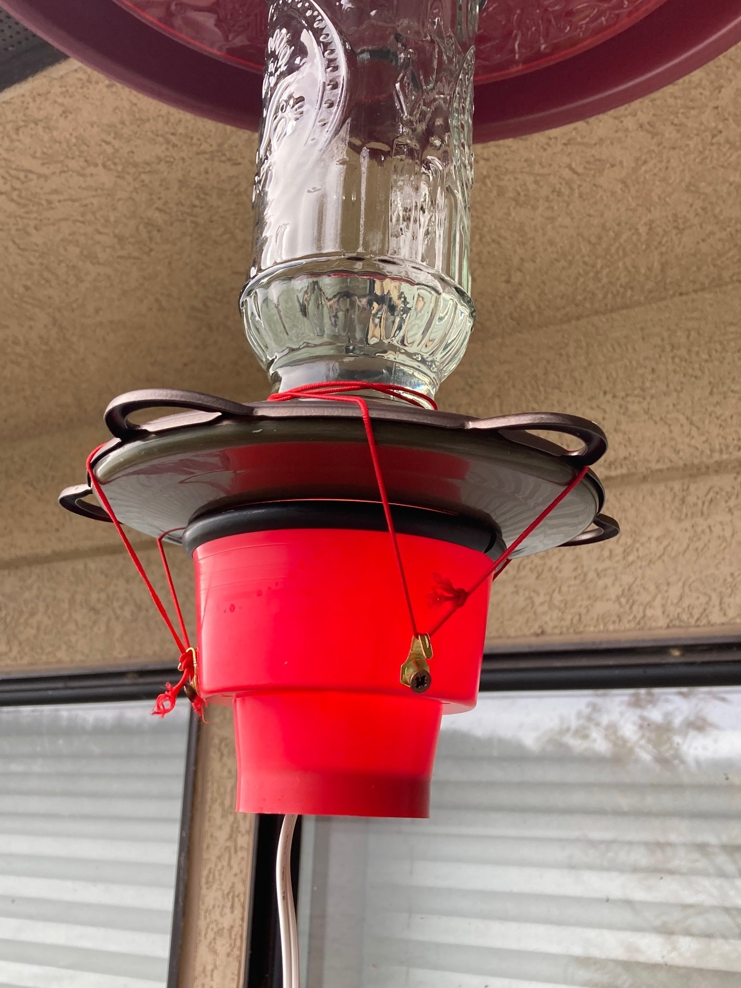

You have heated feeders? I want to see a pic of that!
The plastic feeders I bought use a 15 (or 7-1/2-watt) incandescent night light bulb, but I modified how my feeders attach. I have two, one US made, one China. The China one was total junk, I ended up even replacing the cord and socket. The US one was good, but it had 3 attachment "hooks" and my feeders do not have anywhere to hook onto other than the roosts which would make it hard for the birds to sit on. Plus I have 5 roosts, so it was always off center. I used the stretchy cord that came with the feeder (long rubber bands work as well), cut and tied them to the right length. I added picture frame hooks to attach the cords to. The bulb clips in and out from the bottom, so you can leave it outside when you are refilling.
