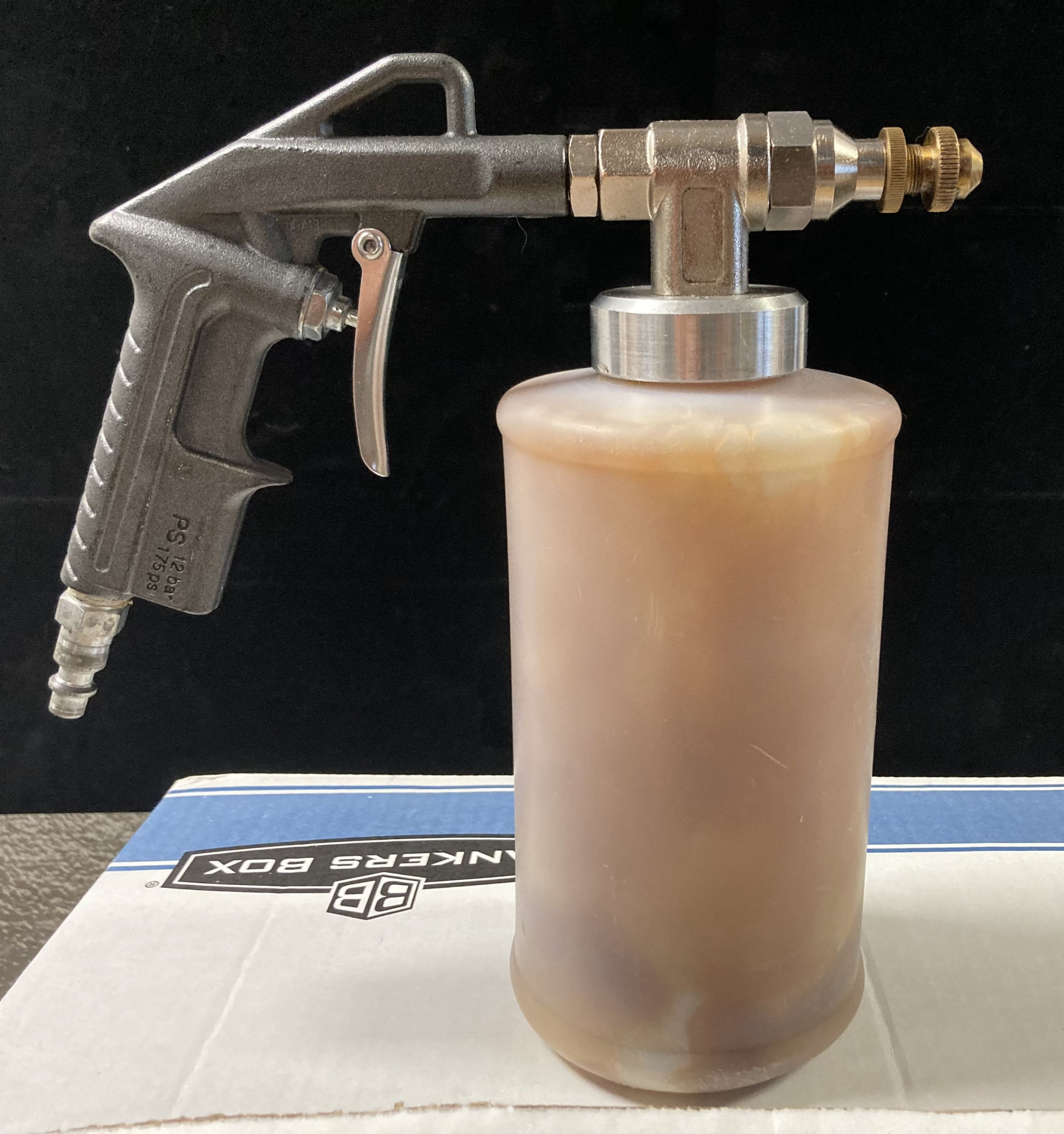

I have been using one for 6 years and it works good.
Included in my package is the long rod with 360° spray.
With my purchase of a new dump trailer in 22 I spayed it top to bottom to combat winter road salt.

Thanks! I saw that one, but what’s up with the fitting for air compressor?
   / Anyone buy or using the Fluid Film spray gun? #5
Not sure what you mean but here is a photo of mine.
Looks like we supply the compressor fitting.
   / Anyone buy or using the Fluid Film spray gun? #7
Yes as there are various types of fittings that people choose to install on their equipment.

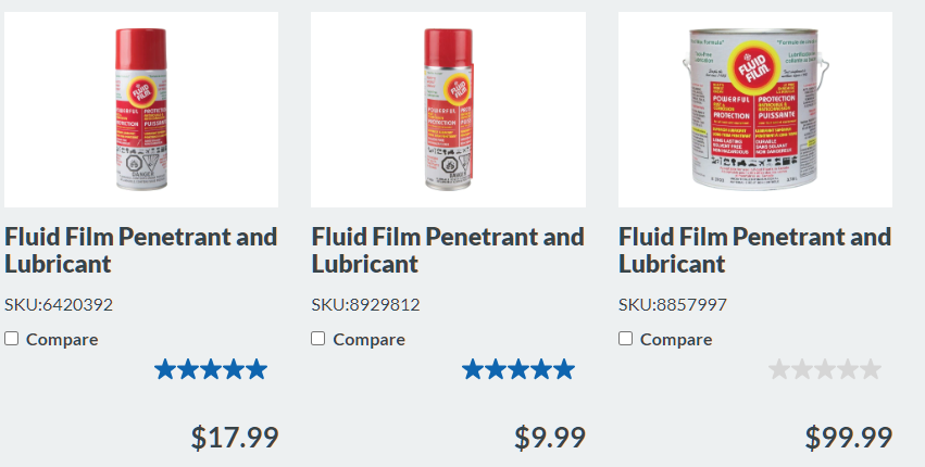

It claims to waste less Fluid Film and do better job than spray cans
Spray cans aren't cheap then again neither are gallon cans. Once spray cans get 1/2 empty they'll only spray pretty much with the can vertical. You get better more even coverage with a proper gun.
These are all in Canuk bucks at our local Princess Auto, Can. version of Harbour freight. Presently the CAN$ is US$0.75 so the US price is 3/4 the Can price.
