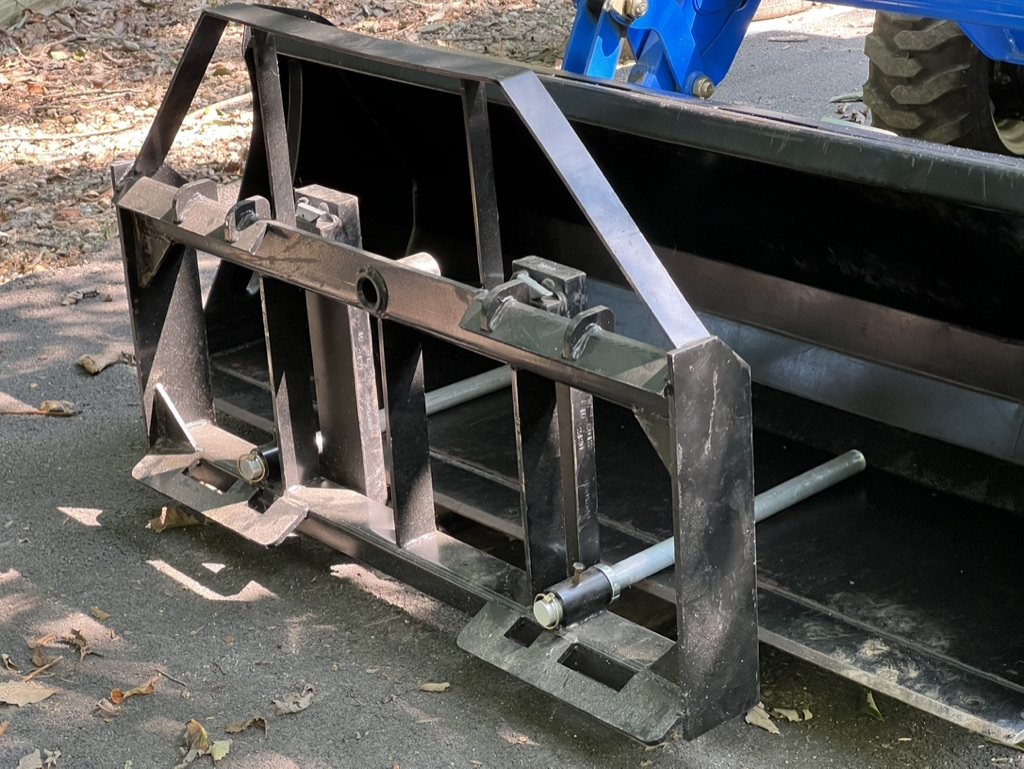

   / Anyone built a 3 point implement shed? #13
I put removable rods in my pallet fork frame so that I can lift it, backwards, with the bucket. Thus the forks point toward the tractor and hide under the bucket when the tractor is parked in the barn. It adds very little to the overall length. To use the bucket I just set the forks down and back out from under the rods. To use the forks, I also remove the bucket, drive around to the other side, and pick the forks up.
