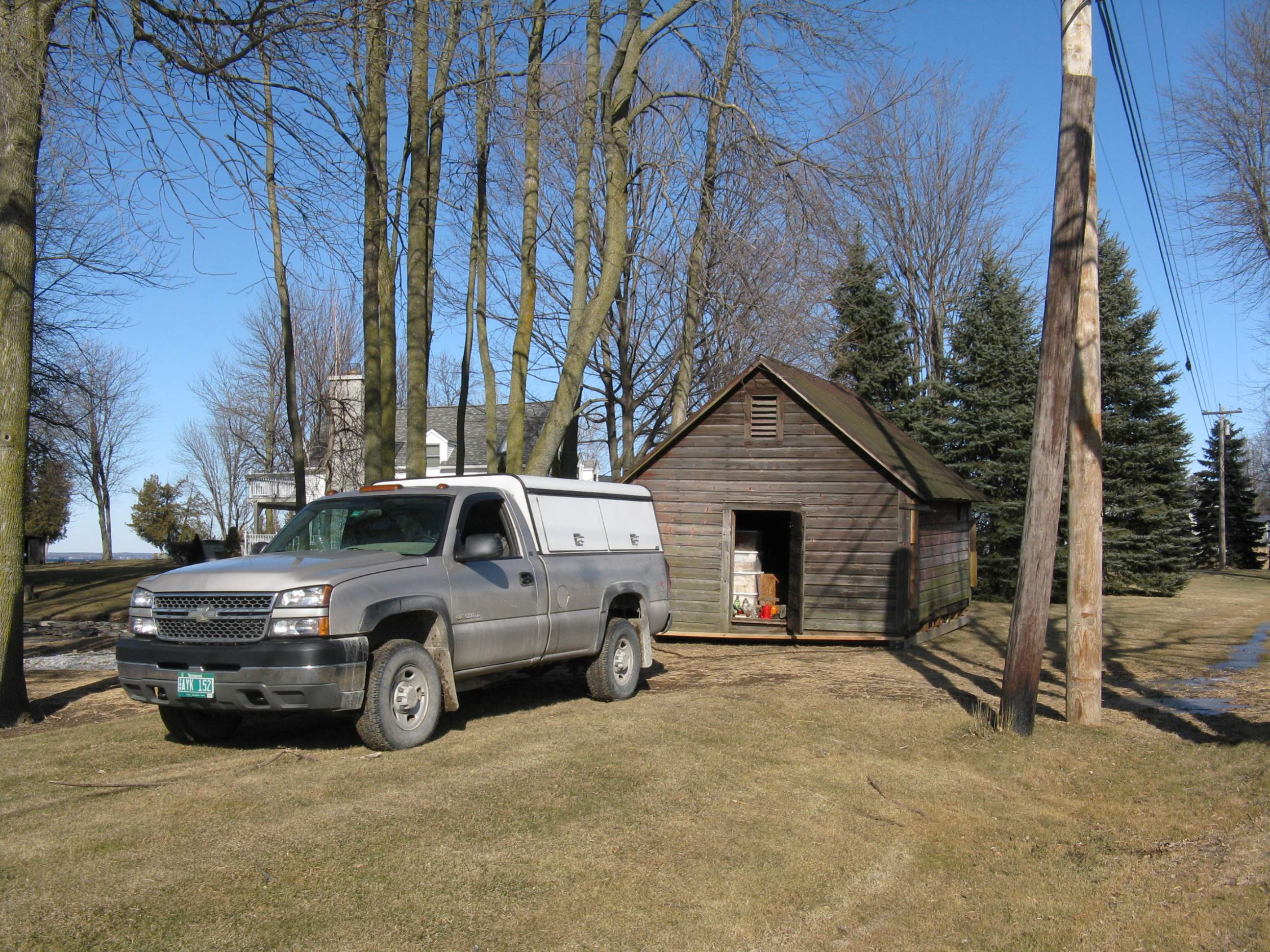

We have a two car garage on our property that is in poor condition. Needs a roof, siding, windows, etc. The structure and garage doors are in good condition. It's at the point where we need to sink a bunch of money into the building so we are finding ourselves at a cross roads. When they built it, the prior owners placed the building in a very poor location. I'd like to move the building to a different location and then build an attached garage. Otherwise we can just tear it down. It seems to make sense to try and move it because if we tear it down, then we have nothing but a pile of nail infested lumber. The location that I'd like to move the building to has a cross slope that would allow for a lower level. I was thinking I'd build the new foundation out of foundation grade treated so I can do it myself on the cheap. The problem is the cross slope that allows the lower level may cause the building to go turtle when we move it. I was thinking of using a hay wagon to move the building with. The problem that I see is that the wagon will be where I want to excavate after the move is done. So after moving it, we will need to support the building on some beams so we can excavate. The garage is 25' long, if I dig a 8' deep basement, then I'm going to assume the angle of repose is also 8'. Figure the cribbing is 4' square and a couple of extra feet to be safe and all of a sudden my needle beams are over 50' long. I don't know what size beam that will be, but they're going to be big! I've been watching craigslist and have seen no heavy beams or anything over 10'. I have a call into a building mover, but I have a hunch I won't be able to afford them. I was wondering if anybody has attempted a project like this and if they had any pointers?

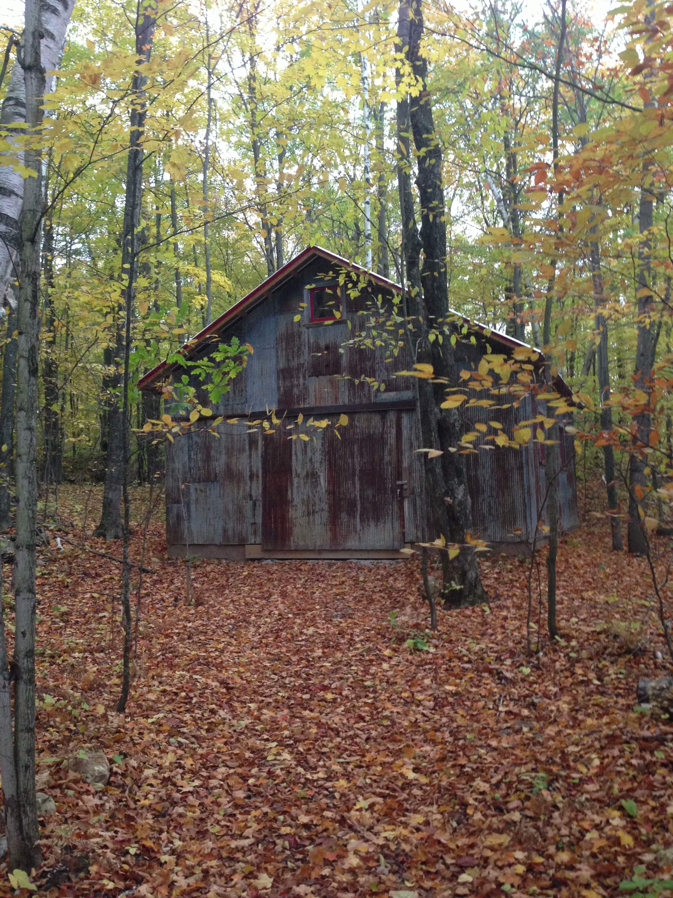

I did a project like this once before and it turned out rather well. That building we were able to take apart into 8 pieces which we stood on a trailer and then hauled it several hundred miles before putting it back together. This building is pictured below.

It looks like from the pictures that is not the type of building that would be easy to move and stay in one piece. It also looks like by the time you cut the trees out of the way and jacked this shed up on whatever you were going to move it on, you could have built a new one instead in less time.
Could you take the building down in pieces? Remove the tin roof and rafters and have the 4 walls taken apart in one piece and stack them on your trailer. Haul to your new site and reconstruct. Looks like a project either way. Good luck.

That's the one I moved a few years ago.

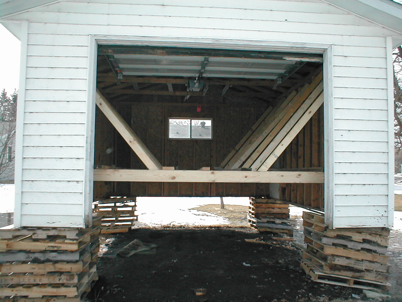

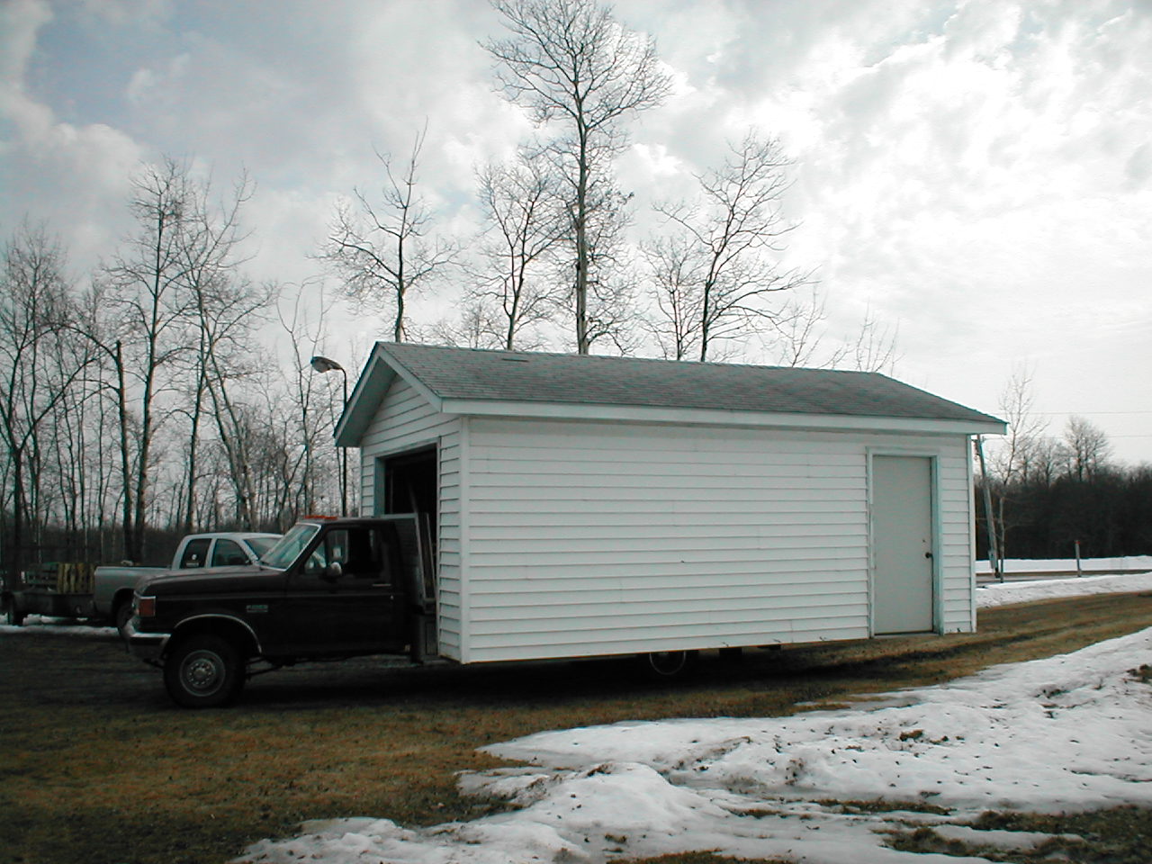

I have moved a couple of them over the years, I only got pictures of the last one we moved and it was only a single car garage but this is how we did it, we moved it 60 miles on the flatbed, the stringers are about 4' apart and we had no issues, also moved a 2 car on a car trailer this same way, used a skid steer with pallet forks to lift it onto the pallets.
