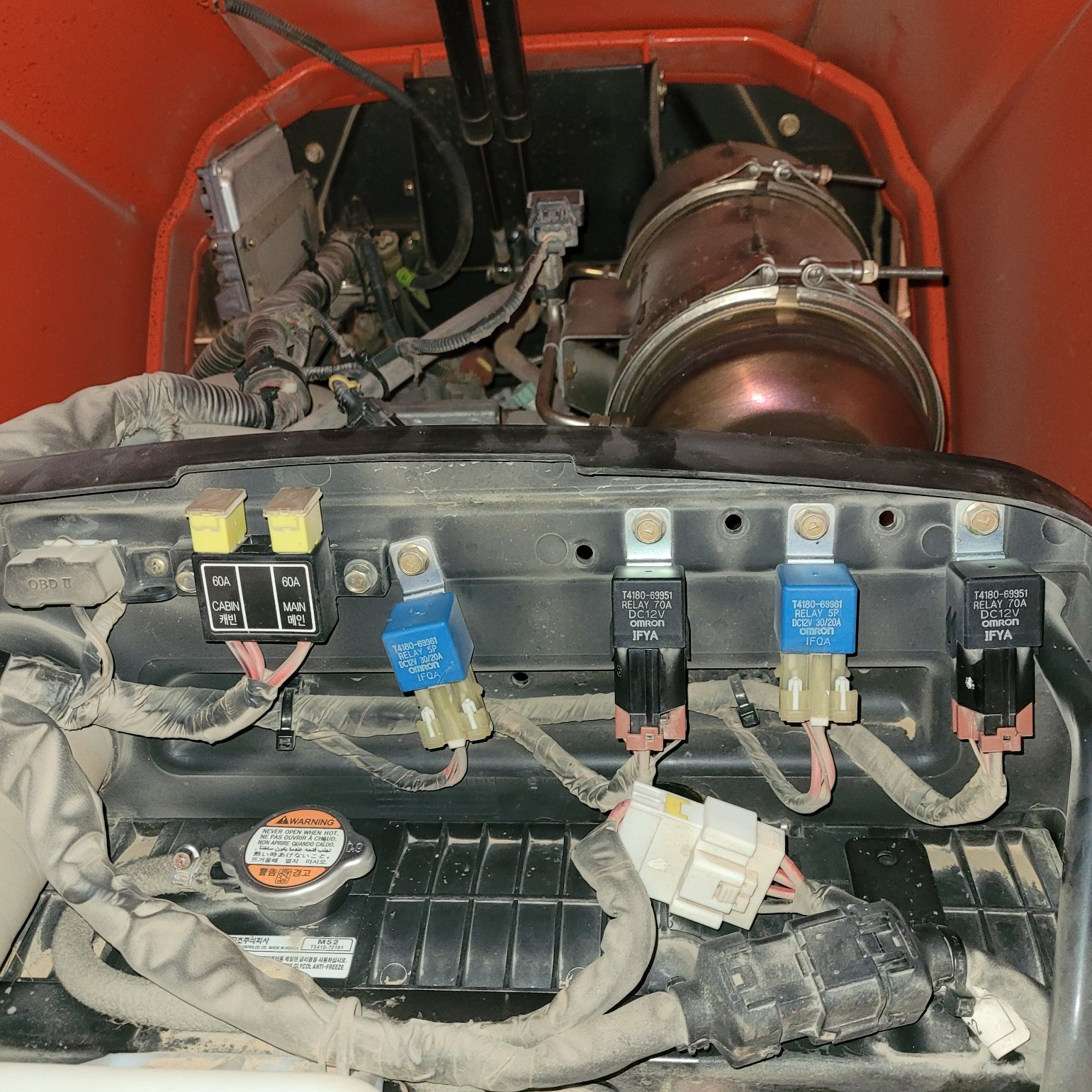

Some more thoughts, for what they're worth. You say you swapped the 70A fuses. Do you mean the two 70A relays on the radiator support. If so, did you also try swapping the two 30/20A relays (blue in my photo)? The blue one, second relay from the right, is my starter relay according to the manual.
Also, you say you haven't checked power and ground sides of the brake switch to look for the potential brake fault mentioned from rubbing wires. (I think a reference to my 2016 post Tip for NX-Series Owners: Mysterious starting problem solved) Actually I don't think even that would rule out the cause I described - chafed wires at one of the brake lights. My brake pedal switch was working fine even with the chafed wire short circuit and blown fuse, because it was turning the brake dash light indicator on and off normally when the pedal was operated! But in your case, you say you've already checked all the fuses and they were fine. (In the fuse box to the left of the seat, between the B and C pillars?). So that pretty much rules out my chafed-wire cause!

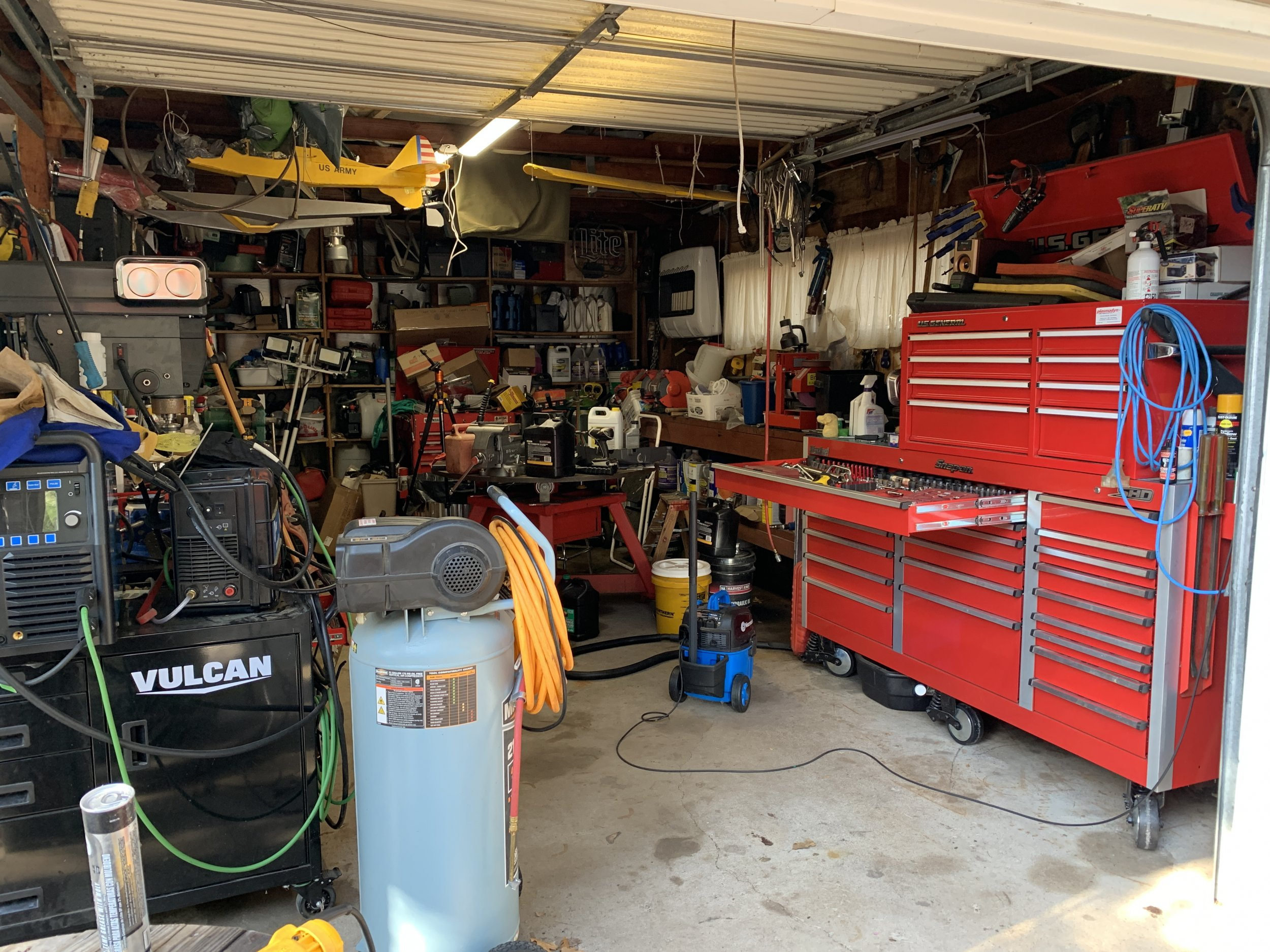

On day three of not winter weather I fixed one of my own quick disconnect fittings for my loader’s third function, as well as fixed the horn and headlights. I didn’t feel like laying down in the grease chunks that I blew off my machine when I hot pressure washed it yesterday so I haven’t addressed the no start unless I key on and jumper the starter.
Looks like the right rear lift cylinder is leaking as is the right boom cylinder as is the flare fitting on the right hand side that runs forward to the hydraulic oil cooler. The flare fitting has leaked since day one and tightening isn’t helping anymore so I’m going to try one of those copper flare mush-washer thingies since the flare connects two OEM hardlines.
The really big deal was a friend and I loved my toolbox off the wall to explore and find what kinds of things fell behind it after six years. With tools stacked up like cannonballs, that thing is stupid heavy.
