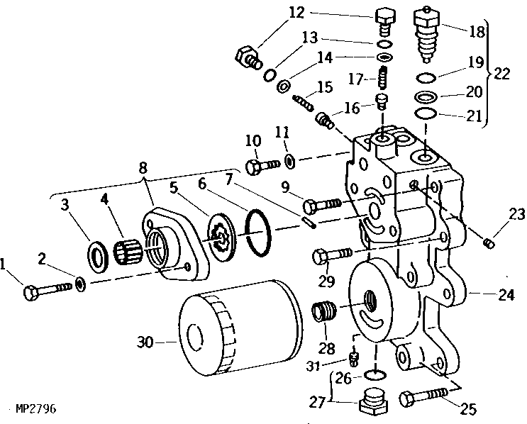

I'd like to be able to roll it into / out of the shop every now and then.
But with the HST must I start it? or is there some way to easily get it "out of gear" ?

If by chance this is the X300 (and not a different 300), then there is a lever/knob on the rear to pull out.
And a link to the manual.
OMM155820-H6
   / Any way to push around a JD300 HST lawn tractor? #6
There's a knob in front of seat that one turns CW to depress the 2 valves(parts key 18) so tractor can be towed/pushed.
