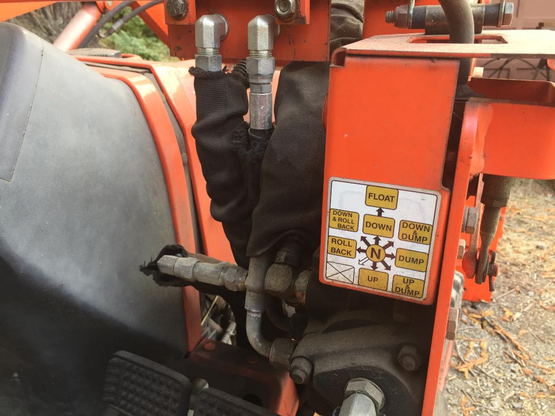

I have a Kubota B21, the loader works very smooth on any combination of motions and can be easily feathered on one or both motions at the same time. It is open center. Same goes for the backhoe. I don't see this as open center vs closed center, I think it has to do with the control valves.

...I think it has to do with the control valves.
Yes. If you take the spool out of your valve, you will see little ramps cut into the lands. This helps with feathering. Some valves are better than others. The FEL valves on my Kioti are fairly easy to feather, but with high loads, the sensitivity is greater. In the OP's case, as in my experience, using forks on the FEL and loading something very heavy, feathering the curl/lift is hard. I end up doing them independently.
As for leak-down of the valves under load, if you can't see movement, then it is a feature, not a bug.
Maybe I need a Kubota loader valve LOL. But seriously, if you can easily see a P/N on that valve, please let me know what it is.
   / Any way to improve FEL hydraulics? #28
Is the valve on yours mounted on the loader bracket or under the fender beside the seat?
#29
It's under the floorboard. The joystick is part of the tractor and has cable linkage down to the valve. I realize a Kubota valve would be setup differently, being mounted on the loader with the joystick coming right out of it, but in hoping there would be a way to make it work.
   / Any way to improve FEL hydraulics? #30
I can't see any numbers on the valve but Messick's has the loader parts diagram (for TL421) and lists several valves. Other Kubota models may also have very good valves, particularly the other industrial TLBs.
