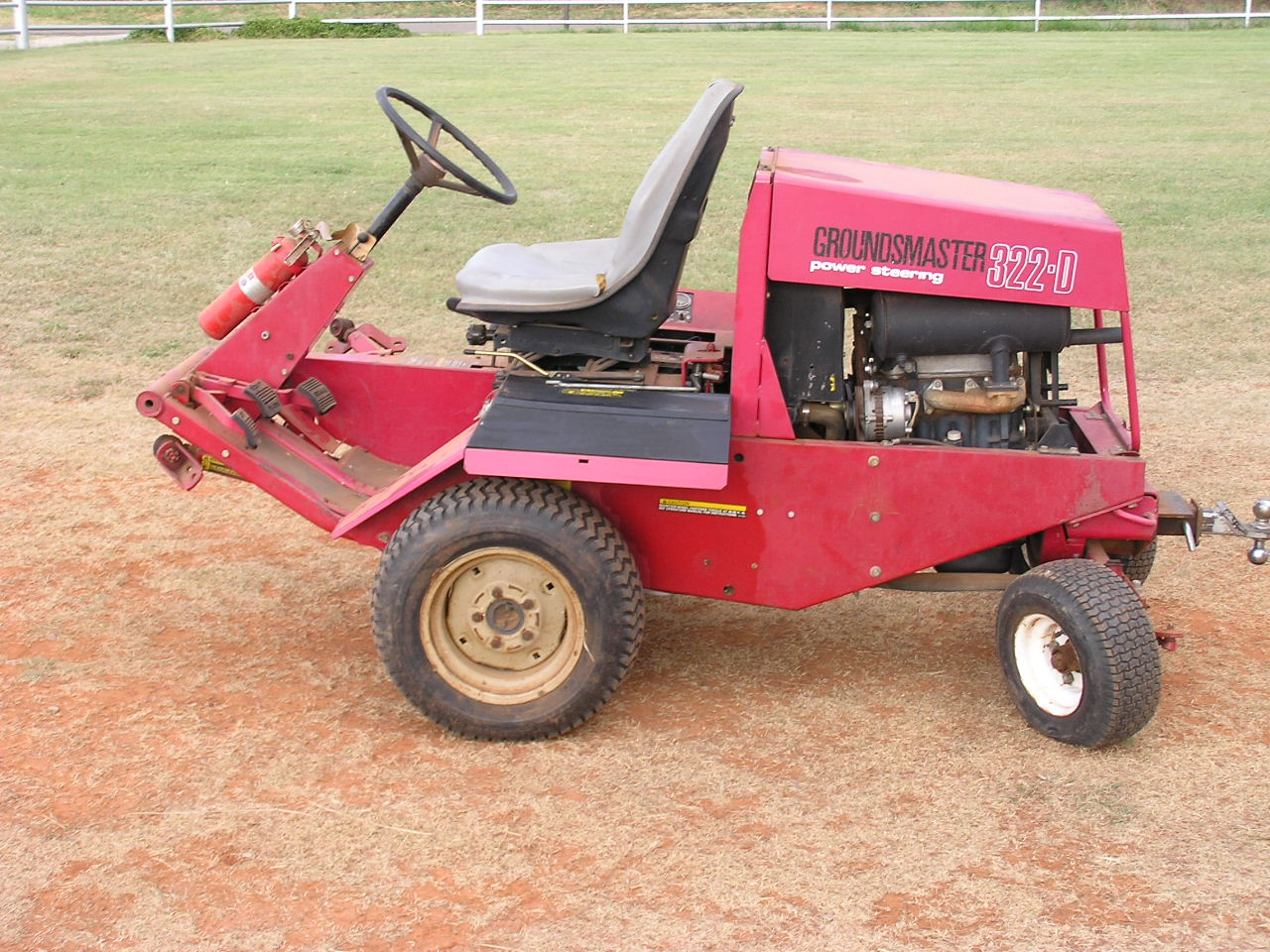

Hi all, anyone have a wiring harness for a 1986 217D? Mine has been overcharging terribly and I tried a new rectifier/regulator that did't help. Must have a ground fault somewhere. Now the wiring started smoking and I need to replace it as it's quite crispy all over :(.

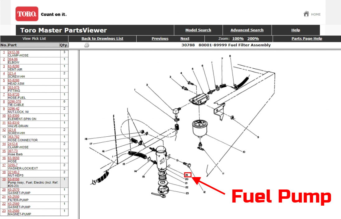

The previous owner messed up the wiring and several of the connectors on our 220D.
I temporarily installed a toggle switch to shut off the lift pump. Otherwise it ran non-stop.
I've resigned myself to the fact, that if I want it right, I'm going to have to take a day and fix one wire at a time until it's right.
Luckily I have a running parts machine to copy the wiring harness. schematic.
They aren't quite the same. One is a 223D the other a 220D.
I never figured out the difference in schematics while looking at both schematics on separate sheets.
They're very similar.
