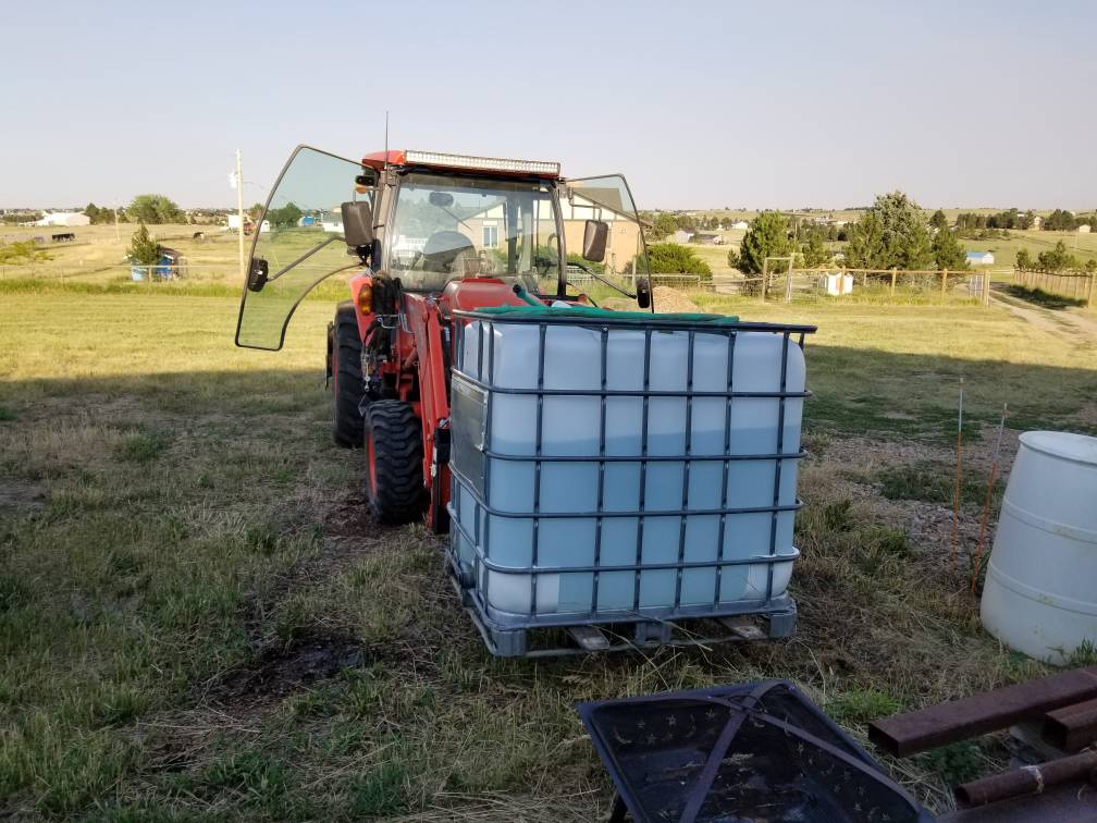

I'm about ready to upgrade my remote watering capacity from 48 gal to an IBC tote at either 275 gal or 330 gal. The routine is that I fill water at my house and drive 4 miles to my property to water vegetables & vineyard. Last year this was a real pain with the small tank I have for my F150 pickup. These IBC tanks will weigh more than 2K lbs when full. I'm open to ideas but I'm thinking either a small trailer for the IBC tank or beefing my rear suspension to handle the extra weight. How do others get their liquid filled IBC totes around?

Hauling totes with water in them can be very dangerous, particularly if the tote is not full. The sloshing of the water moves the center of gravity and the tote would want to move on the trailer. At 2000 lbs it must be secured properly.

I understand where you are coming from. I had a tote in my HD, full it road fine. With less then 3/4, it would move the truck around when stopping.
The trailer I'm thinking of would have 2 to 3 totes. I figure it would be equal to having a ~700 Gallon tank, but with baffles.

/ Any IBC Tote Trailers Out There? #11
This is precisely how much my L4060 with the medium loader will lift. Had to drain maybe 5-10 gallons to be able to get it a couple feet off the ground. Hydraulic and/or loader engineering is the limits here. Stability was fine with moderate to low ballast on the 3pt. Never put it in 4wd or had any traction issues (no hills to deal with though). 20180701_185901.jpeg
