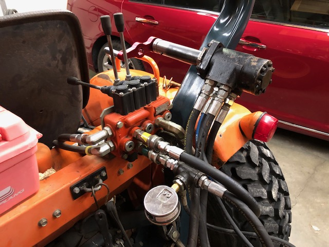

Another approach to the means of actuating the cylinder is a power steering valve as shown in the attached. It is a basic Char Lynn four ports; pressure and return and A and B ports to the cylinder.
This type of valve is used on a large percentage of compact tractors and is connected directly to the steering wheel as I'm sure most of you are aware.
I had purchased and mounted this valve just to the right of the other remote valve bank as seen in the pic and done early testing with it to follow the laser receiver. My reasoning is that the rotary motion of the crank input would have the same feel as a steering wheel and the speed of the cylinder can be controlled by speed of the rotation. (The crank next to the seat works favorably from an ergonomic standpoint.)
I've been using one of the remote valves lately while waiting on a detent kit to make it easier to switch back and forth between the Char Lynn and any of the remotes or 3PH. (No power beyond on the Char Lynn)
So what I'm wondering is if it would make more sense to drive the Char Lynn with a variable speed 12VDC motor and worm drive gear reducer. That is how many of the ag tractors have been set up for GPS auto steer retrofits. The DC motor/gearbox output drives the steering wheel by friction around the circumference. Interestingly enough, the manual method of doing this is a GPS light bar mounted on the tractor hood and the operator watches the light bar and steers manually.
The power steering valve has the advantage of being proportional in that the faster you turn it the faster it "steers". So by varying the output voltage and polarity to the DC drive motor we could modulate the response to the laser receiver output.
The steering motors can be bought new in the $400 price range which isn't bad considering they have a built in subplate for the ports. A solenoid directional valve normally requires a subplate for mounting and plumbing.
So what do you guys think? I had kind of forgotten about using the Char Lynn so sorry about not mentioning it sooner.
