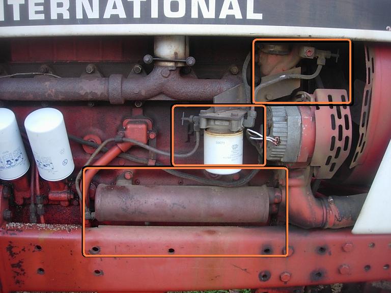

Anyone know what these parts are?
Looks to me like the radiator is connected to what appears to be what I'd call a "muffler". There is a drain on the bottom of this as you can just see between the frame & unit.
Then you have the connection point at the back of it that goes to a "conditioner"???? (what's up with that?)
It's a CarQwest filter number 89071 if that tells anyone anything.
Then as you see, it goes from the filter to the top right.
I'm curious as to what this contraption does.
My brother in law called last night....said someone he talked to said he thought this machine had an oil cooler. He suggested THIS was it and the canister (muffler looking thing) was the heat exchanger. His contention was, it's possible that this is another place where oil/water contamination might be taking place.
As I look at this thing, I don't see any place where oil can enter it UNLESS it is simply an open port at the engine block.
I'm still a bit perplexed as to how this works if it is an oil cooler. I don't understand why there are no connectors on the right side of it. It looks like it simply slides onto those stubs (or perhaps, is part of that assembley to the right and is all one unit)
This person went on to suggest that either this "muffler" part or the oil filter itself has an anode, much like your water heater. The anode is sacraficial and helps keep the internals of the engine from being eaten up.
I've done a google search on this filter part number but don't see anything yet explaining the possiblity of it having any kind of anode.
Anyone know about this?
Edit: by "connectors" on the right side of the part, what I mean to say is something akin to a hoseclamp. Meaning, it looks to me like it simply slips together and there's nothing there to tighten the two together.
