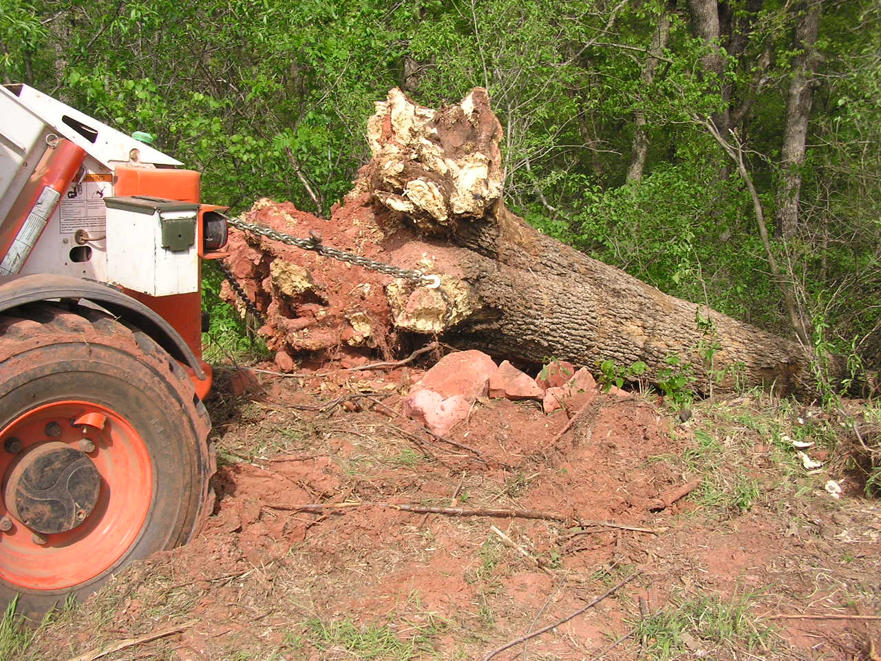

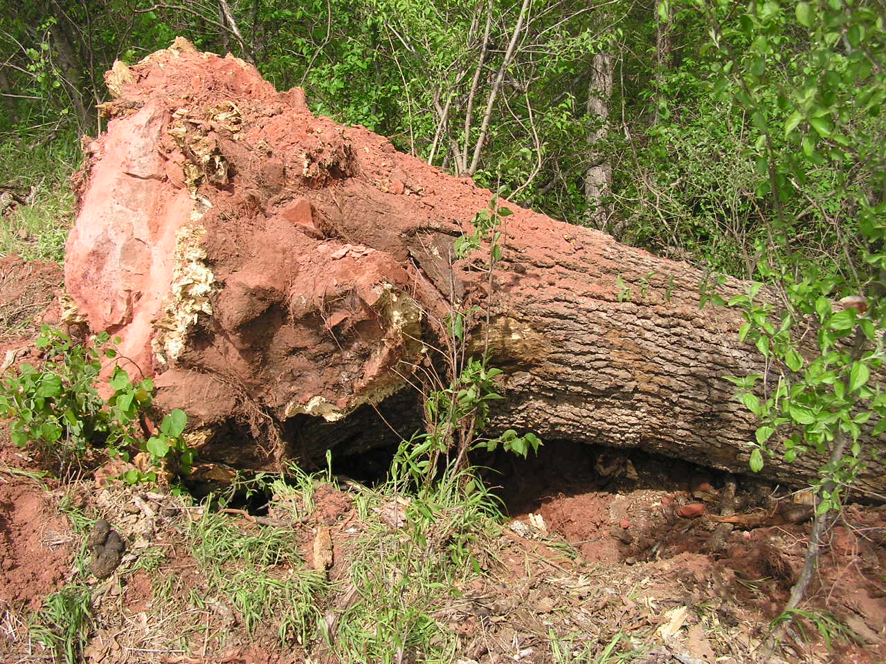

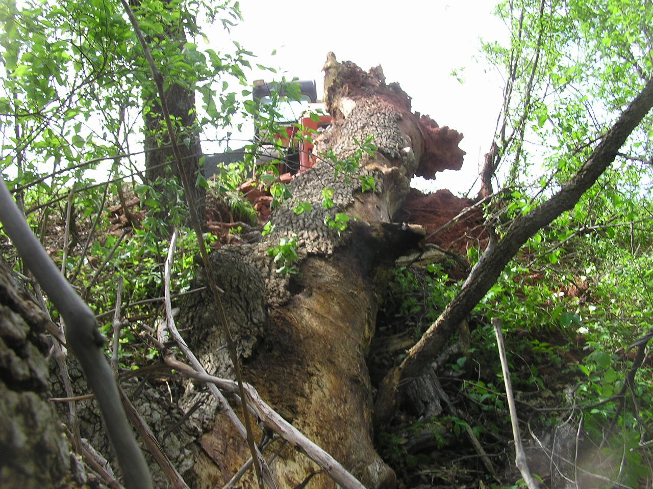

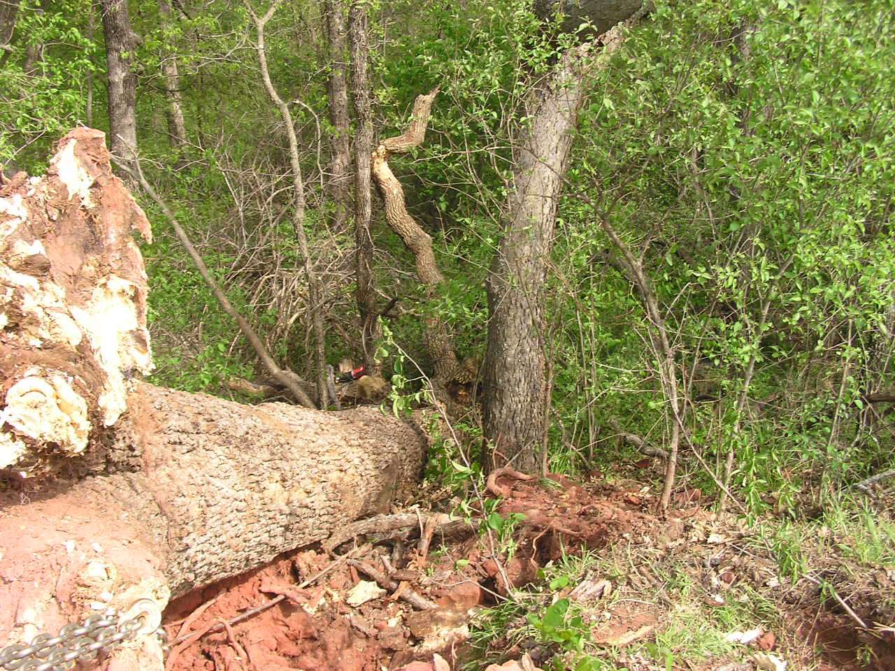

I noticed smoke coming from a dead tree south of the driveway, 150' away.
Called the volunteer fire dept. to put it out, so that I could push it over, down the hill.
The Fire Chief said the radiant heat above the fire is what started this one burning.
There were two dead limbs on other trees close by that were burning also.
Had to cut off some branches that were caught on other trees, so that the Versahandler could pull it out.
Picked it up and took it across the driveway, it will be the start of the next burn pile. :D
