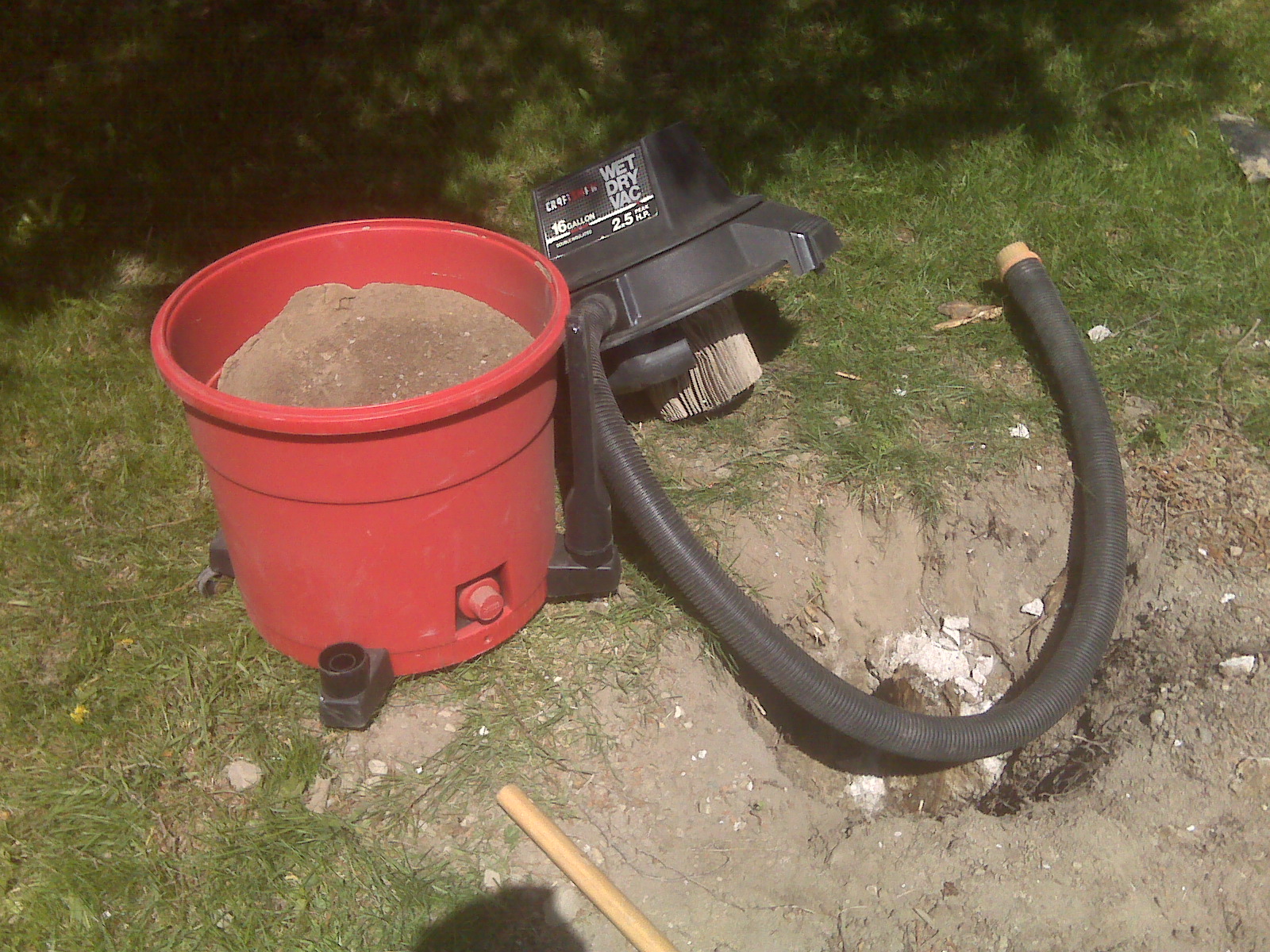

Had a broken corner post for the fence around my garden that needed to be removed, and it was set in concrete. Rather than dig all the way around it using a PHD to the 3 foot depth, I did the first foot that way, then kept loosening the remaining 2 feet deep soil around it with a long prybar, and used my oldest shop vacuum to suck out the loosened soil. Don't laugh, but this method saved a lot of digging, and the replacement post and concrete went into a hole that wasn't way oversized. In the past, I have used this method to remove loose material from postholes the PHD wasn't able to grip.

Works for me too...
My grandmother shared a common fence with a neighbor and the posts were starting to go after 40+ years...
I agreed to work with the neighbor to get it done... a few days ahead of time, I brought in the posts for Saturday's project.
Saturday morning I arrived and the neighbor had set two of them... took him a day to do each one as he removed all of the concrete that had wire in it...
I told him I was planning on pulling the posts and using my shop vac to clean the holes and this is why I didn't buy and sack concrete.
Did all the rest in 4 hours and the posts have not moved... he said I was pretty smart for a kid...
