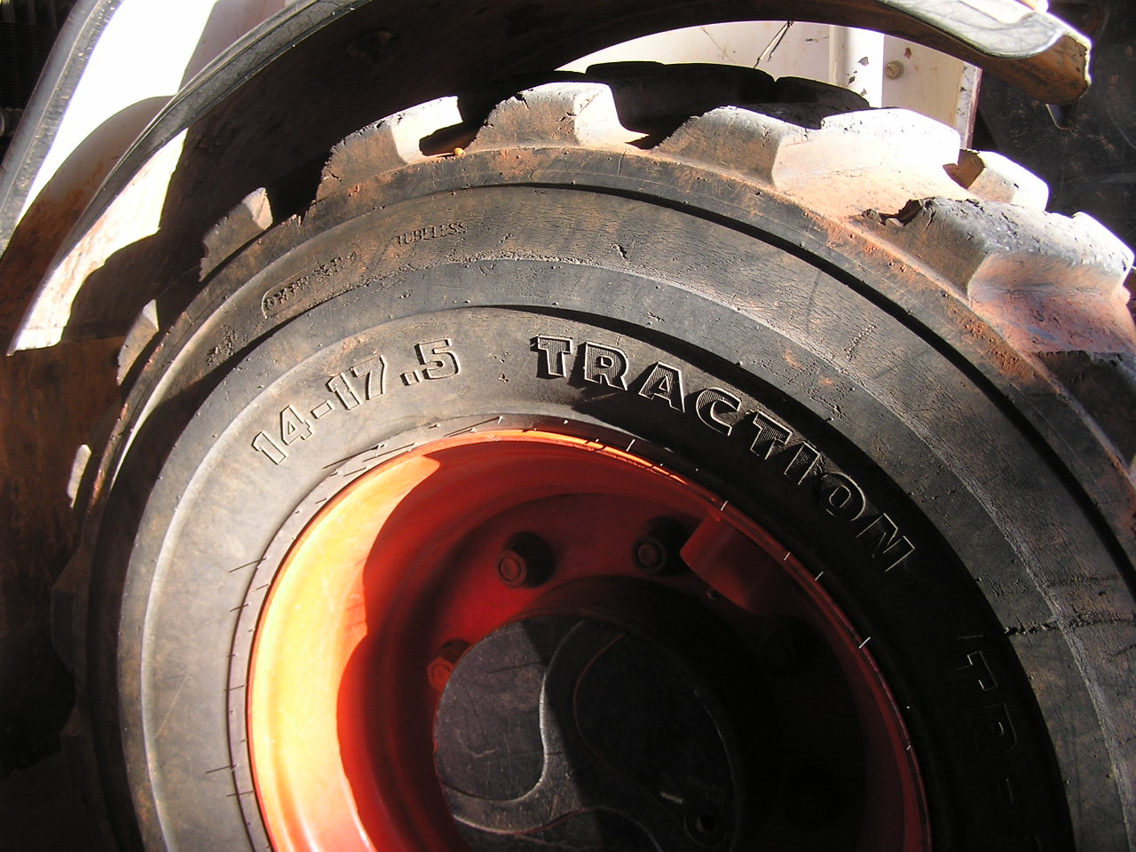

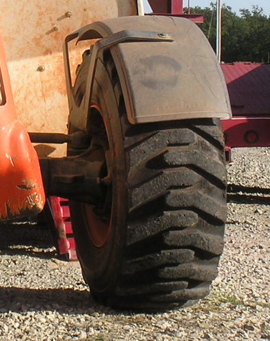

I had to use a chain and a 10" long piece of all thread for this 14 ply tire on the Versahandler:

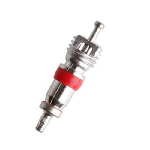

Just so there is no confusion for the inexperienced, only remove the core from the valve stem:
If you don't have the tool, get a core removal cap:
