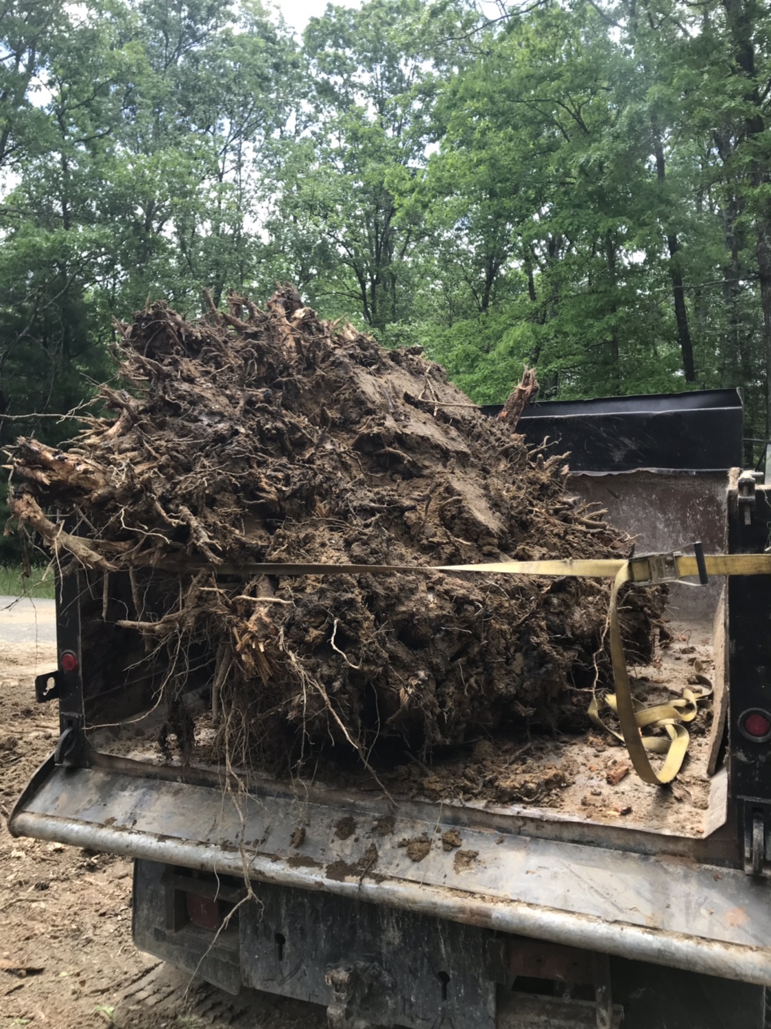

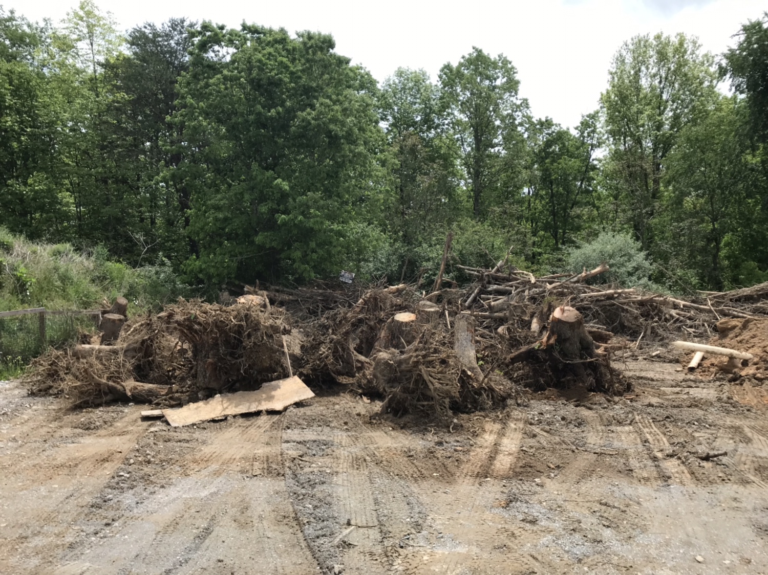

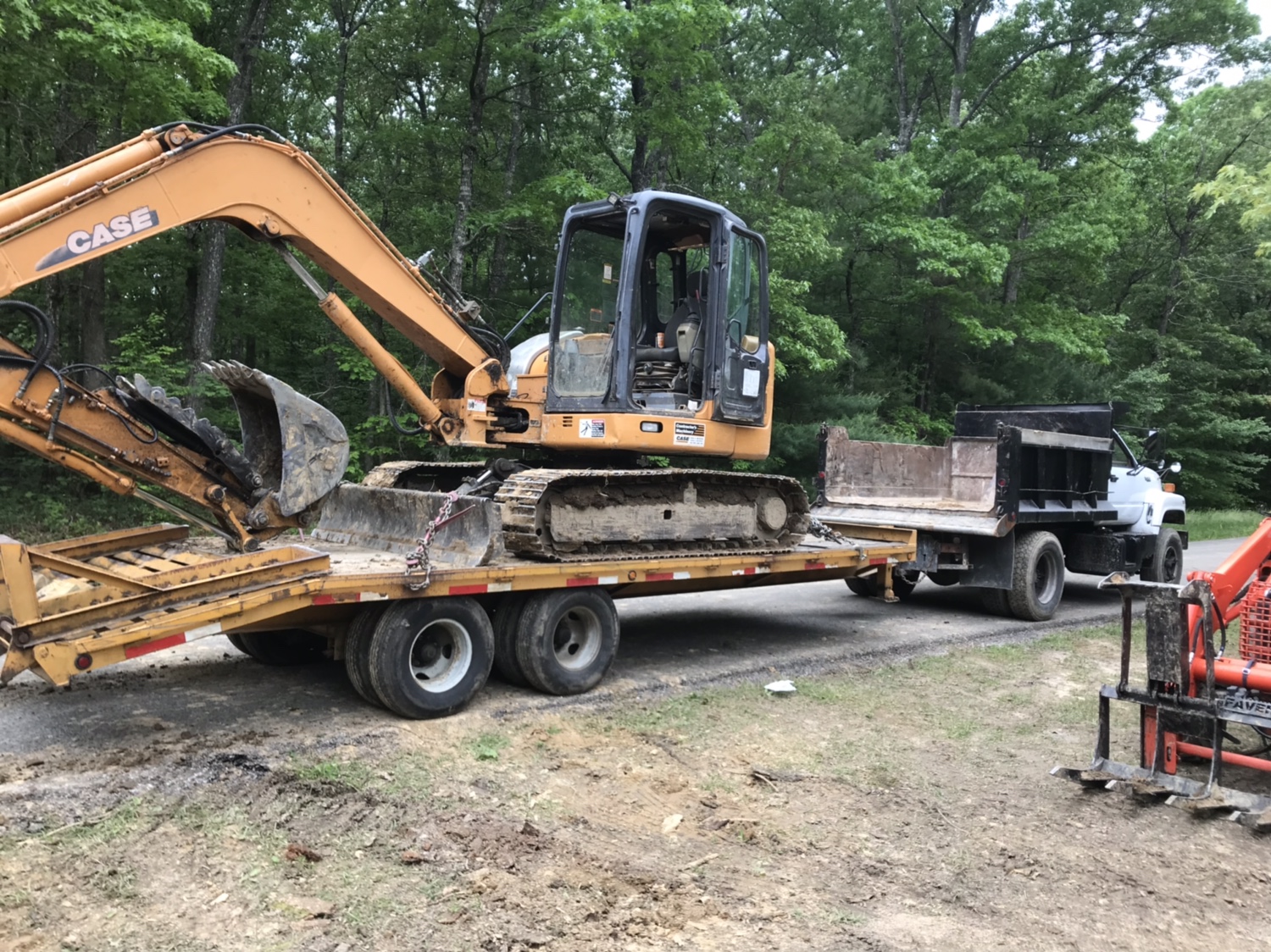

A 35 series Deere mini is weaker than my M59 and I wouldn’t undertake that job with it. I just got done digging about an acre of oak stumps. There was probably a dozen in the 18-24” range but most were 12”. I dug all of them with an 18,500 pound excavator. It took me about a day to dig, load, and half way level up an acre of stumps with the 80 series excavator. Using a smaller excavator and digging twice as much I really doubt you’ll get done in 2 days. It had the muscle to dig them pretty good but it wasn’t strong enough to lift some of the biggest ones on the truck and I had to help it with the M59. IMG_8752.JPGIMG_8753.JPGIMG_8754.JPG

Those stumps are a whole lot bigger underground than I would have ever thought!
Thanks for the info guys! Looks like I may have to take a couple days off and work on this for 3-4 days...
