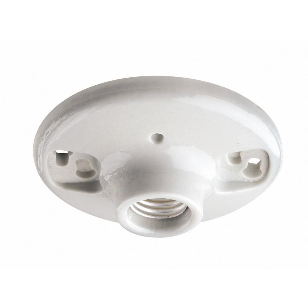

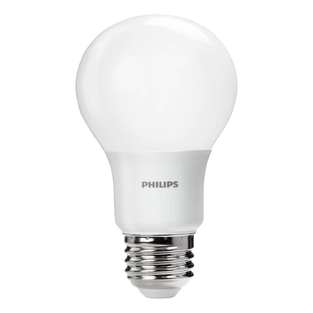

I've seen a number of shop lighting threads on here, but I have yet to see anyone recommend good old fashion light sockets with LED bulbs.
Some quick math:
One 60 watt equivalent LED bulb draws 8 watts and produces 800 Lumens.
The cost for a 60 watt bulb, a box, and a light socket will run around $5
All of this comes out to 160 Lumens per dollar

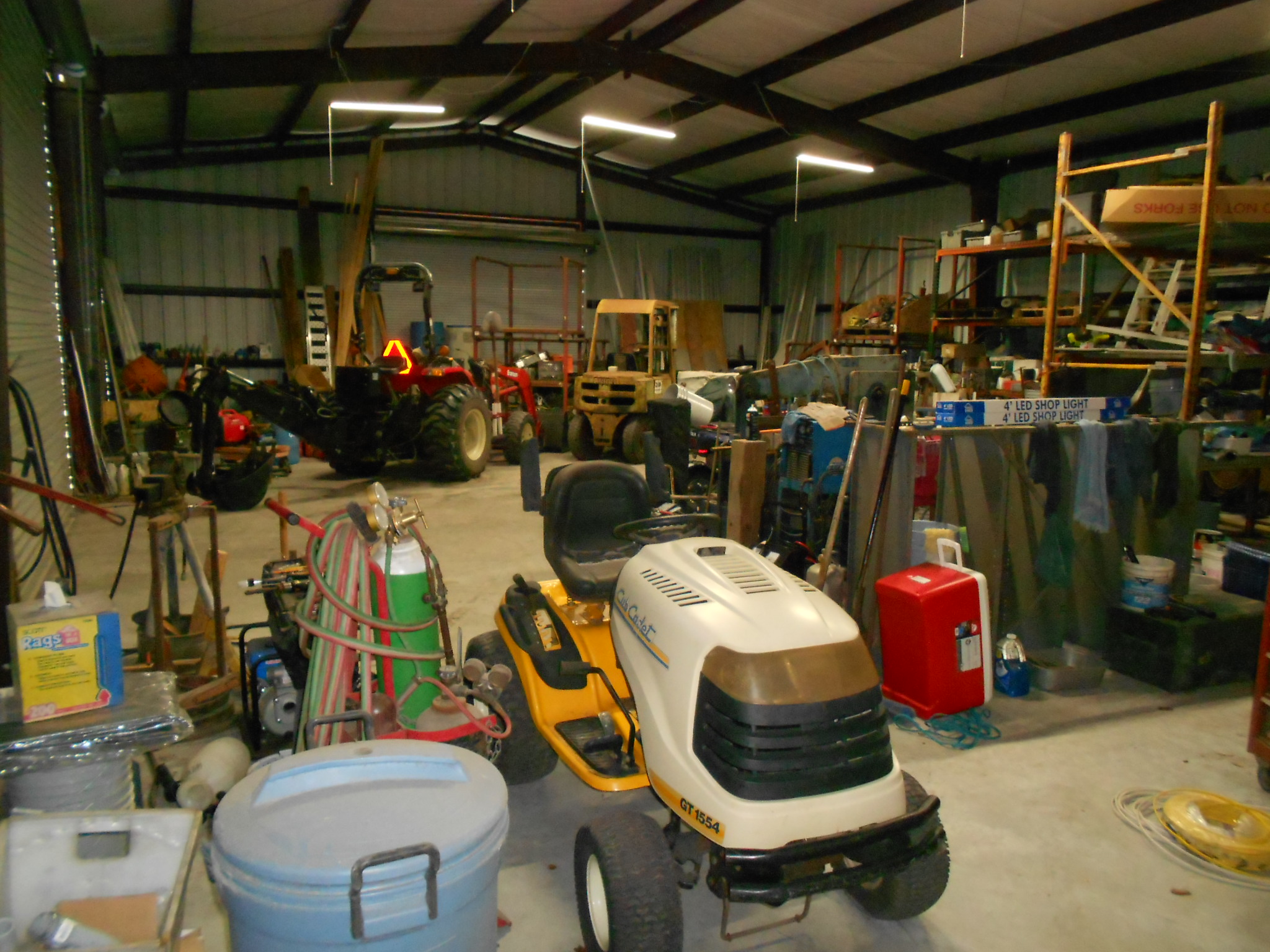

I bought 5000 lumen/42 watt 4' fixtures from Rural King for $24.99. (they ship also)
They come with 5' cord, pull chain and female socket so you can daisy chain them!
I have 6 0f them in my 40' X 60' building and have plenty of light!
I should get out there at night and organize! When I moved a year and a half ago I just kept moving and unloading.

Looks like my shed and SWMBO is always telling me to tidy it up (although I know where everything is, the male filing system).

That looks really good and bright. I'm leaning towards these RK lights for my 23x30 barn. The ceiling is only 9 feet so I wonder if I could get by with 4? Perhaps a row of 3 along the rear wall with the workbenches and 2 for the front with a switch for both banks.
I gotta ask about the light blue trash can. I had one just like it and the only reason I think they have the locking lid is because that thing would tip over if a bird flew by LOL
