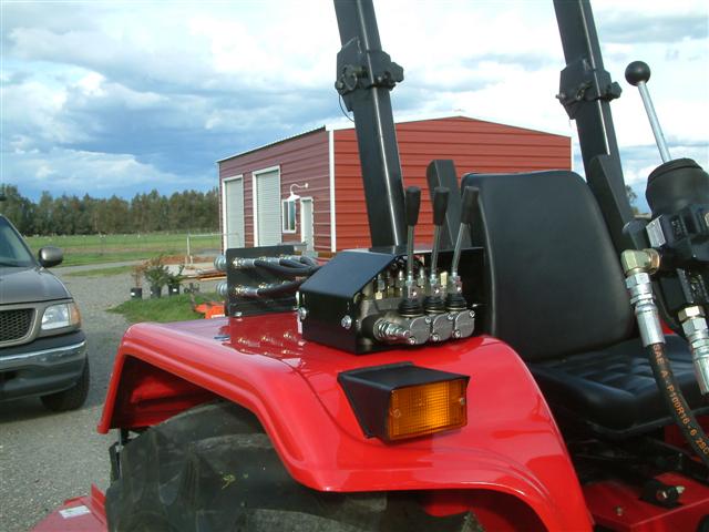

I have triple remotes on my 2008 Mahindra 5525
Quad valve assemblies are available. My triple cluster is connected to the Power Beyond port on the FEL valve assembly. The return line is teed into the low pressure hydraulic line that goes to the sump.
