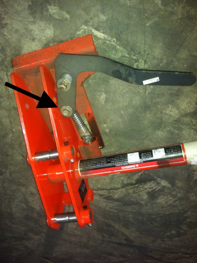

I got the quick attach all fabbed up. Just put a coat of primer on it. I haven't welded the plate to the bucket yet, but that should go quickly.
This project had some challenges that some of you won't face because of my narrowly spaced fel arms. If I hadn't had to cut out the 3x3s to allow for the movement of the handles and pins, it would have been a snap. I really recommend the method of cutting off the ears from the bucket rather than the extra work of torching the the welds off.

In the following 2 pictures, you can see the angle iron I added to add strength to make up for the cut out of the 3x3. I drilled a hole to provide access to remove the bolt on the pin.

I degreased the orange ears, then sanded them to remove loose paint and rough up the orange paint.
