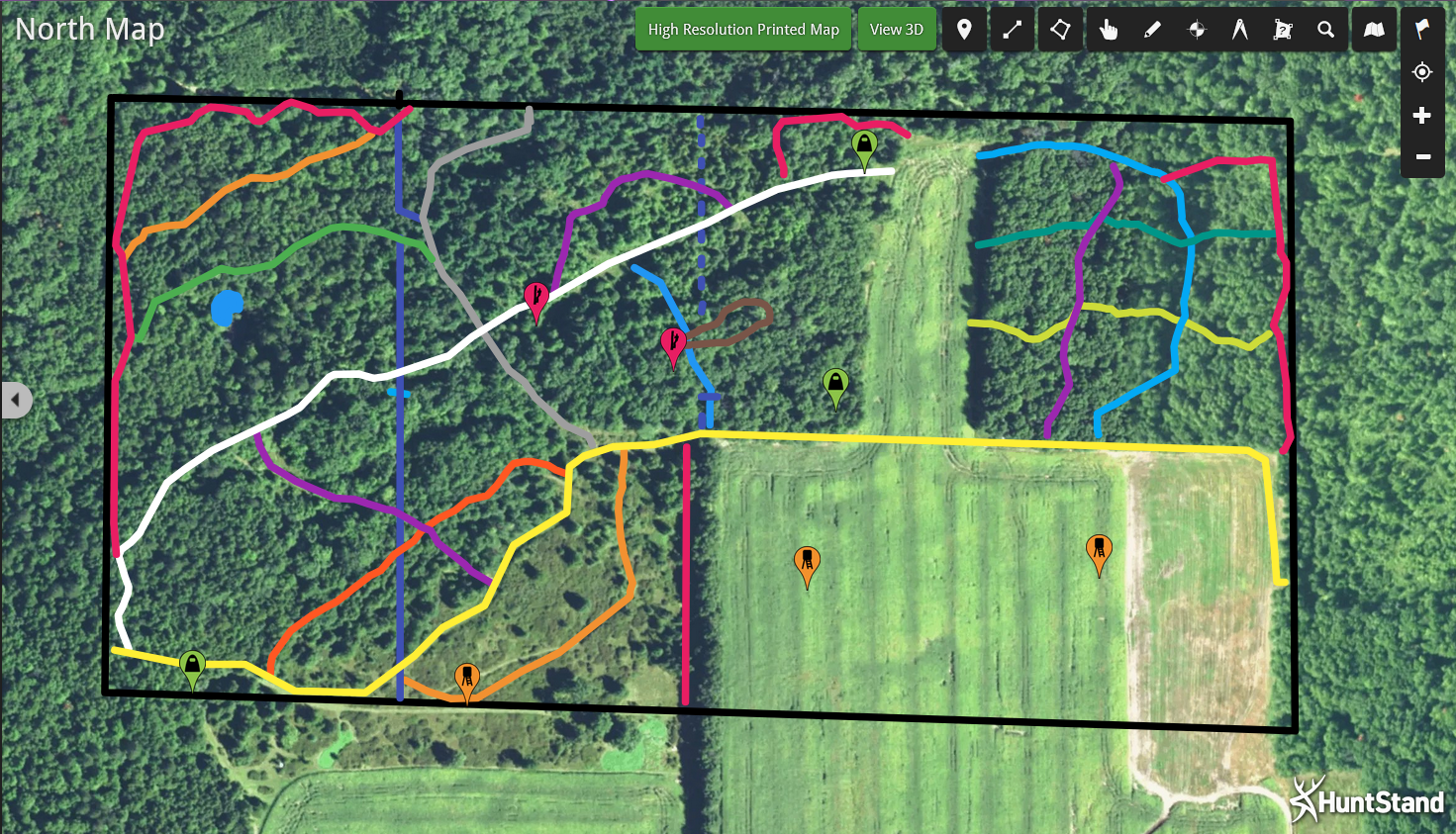

I use flagging tape and the Huntstand app for mapping our 80 acre hunting property trails.
That looks really good! For the trails, can you see them without the lines in place? Or do they look like it's completely tree covered? I did take a look at the satellite images and can see some of the old logging trails from the overhead view. There's some over in the area I'd be clearing and could possibly plug into what looks like two old routes. It would be more of a V than a straight path which is fine. However, based on some of the other obscure probable lines, there could potentially be a lot more paths that are covered by overhead trees.
