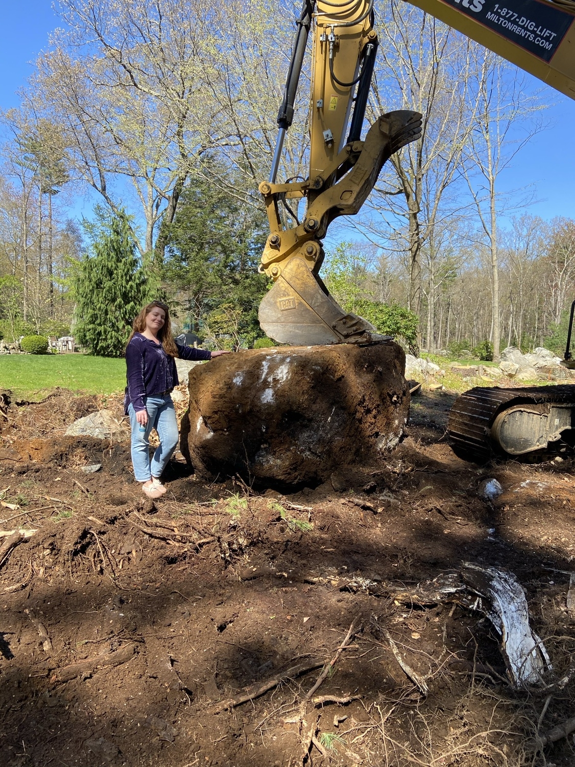

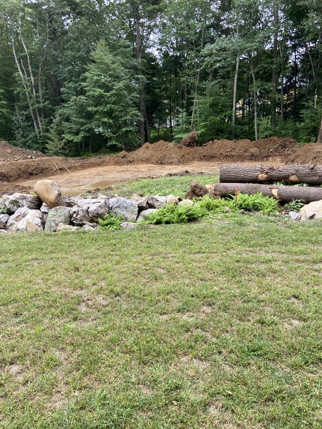

Paul respectfully they aren’t good up here - this is the typical field
I would guess the image with the smaller boulders is what I'd be encountering. There certainly are those bigger ones up there and that's where there'd be a curve.

Reading between the lines for cash flow, you want to finance the equipment for the project vs cash or financing a decent used machine.
I cannot comment on the Kioti $37K vs TYM $53K for 7 Years but IMO either rent a machine for a week, or buy a used machine and start the project.
I know the ground and rocks here - you will beat up a new machine in a few weeks in the woods - whereas an older experienced TLB like a CAT 416, JD 310, Case 580 can be had for $15-25K, The benefit, tough and heavy - a closed cab - can stay out in the weather, has heat and or A/C, can take a beating in the woods and rocks and get a lot more done for your $.
Then sell it for close to what you paid when you are done and buy the new smaller machine.
Best idea yet.
Yep. Looking back over 20 years of similar threads, That's what the more experienced people here always recommend: Either contract the job out, or go get a machine for the task. Either works better than buying a compact homeowner type tractor, adding attachments, and expecting it to do commercial work.
Then when the heavy work is done and the project roughed in enough to be usable, is when to go get your homeowner "chore" type tractor and enjoy working to improve, maintain, and landscape what was built.
