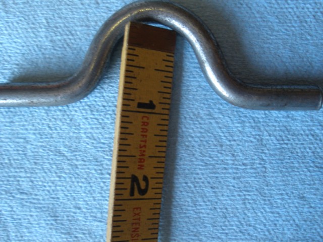

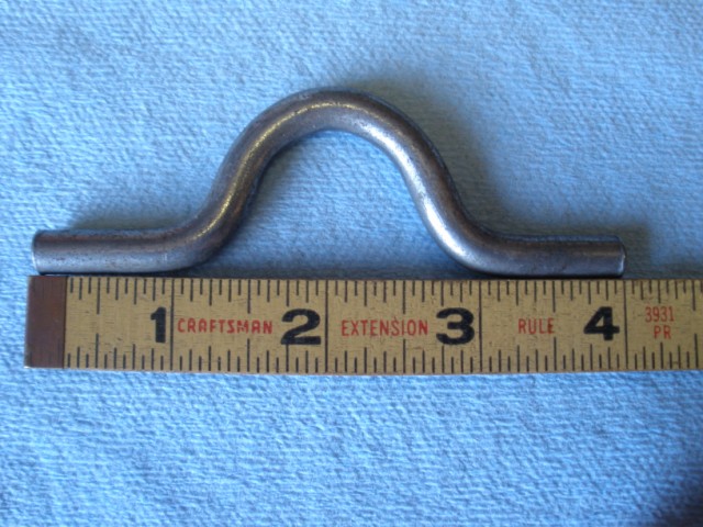

Ok, so I showed you the magnetic outside clamps. Now here is another little gem that I use.
We have a local hardware store (well that hardly describes what Hooten's really is) that carries just about everything you would ever want when it comes to Hardware. They started out as Hooten's Pipe and Steel but have evolved into this great place to get any hardware device, steel pipe, plate steel, cattle feeders, horse shelters, hay rakes, bush hogs, well I think you get the picture.
As I said in other posts, we have tons of pipe fencing here in East Texas. So to attach the fencing wire to these posts Hootens developed the little clips you see in the attached pictures.
They have these in 5/16 and 1/4 inch diameters. The 5/16 cose 44 cents a piece and the 1/4 inch ones cost 22 cents each. I usually buy them 50 or 100 at a time.
They work great for attaching wire to posts, but I also use these things for all sorts of other applications. When I need to create a hanger for winding cords such as my chop saw, I weld a couple of these on to the chop saw cart and walla instant cord hangers. When I have to create a clamping bolt that will clamp to a piece of pipe, I weld on of these on so the end of the bolt has a handle. What I mean is the curved part gets welded to the bolt head and now it's the twist handle.
If I need a hanger for a saw blade or for a bunch of cut off discs for my 4 1/4 inch grinder, I cut one in half and weld the curved end to the bench, etc and we have an instant hanger.
I think you get the picture of how handy these little deivces are. With a hydraulic press it would be nothing for you guys to punch a bunch of these out to suit you needs. I get them locally so I have no need.
I hope you find this interesting and helpful. If you would like more pictures of this in their application let me know.
