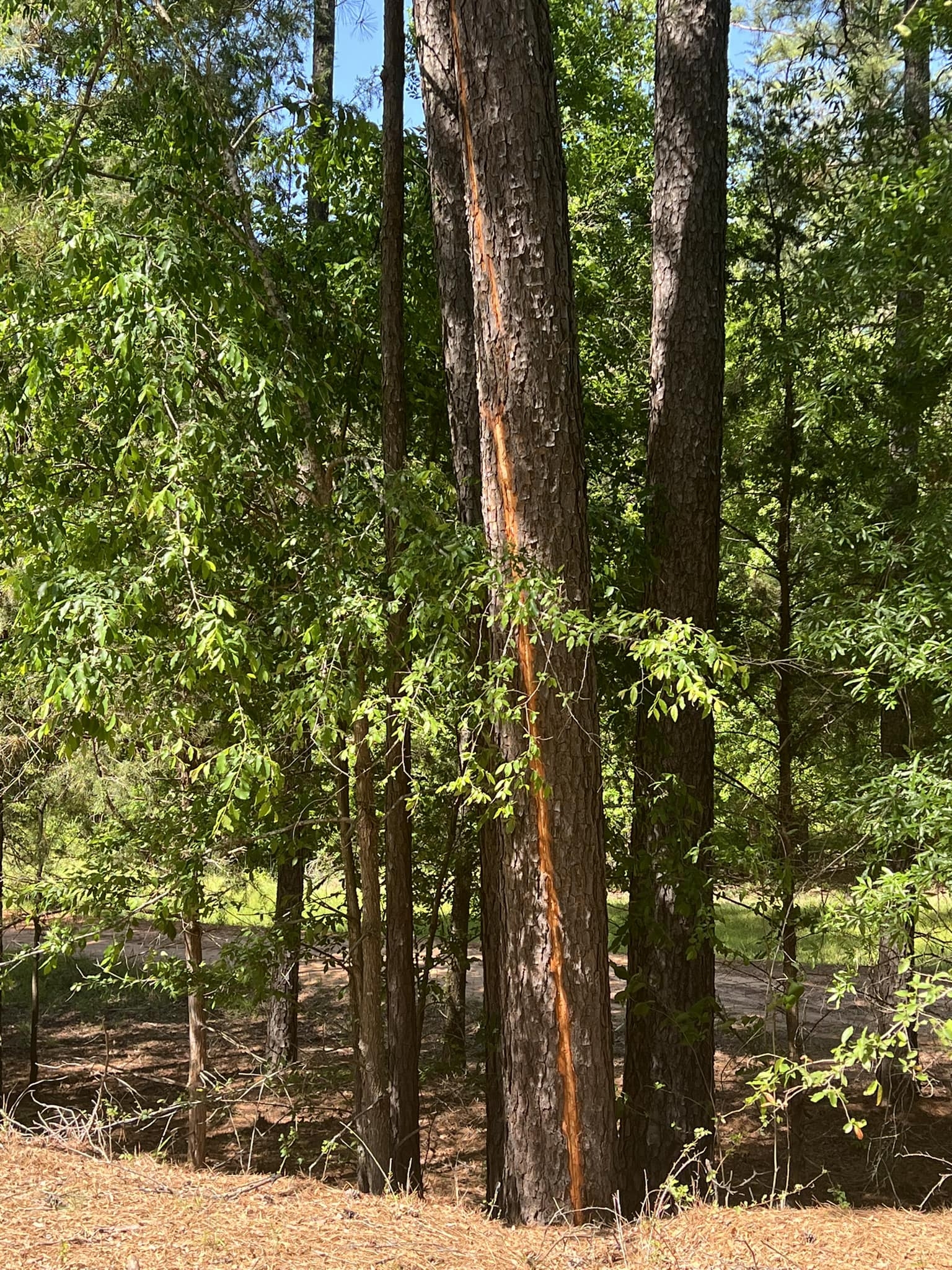

I've worked on a few houses that got hit by lightning. Most of the time, the rafters are solid black were the lightning burned them, but no other damage. The worse damage to a house that I've seen had the lightning hit a big pine tree at the edge of the yard. It went down the tree, ripping off the bark, into the wet ground and to a metal natural gas pipe. It traveled up the pipe to a ground wire that was attached to the pipe and then melted the breakers in the breaker box. And everything that was plugged in at the time was fried!!!! The entire house had to be rewired, and everything electrical in the house has to be replaced. Insurance covered a lot of it, but not enough.
Since you are up on a hill, would that make you more likely to get hit by lightning? I don't know how it works, but I've always been told that the worse place to be during a storm is on a hill.
Would a lightning rod help? I've thought about buying one. I've had trees hit on my land and about a month ago, a power pole was hit out along the road that killed the power for 34 homes in my area, including my place. We heard it hit, and the house shook, but I never found the pole that was damaged. It sure felt like it was close, but I went at least a mile down every road and never saw anything.
This tree was on the other side of my barn, just a few hundred yards away. It shook the house really good when it hit!!!!! Since this is where I was building my goat fence, I took out the tree, along with everything around it. At the time I took it out, it was still alive, but I doubt it would have survived.
