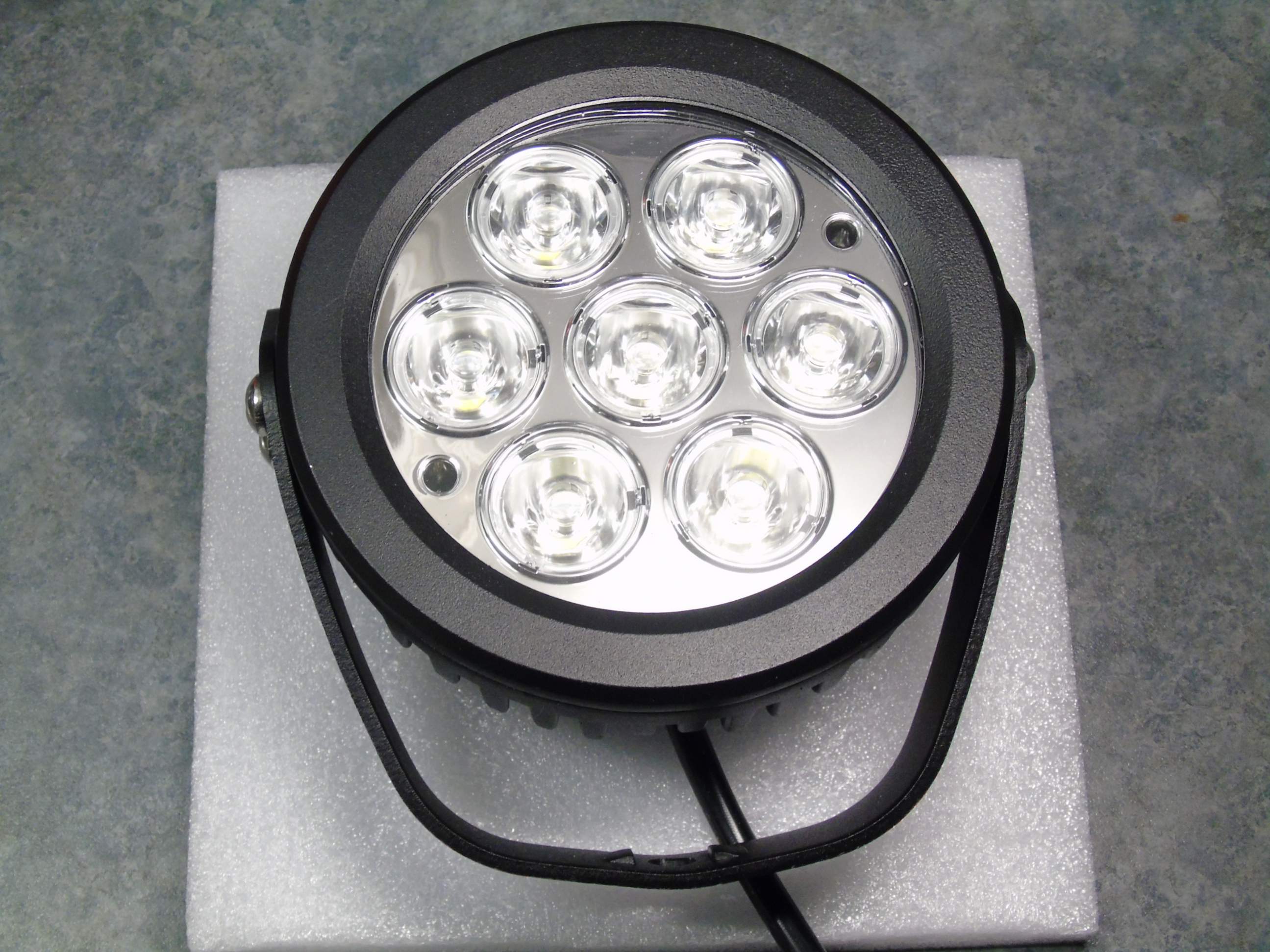

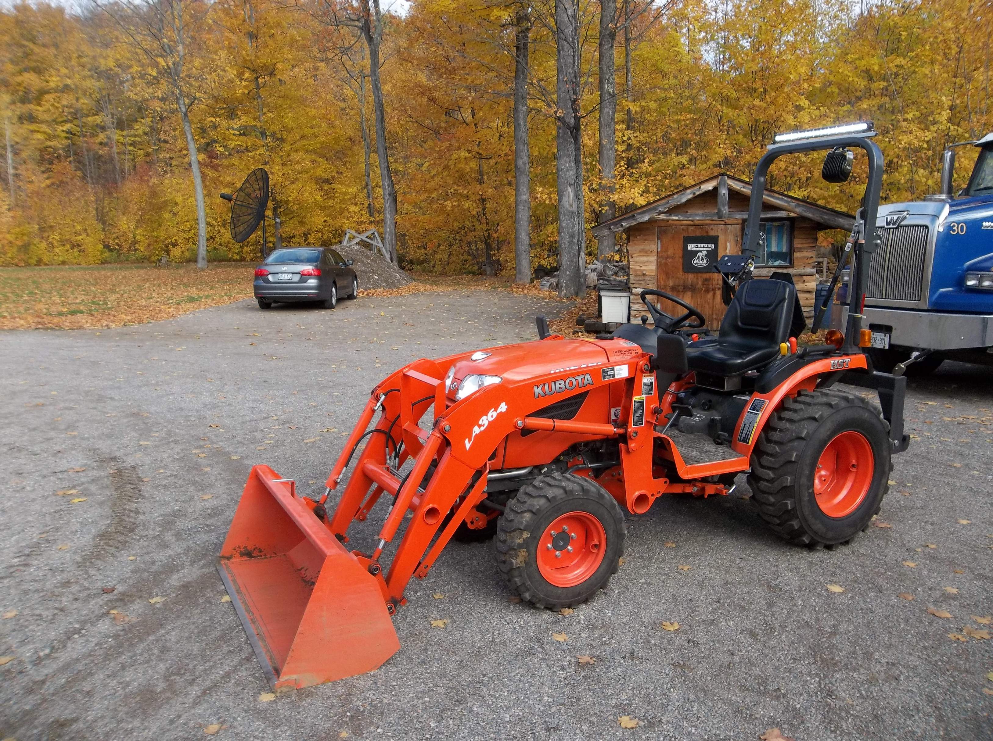

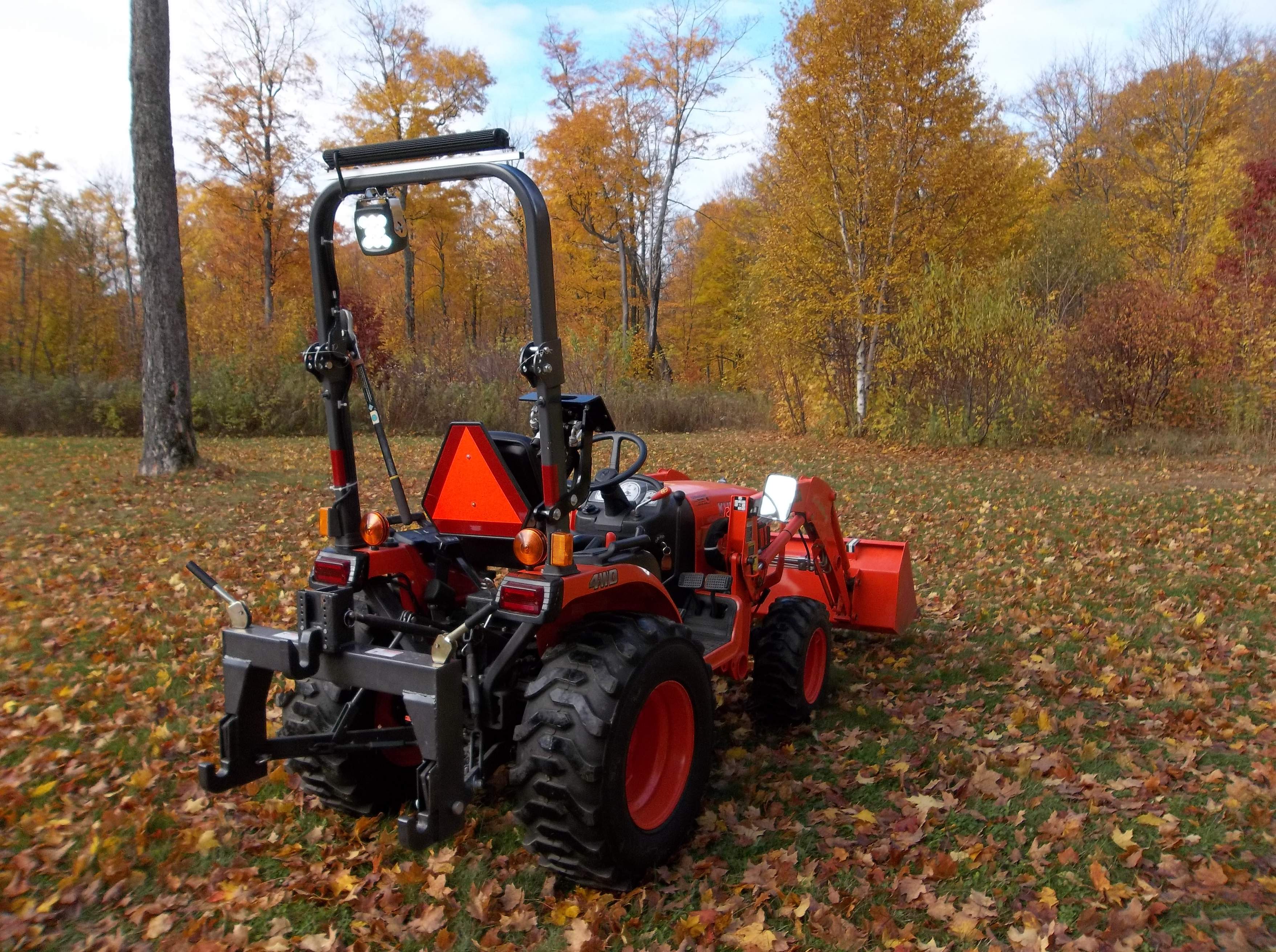

Well I just had an interesting time. I put the one 80W LED square flood facing backwards on it's own switch, worked fine.
It and the two forward facing 70W spot's are replacing the 35W halogen work lights my Kubota dealer installed. All I did was cut the wires at the ROPS bar.
Anyway, bolted the two forward facing ones on. One works and the other blew the 20A fuse. Didn't have any more 20's so put a 30A. Blew it. So disconnected them and tried just that one light. Blew fuse. OK...bad light.
I tried 3 more, all blew the fuse.
Tested them all with an electrical engineer friend's meter. Checked voltage, current draw, start up draw, continuity, grounds. All good. All lights including the one that works measured out at 3.6 to 3.7 amp draw each.
Keep in mind I only have one red positive feed and one black ground. Hooked same feed to one light at a time individually. Lights are all on the same ROPS bar.
Took them off and the one that works, works on both sides. Other 4 blow the fuse. We have no explanation at all as they all measure out the same.
So I got a 180W 21 inch light bar, put it on and it works perfect, LOL. Very strange.

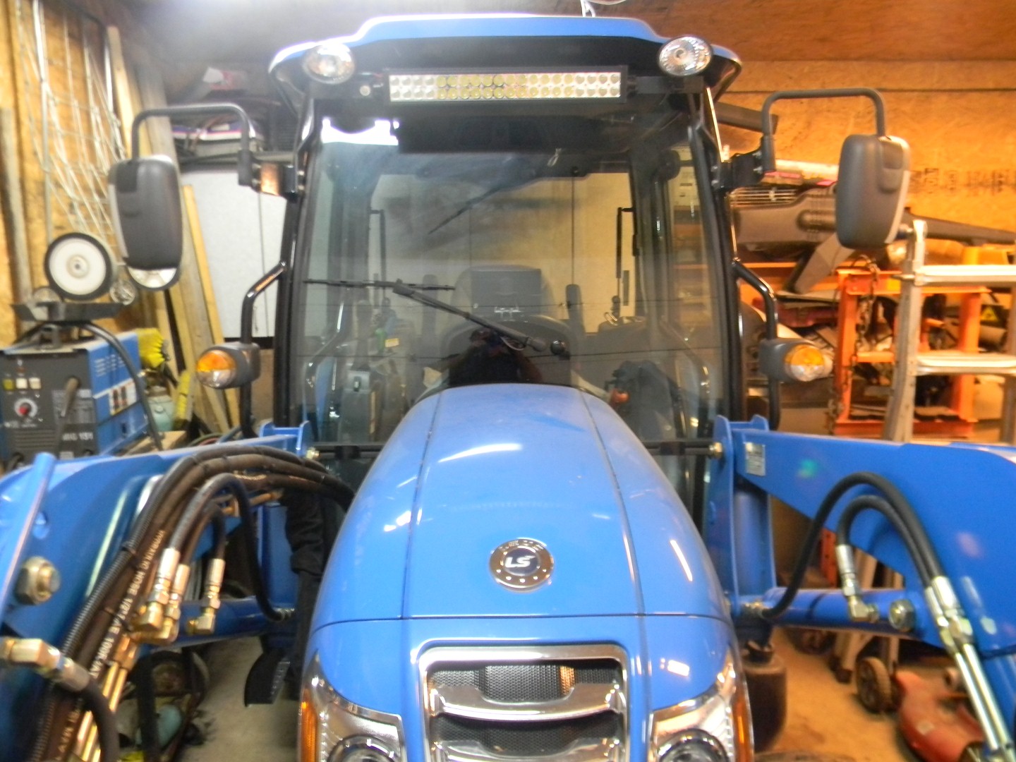

I recently bought a 120W 22" LED light bar. Took it out of the box and tested it on a battery. Red to + and black to -. The light lit up fine so I mounted it on the tractor and wired it up to a 20A fused switch. Turned on the switch and immediately blew the fuse. Changed it out and tried again, blew second fuse.
Removed the light and tested with an ohm meter. I found the red wire was a dead short to the metal frame of the light which is why the fuse blew on the tractor. Before sending it back I took the light apart to check it. The 22" long circuit board was mounted to the light frame with 5 screws. Apparently during manufacture when they drilled the mounting screw holes through the top of the board one of the holes was drilled through a battery plus trace on the bottom of the board. So, when that screw was installed it made a dead short to the light frame. Rather than send it back and wait 2 weeks for another light (that may come the same way) I insulated that plus trace with tape and remounted the board with 4 instead on 5 screws. Rechecked with the meter and all was good so I put it back on the tractor and now it works fine. I'm sure there may be hundreds of these defective lights that were sold but with a little time I was able to fix mine.

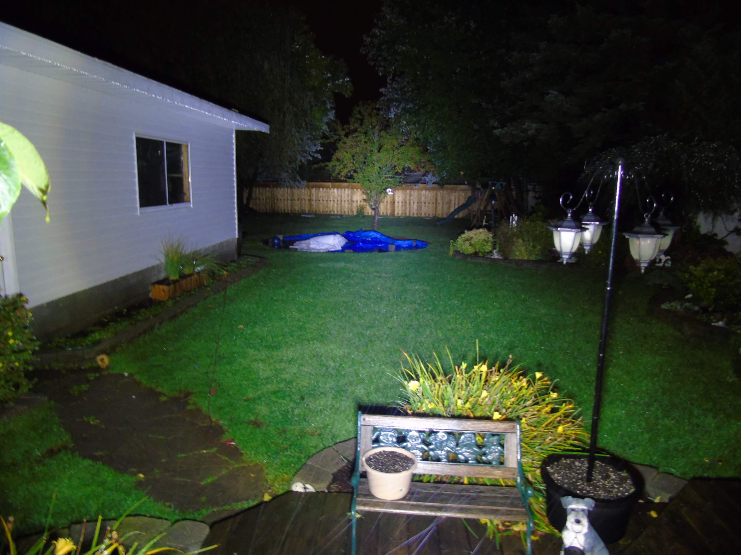

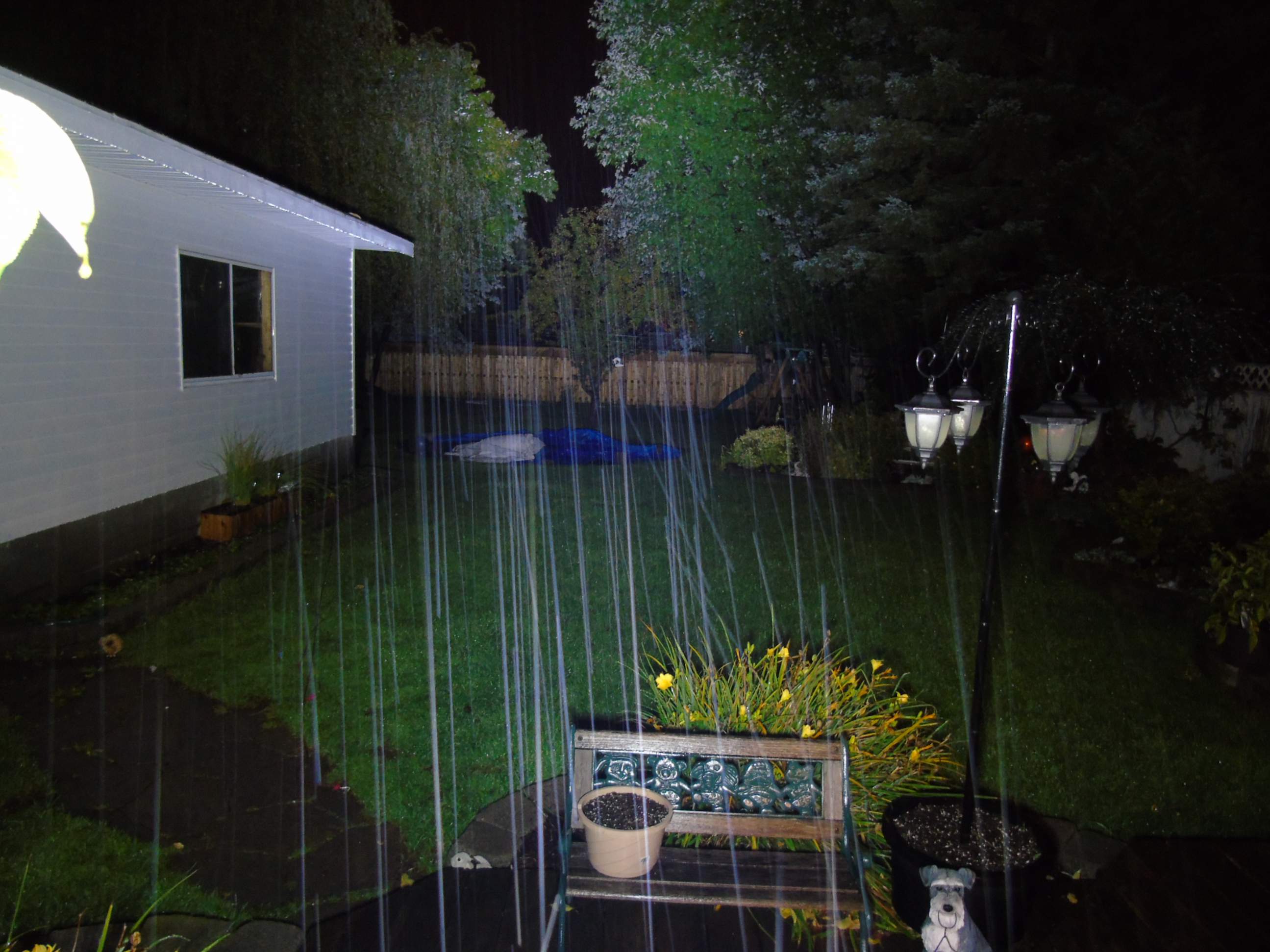

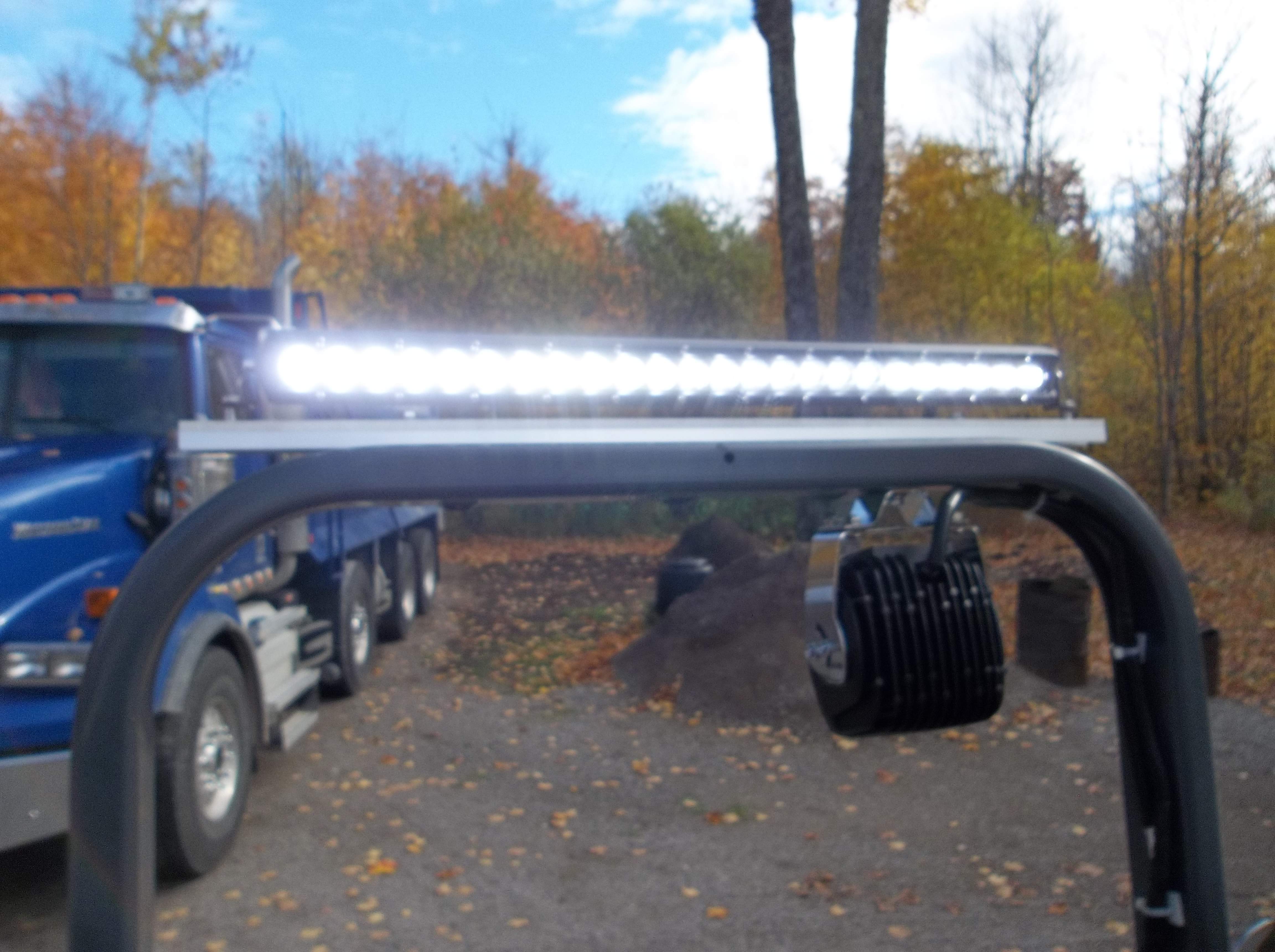

I'm still betting on it being the lights shorting inside somehow. Any way, the nightmare is over. Light bar works perfect.
Just have to aim tonight.

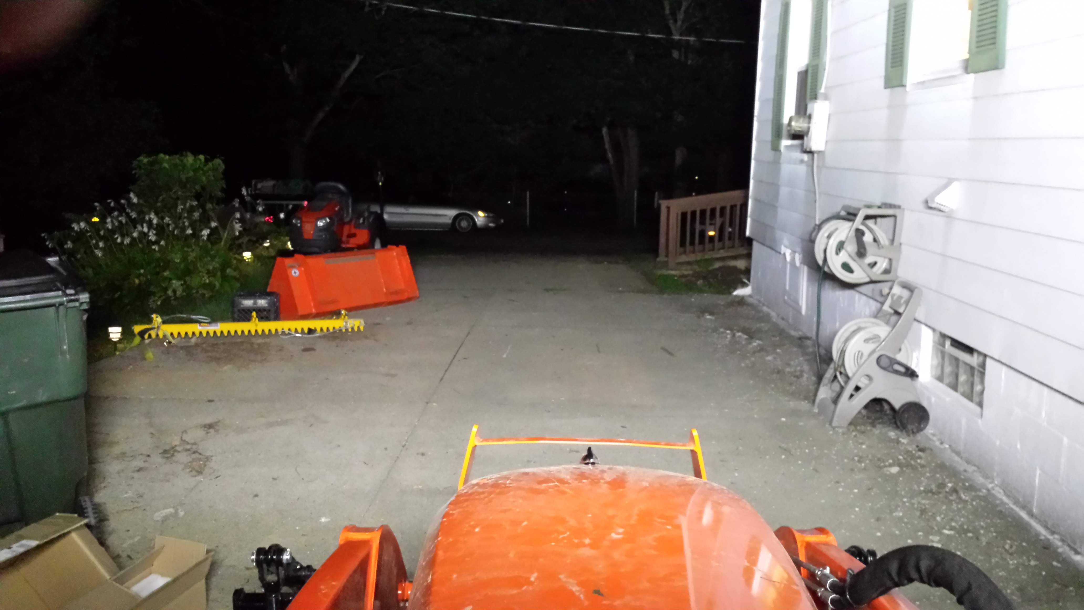

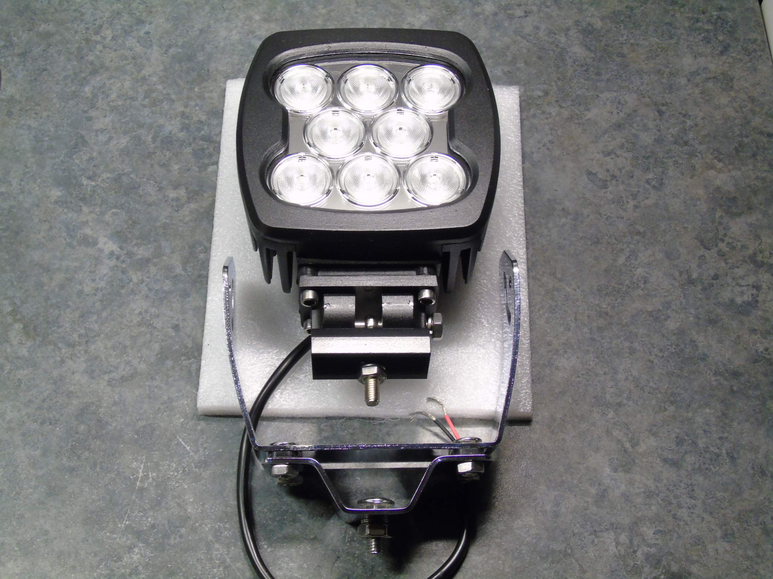

Woops....inserted wrong pic. That round one is one of the ones I returned. I was supposed to post the square rear flood. Oh well.
/ another led question #52

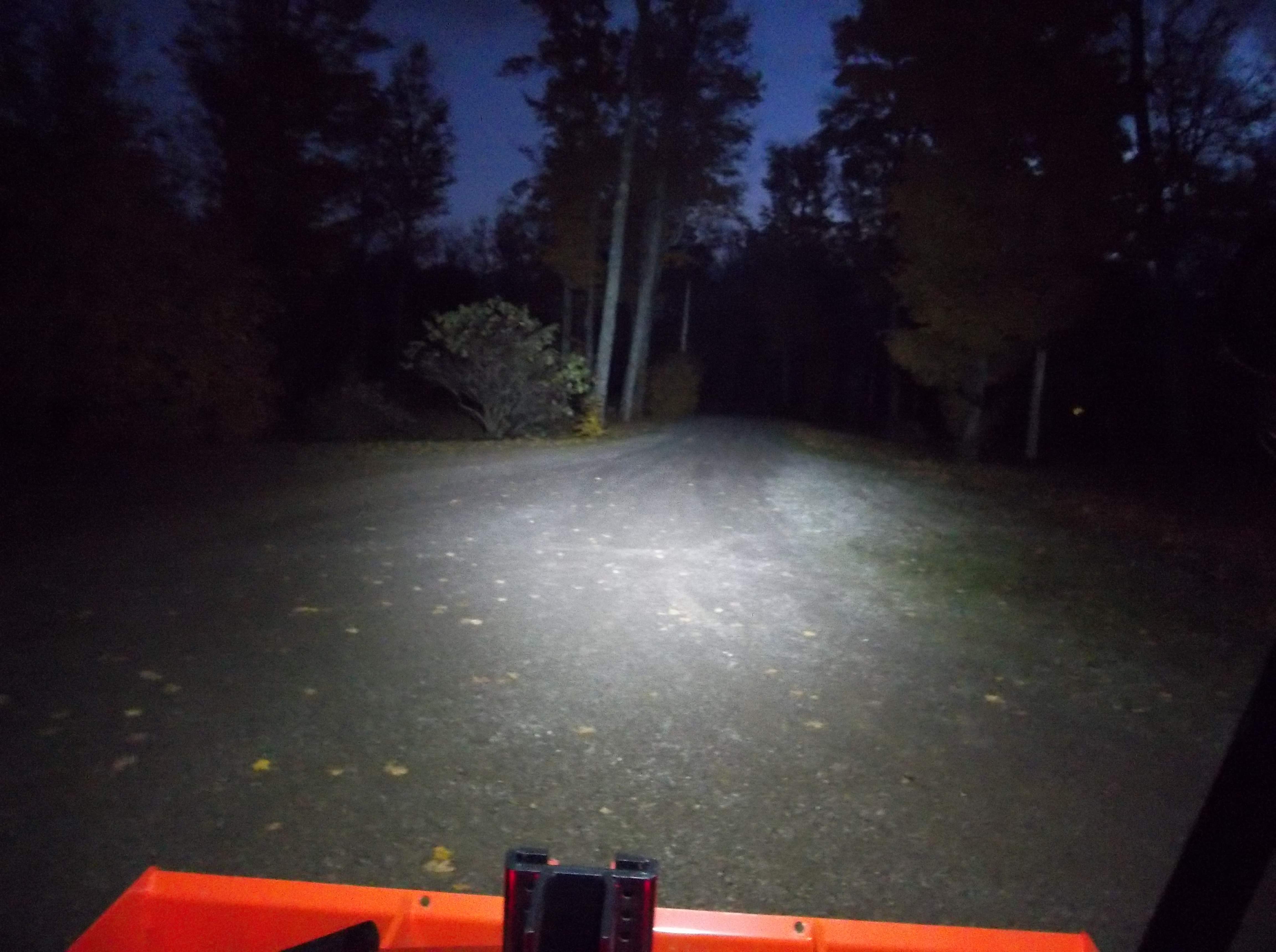

Looking down my 300 foot driveway from my parking area. Cheap camera doesn't show what your eye can see, but I can see the road from the tractor.
Pic 10 is the single rear 80W flood, Pic 11 is the front light bar.
Won't have a problem mowing and snow blowing now. Makes the stock headlights look like two yellow 1157 bulbs, LOL.
