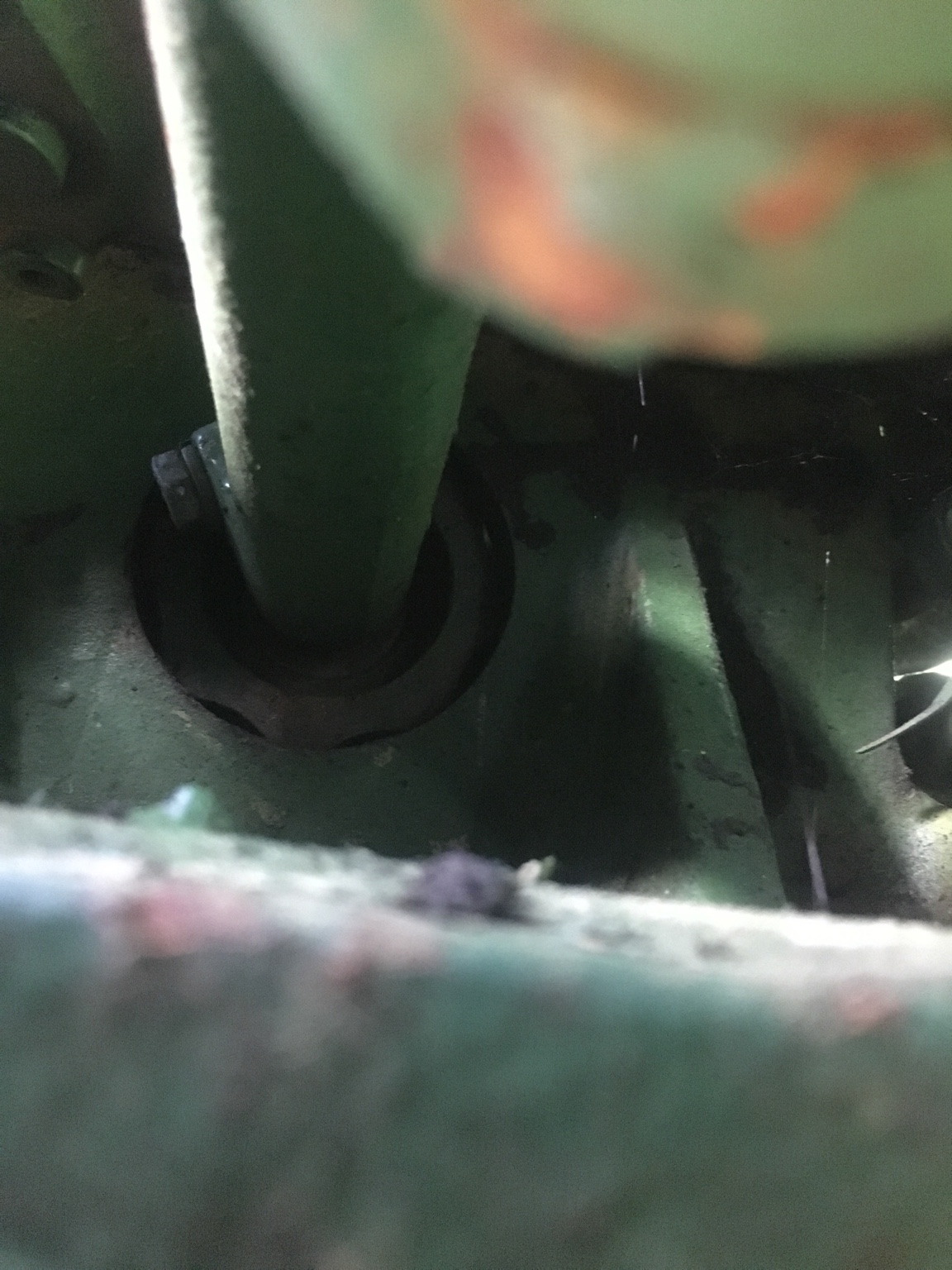

Then, I disconnected the drive shaft to the pump, on the back side of the shaft (not where it couples to the pump). I get a clicking noise inside the pump when I turn it by hand. Sounds to me like a pump issue maybe? Is this noise normal (I doubt it)?
JD 2155 main hyd pump clicking - YouTube

Are you turning the shaft a little for and back ? Looks like it !Uncopple thick steelpipe and see if oil come uit when you start the engine ? Looks like no supply to mainpump . Test at testports in r- side of shiftcover .

I was just turning it back and forth (left and right) to make the clicking noise. Also, there feels like no resistance whatsoever when doing that.

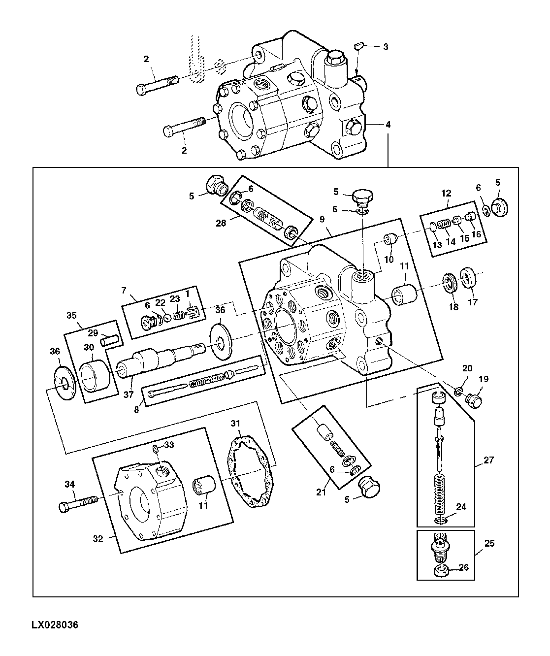

Thank you so much for these flow charts! I didn't get any notifications about these posts so I just got them now.

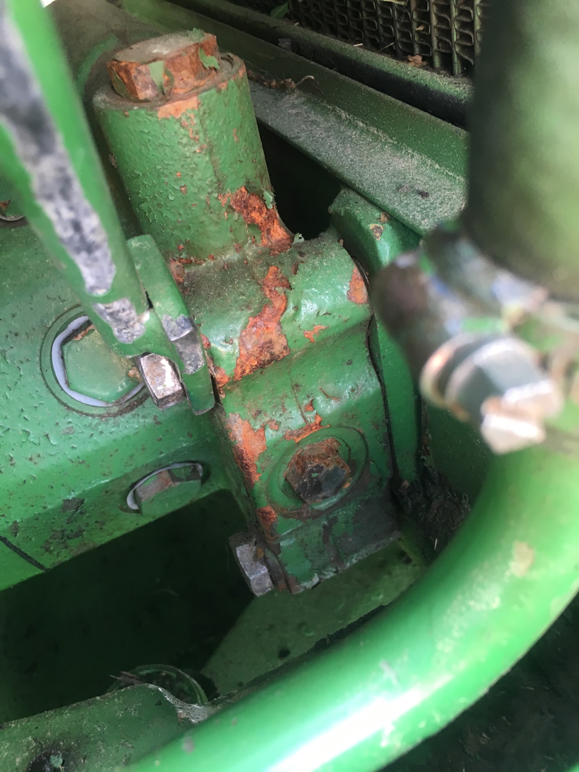

I got my problem sorted out today! After much troubleshooting it turned out being the stroke valve on the main pump. All I did was remove it completely then inspect and reinstall. After that, everything came back to life. I am getting 1700 psi at its current adjustment but I want to drain and flush it tomorrow then I'll put the gauge back on it and adjust it the rest of the way.
I didn't find anything obvious when I removed it. I just looked it over and put it back in.

I am ordering a new adjustment screw and jam nut (actually the entire stroke control valve). The one installed is seized so I am unable to adjust above 1500/1600 psi. Also, it is making a constant squeaking noise unless the hydraulics are in use. As soon as I stop Hyd actuation of the loader, it makes a constant noise right out of the main pump. I can even feel the resonance from the noise on the lines coming off the pump. The pump got very very hot after running it for a while also.
I noticed while driving around that whenever I push in the clutch the noise goes away completely.

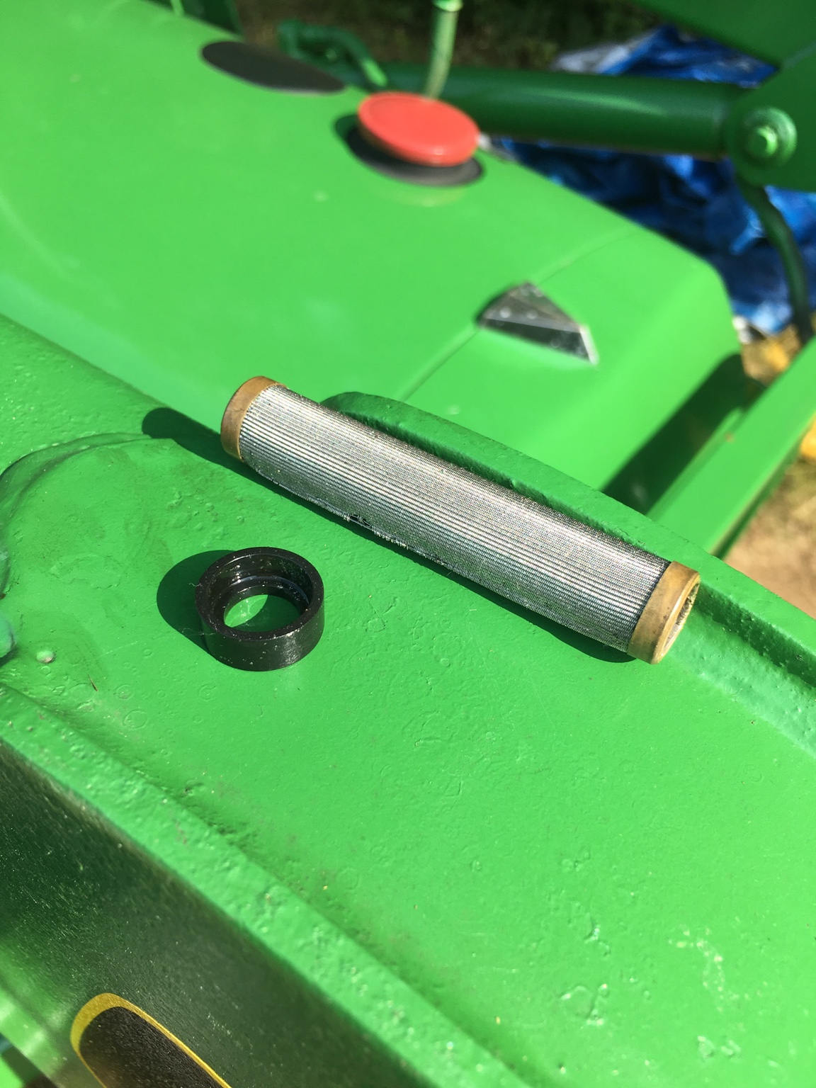

I also want to replace the small main pump filter pictured below. The info I have does give me a good part number. Any thoughts?

I couldn't determine if you knew filter PN but here it is. AL71020 FILTER-SERVICE KIT ADD 35.89 USD If your tractor was mine I install a magnet inside trans sump screen. Report back on pump noise after you install new stroke control valve.
