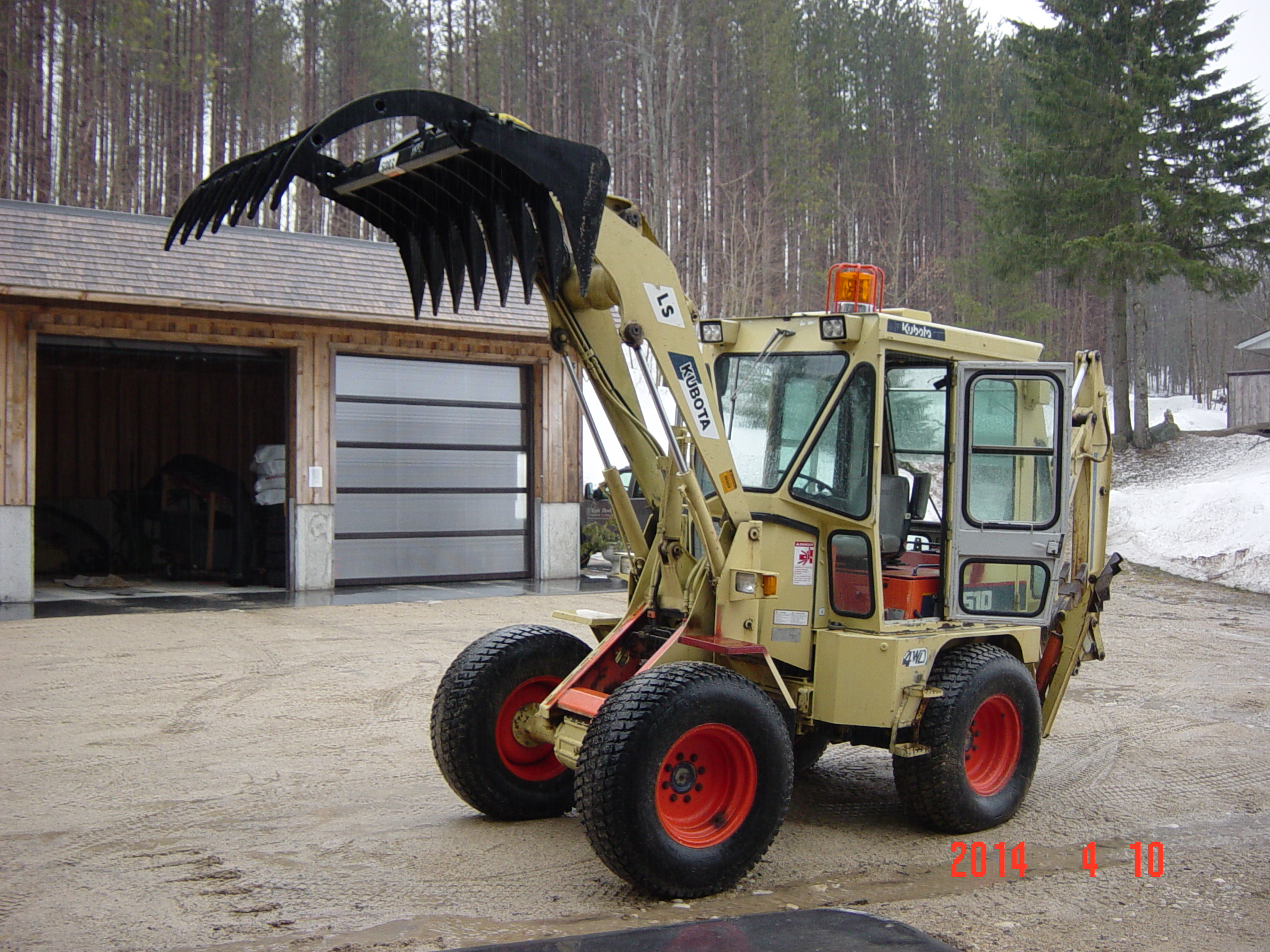

I bought this cheap, junky, no-name grapple off a guy (new) that he bought at a Richie Bros Auction in the states.
I have abused it, wrenched on it with long material and it has suffered zero for breaking or bending.
