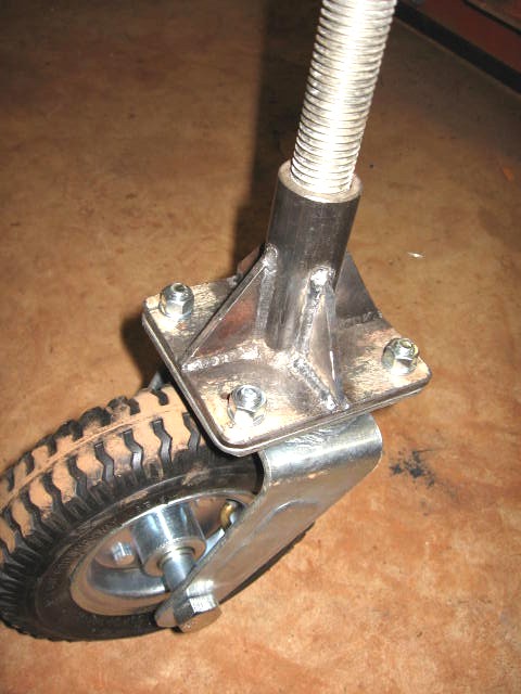

The silicone dust covers on the HF wheel pivot bearings finally cured enough to move the two parts. It took a few days. The portion that was greased (for release)still wanted to stick so I had to use a thin narrow blade to gently release the silicone from the moving race. The cover is softer than I thought it would be. Perhaps it will just take more cure time in this cool weather. It doesn't seem like the covers will hold up very long...time and use will tell. I used GE brand "Silicone I". Perhaps a different brand/product would be stiffer.

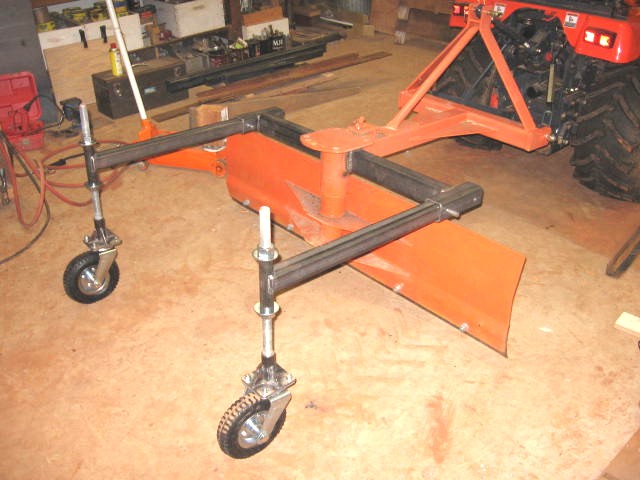

I just got mine done tonight and anxious to try it out tomorrow. I really like the trailer jack idea but after buying steel for 6 projects I needed to keep cost down and I had the all-thread and bushing stock on hand.

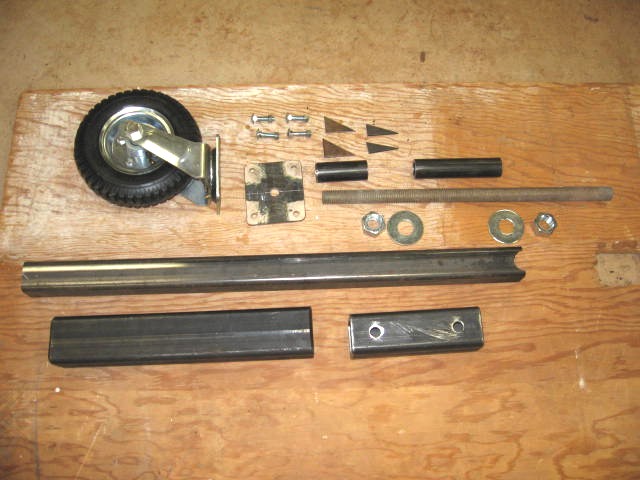

Here's the end result. Still have to bore a couple of holes but want to try it out first; maybe there are different locations that aren't apparent now. This is set at furthest extension so I can swivel the blade 360 degrees.
Parts
I used 2x3x3/16 for the outriggers
2x2 "receiver stock" (not 2 1/2 x 2 1/2 x 1/4 standard which has the internal seam that has to be ground down) Receiver stock is a little more money but worth it.
2x2x3/16 extension arms
1" dia all-thread with 1"ID x 1 3/8"OD bushing stock
1/4" plate wheel foot
HF 8" pneumatic wheel - I'll silicone the ball bearing pivot race like someone here suggested (for a dust cover) and hope for the best.
Here are parts for one side
One of the most difficult process was jigging up to weld the outriggers onto the RB pivot. Lots of alignments to look at.

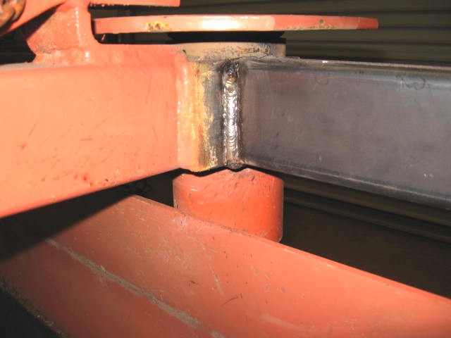

This was a very tight welding spot (below the blade pivot plate). Can't say I got any penetration because my angle was so low but I was able to get a bead in here. Other welds are 6011 1/8" root and 7018AC 1/8" over that.

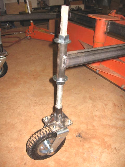

This is the hight adjuster
And the wheel detail. The bushing was welded and gusseted to the 1/4" plate then the all thread was plug welded to the plate.
Welding done w/old Lincoln AC tombstone and Lincoln Weld Pack 100 HD wire feed, rosin core.

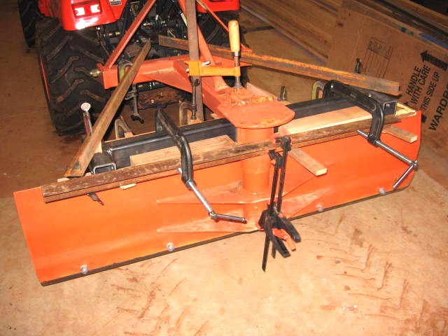

BTW - I too have a HF bandsaw. I've cut a fair amount of steel the past year. Motor is still OK. But I do have trouble getting it to cut (down) square with the table. I normally have to place my stock on the table shimmed 1/8"+/- (side to side) to get a plumb cut. This is especially noticeable once the blade has any wear. New blades are better but I can't replace them as often as it seems to need.
