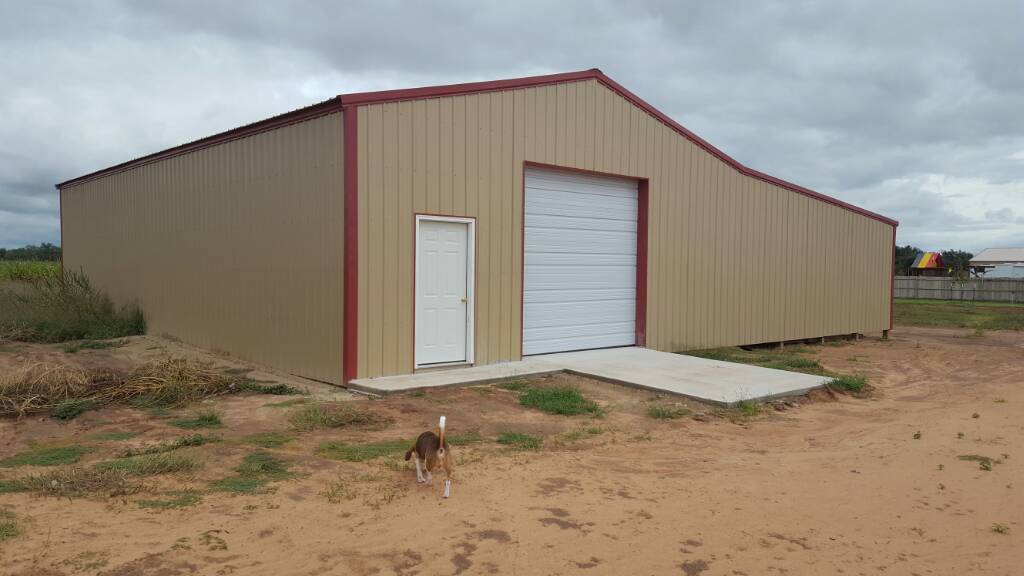

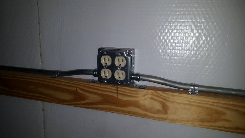

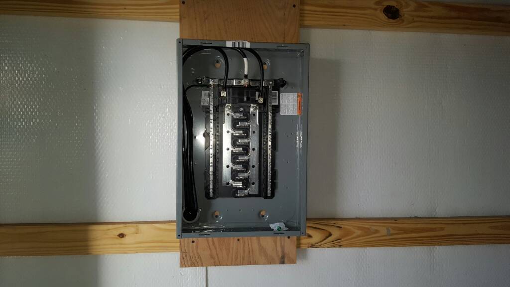

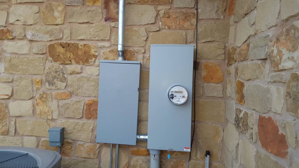

Just finishing up mine....I have a 30x50. We ran 100 amp service to the barn from our 200 amp service at the house. I used copper, as others have said a little more expensive, but I wanted to do everything right the first time. We installed 10, 4 bank outlets on the long walls, outlets on each end, dedicated Compressor, 20 amp, outlets in each corner in the ceiling, outlets on each exterior wall, 20/30/50 amp Rv box, switches on each and I have drive thru doors. I put 6, 48 inch 6 bank LED lights for the ceiling interior and a dusk to dawn flood on each door outside the barn on switches as well. Also an outlet dedicated for my garage Openers. Also go with a large panel, so you have plenty of space. Everything is ran is metal conduit for protection. The reason I added some many outlets, etc. Is due to my thread on here asking the same thing a few weeks ago. The best as others have said as well, is do it now. Get everything you could need in the future and do it once. Yes it costs more on the front end, but I should never have to upgrade......good luck. I am in West Texas.
20160925_115102.jpeg20161008_081726.jpeg20161008_082750.jpeg20161008_082759.jpeg20161008_084358.jpeg20161008_084444.jpeg20161008_084416.jpeg

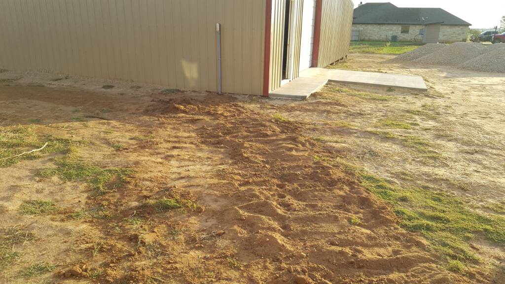

^^^How much of a problem is soil expansion/contraction for underground runs?
I've heard sometimes a flew or slip joint is needed from underground to the panel.
/ Another "Electrical Plans for the Barn / Workshop" question... #32
I am in West Texas, my electrician said it is not an issue for the50 foot run he did. It is 24 inches in the ground.

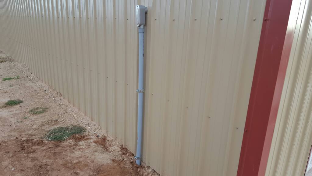

I personally ran a separate 200amp service to my shop - costs me about $10-20 a month depending on how much I am over there. The power company set a pole and dropped the line for no charge.

For me, cost difference between 200 amp wire/panel vs 100a wire and panel was a mere drop in the bucket.
I needed 110' of wire from meter to panel.
For 200a, 4/0-4/0-2/0 URD was $1.70 per ft. So $187
200a 30 space panel was $99
For 100a...2-2-4 URD....$0.90 per ft. So $99
100 amp panel...$70
So could have went 100a for $169
But choose 200a for $286
Seems trivial when building a $20-$30k building.
