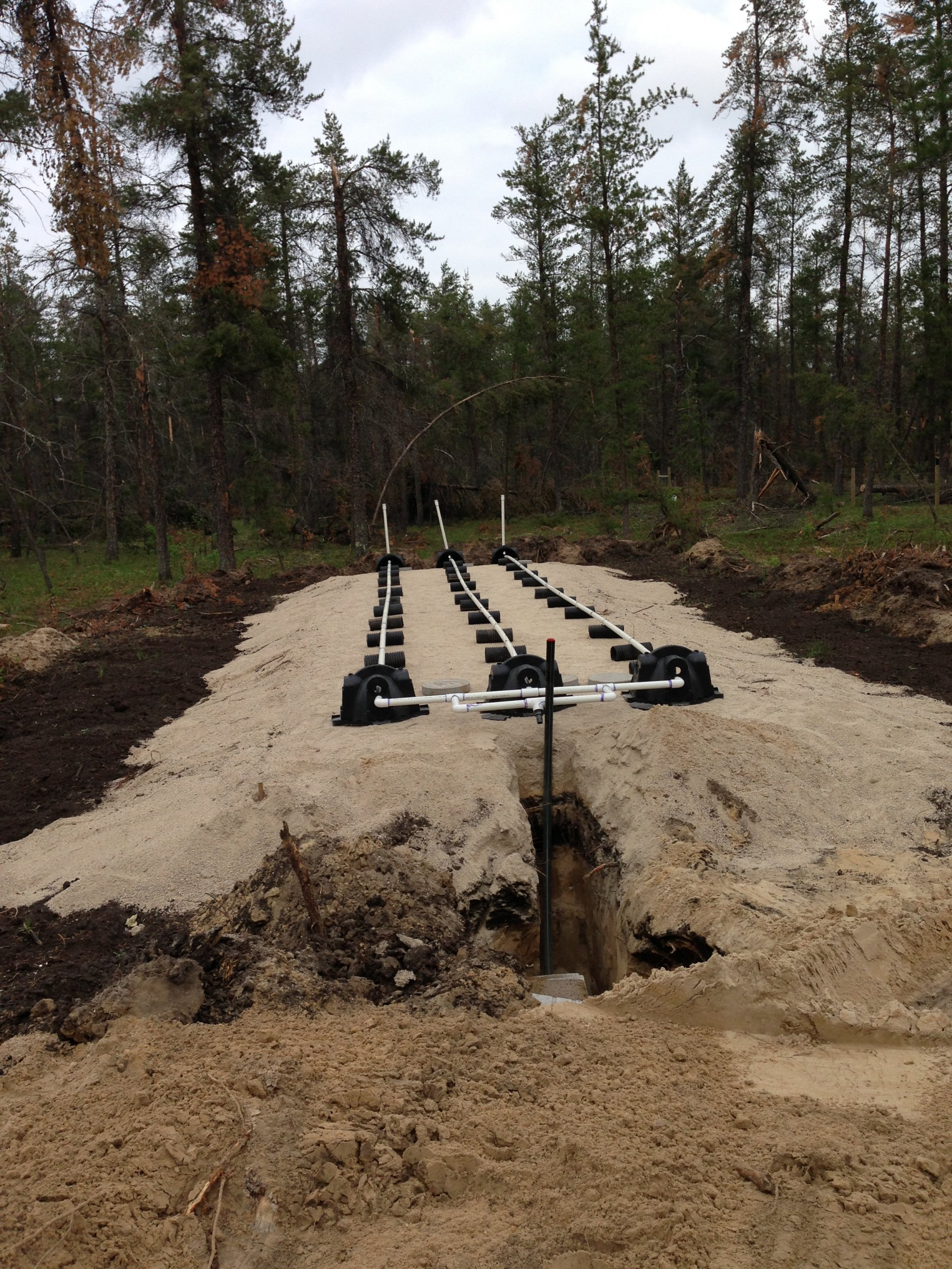

A small backhoe can do a lot including digging a 30,000 gallon pool (break the banks and move dirt with front bucket), installing and trenching for inspected/approved septic field, electrical tranches 36" deep to machine sheds, removal of stumps, water lines to gardens, etc....
Stumping I can generally do 5 pine tree stumps per hour, 14" avg. diameter, from freshly fallen trees on a b2620 or an l3301.
Footing for a 2,000 sq. foot shop took half a day.
150' electrical trench down to 36" in sandy soils about 3 hours.
Super nice to have it when and where wanted with no notice or worry of picking up and getting it back to rental shop.
But on the downside it could make you super popular around your village or wherever you live.
Slower than a big bucketed excavator, weaker than a mini ex. but sure valuable to me.
I am well experienced and careful with my stuff. I could do some pretty stupid things with my BH that could wreck stuff but I simply don't push it rather take my time, use my head, and have yet to have O-sh@t moments. We were tought in grade school farming classes smooth is fast, steady is safe, and getting home at end of day is the goal.
Cheers
Thanks for the great response and pictures.
When you brought up water lines, I couldn't help but think of some of the ranches I worked on while I was younger. EVERY winter there were busted pipes to the outbuildings. Buying them in a trench sure would have saved them some $$$.
I also forgot about the septic system! I think I will be able to really get my moneys worth out of the BH. It's a "Branson" BH200 by the way. Going to see if I can get the BH250.
