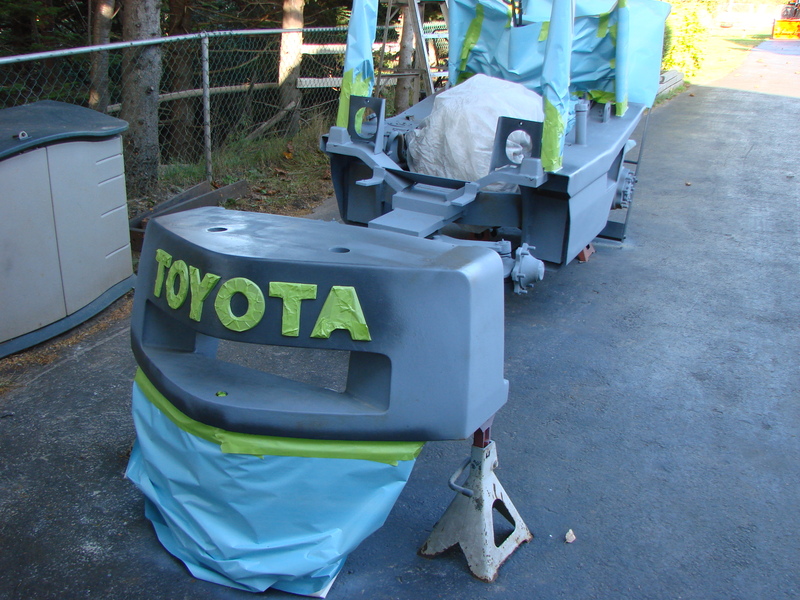

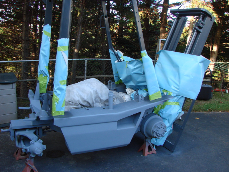

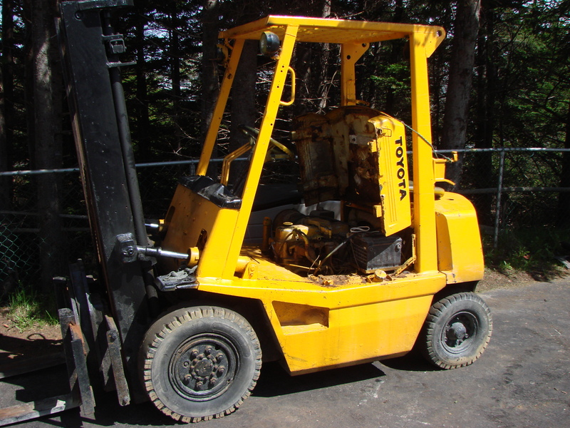

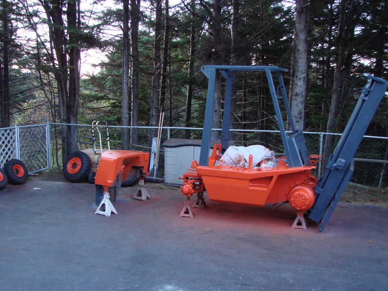

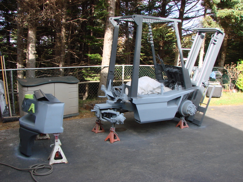

The fork lift is coming along very well. I looks much nicer than in the photo's I attached below :D It's now rebuilt and painted. Just the custom stuff to do with it next.

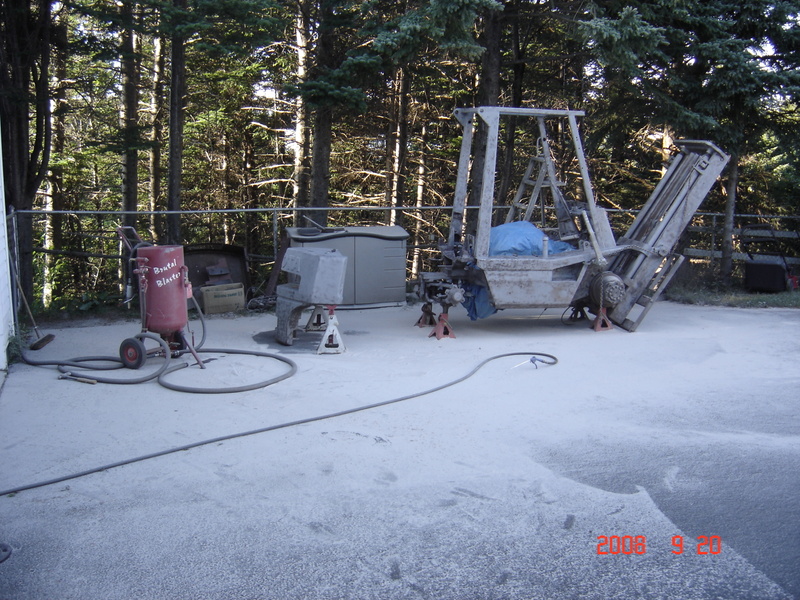

Guys when it comes to this restoration stuff and the tooling needed to do it safely I don't cut corners.
You'll notice in the photo's that I have a special sandblasting helmet on that's made by 3-M. It's hooked up to an ambient air blower in the shop that will pump fresh filtered air into the helmet plus it creates a positive pressure inside the helmet. There is NO dust that gets into the helmet at all.
As for the lift photo's. I never sandblast there in the open. This time I had to do it because the forklift was not running and pretty well dismantled at the time. I usually do my sandblasting in a container in another part of the property. It took the best part of the day to recover, clean that area and then it was all pressure washed down. Sometimes you got to do what you got to do to get'er done.

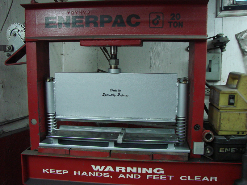

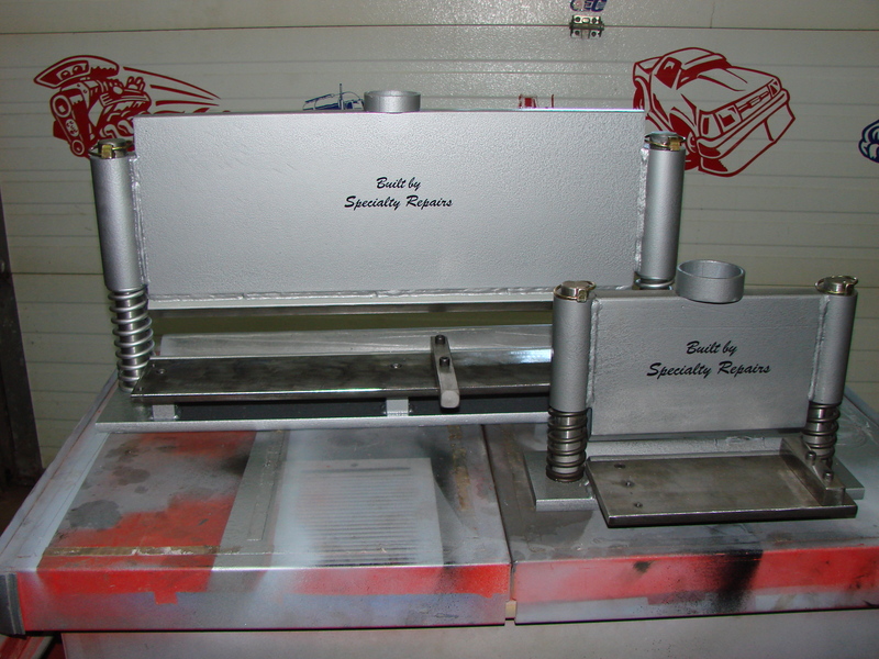

mjncad. I attached a couple of phot's of tools I made this past weekend. There two different size metal breaks. They work great and there strong. I built the big red press a few years ago. It's electric over hydraulic. There's also a photo of a tubing notcher I built and still use from a few years ago. I know you and WaxMan are extremely good at building stuff so I thought you might find it a little interesting.

WaxMan I have baked some items in the past and your right, it works great. I've done it to motorcycle gas tanks after refinishing. I do all my bead blasting in a bead blaster that has it's own recycling and recovery system. Great unit and very efficient.
When it comes to the pressure blaster you see in the pictures. Well there's a bit of a story to that one and I mean that literally. I designed and built that one. It was featured in Welding, Design and Fabricating magazine in Cleveland a few years ago. This thing works better than good. I attached the story below to bore you with. :rolleyes:
