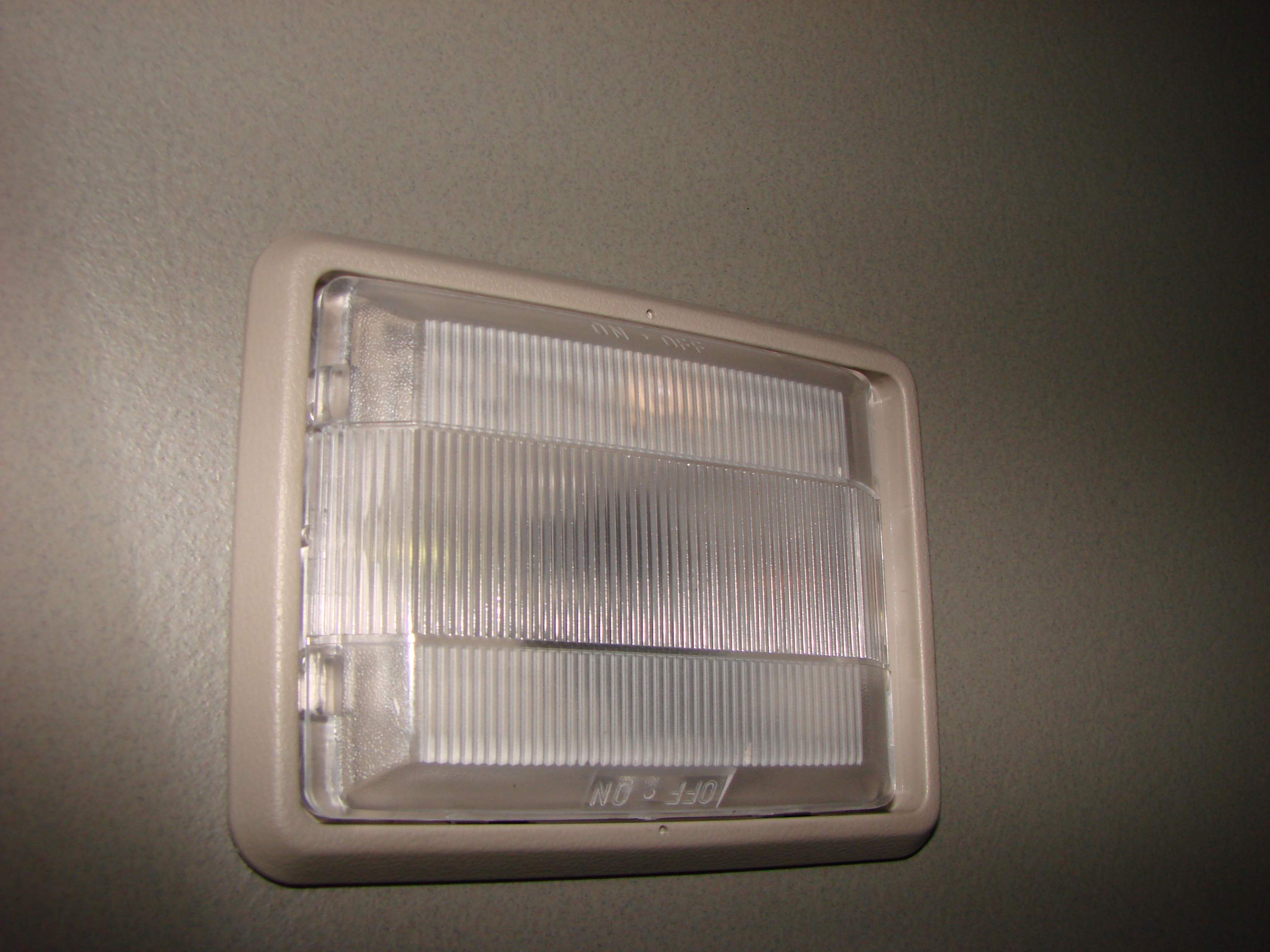

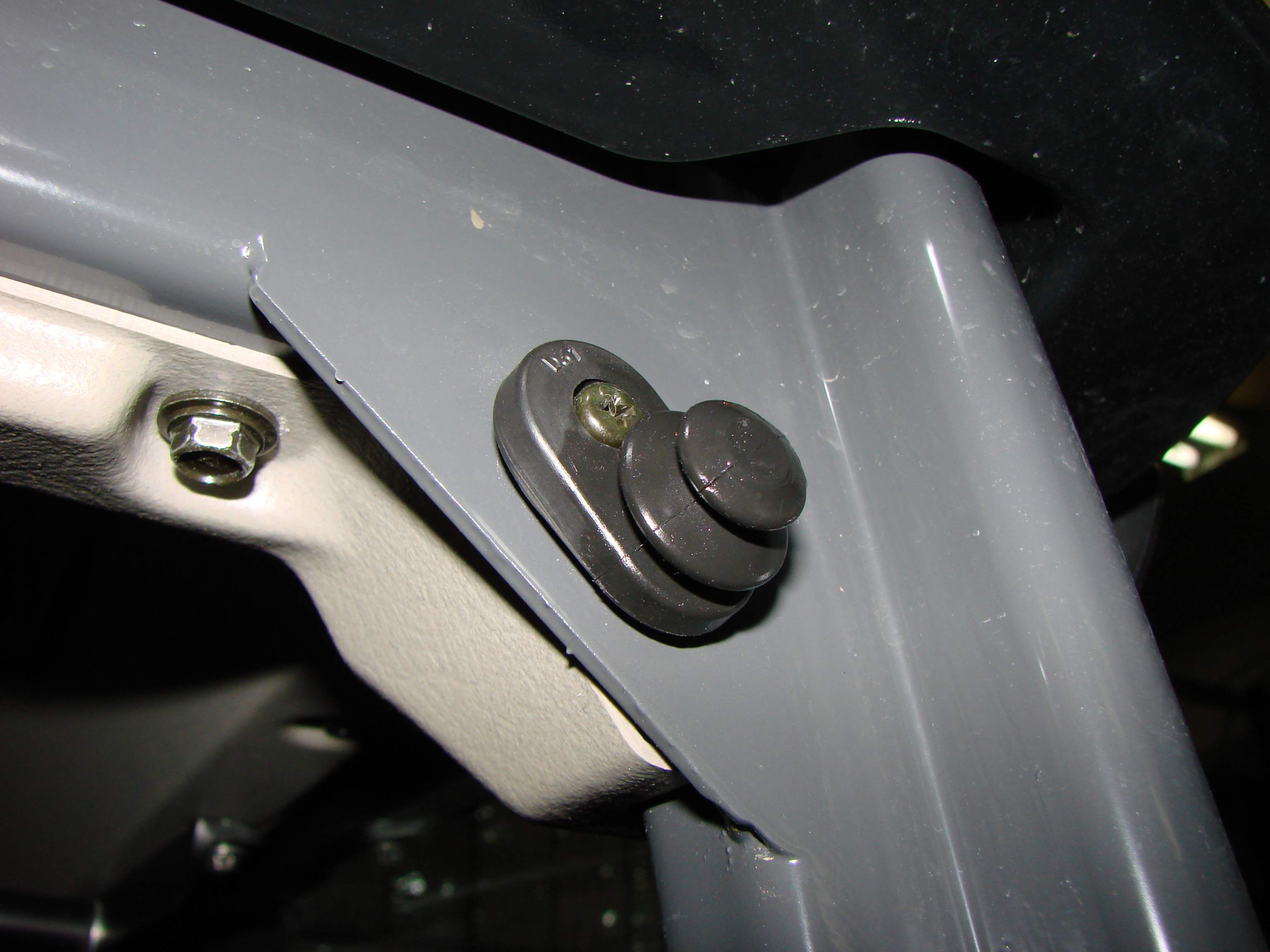

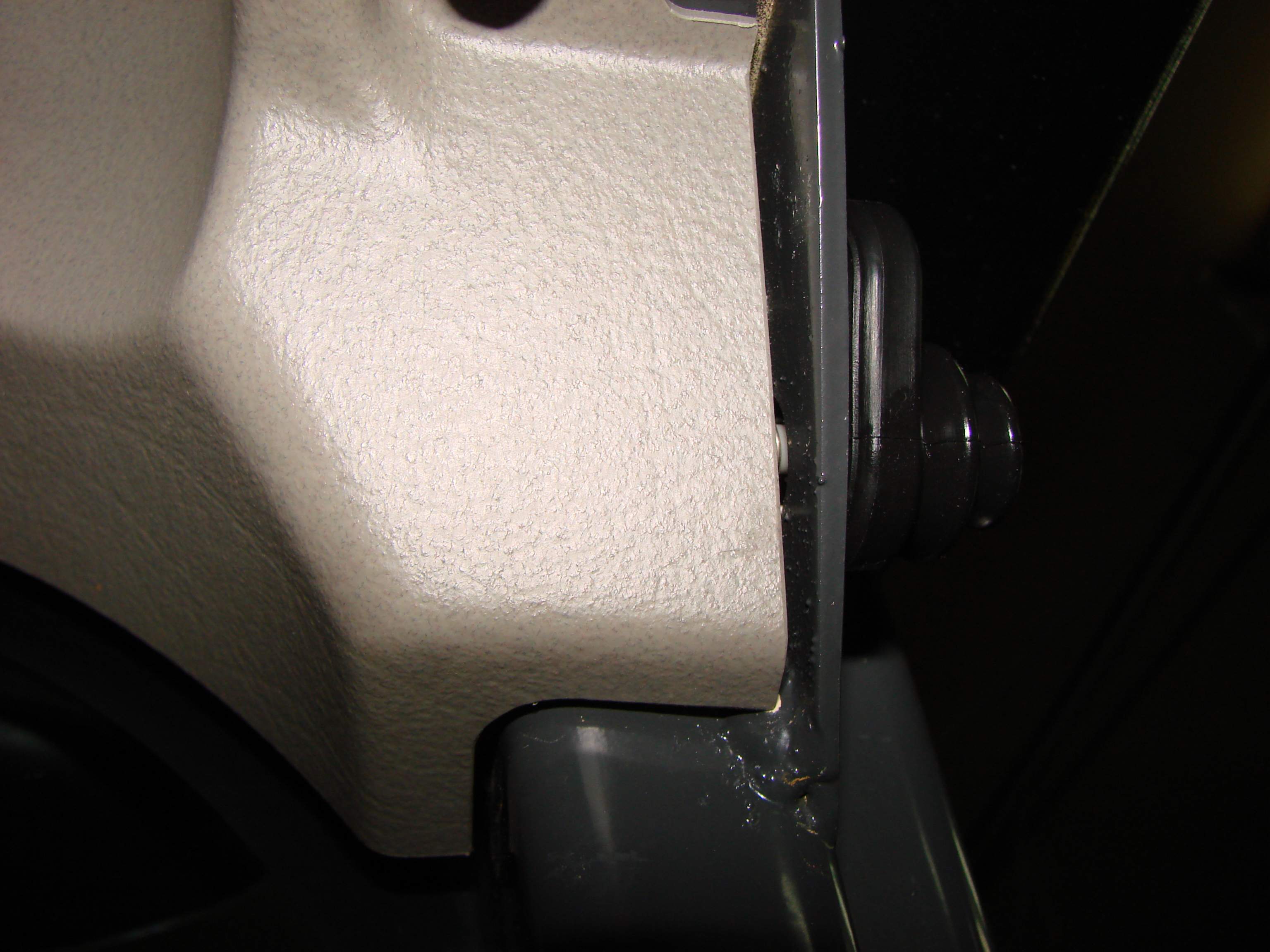

WaxMan the interior light is hot at all times via the fuse panel. The light it's self has a switch on it where you can have it turned off at all time or turn it on only when the doors are open or never have it on. I attached a few pictures for you to view. You'll notice that Kubota had the head liner come down on the inside of the door post switchs to hide the wring on the inside. I'd say picking up the light and switches at Kubota. It would be an easy install. Hope this helps. Paul

Thanks for the quick reply and pictures, I see clearly now how Kubota door switches work , If not for you I would have to drive 50 miles to see this. Seems like just a normal low profile switch with the rubber on it, I like that. Something I can rig up pretty easily now that I see what switch they used.
If I can ever return the favor, just let me know.
Too late to get the light from Kubota, went to the junk yard yesterday searched just about every make and model till I found a flush mounting light, gray in color. I had the headliner of the tractor out and wanted to get a light in before I reinstalled it , been wanting to put one in for a while now. I did that part last night, now the wiring.
I just wish I had a HOT wire (without key on) already up in the head liner.
I have no room on the sides or the top to recess the light like Kubota's light.
The light I got has two built in spots (Map light) on both sides and a dome in the middle.
When I first held it up there I didn't think I would like it because the spots not only shined down on the dash but outside each door, because the truck I took the light out of is much wider then my tractor.
But I think i like the fact that it shines out the door, lights up the ground in front of the door and the step so maybe it will be nice. Well time to go feed that hot wire.
Thanks again.

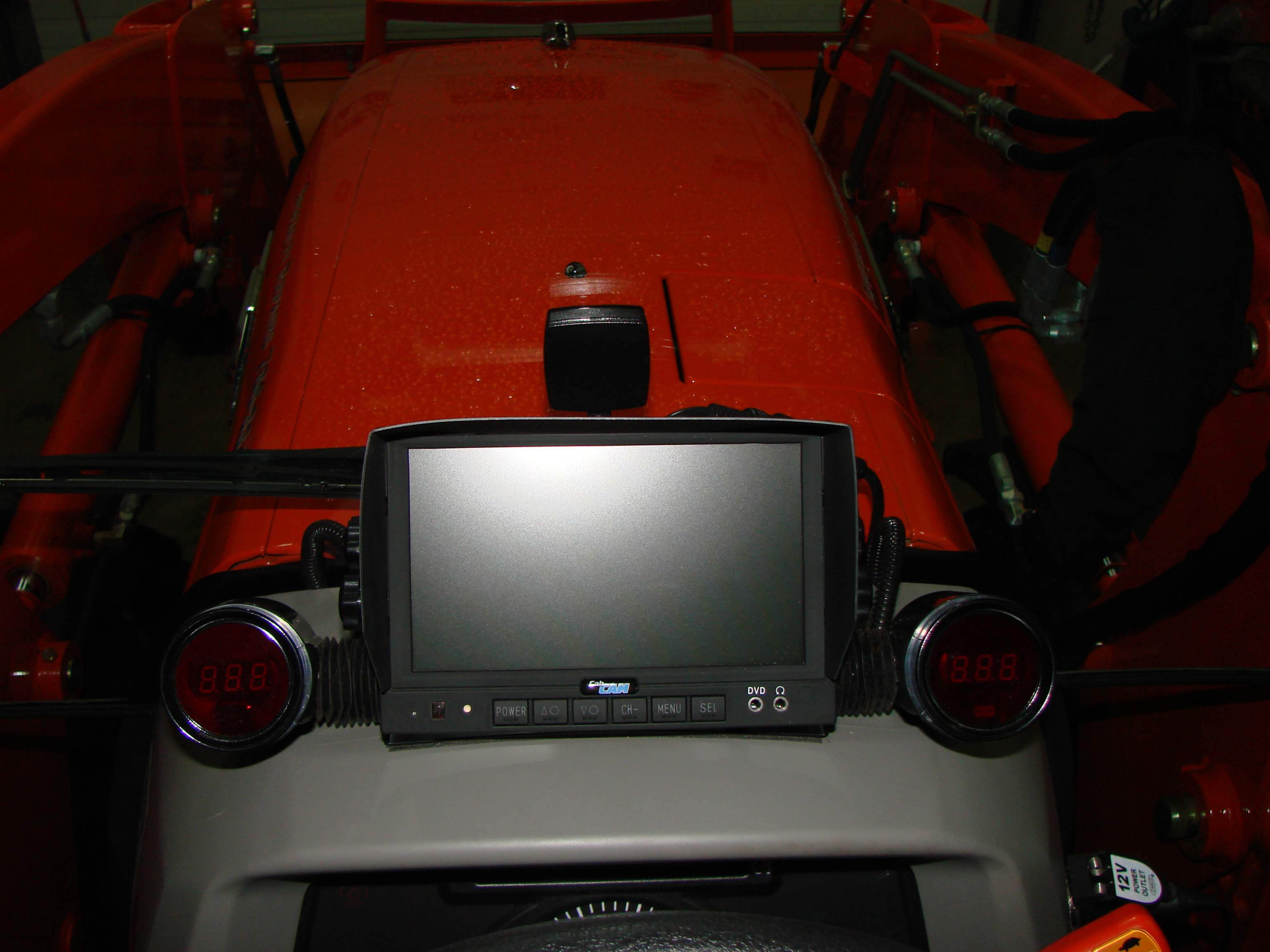

Thanks WaxMan. I got my volt gauge installed tonight. Now it matches the gauge on the other side of the bracket. Got to keep it all balanced ;)

Looking good, I like the little rubber accordion gasket spacers, nice touch.

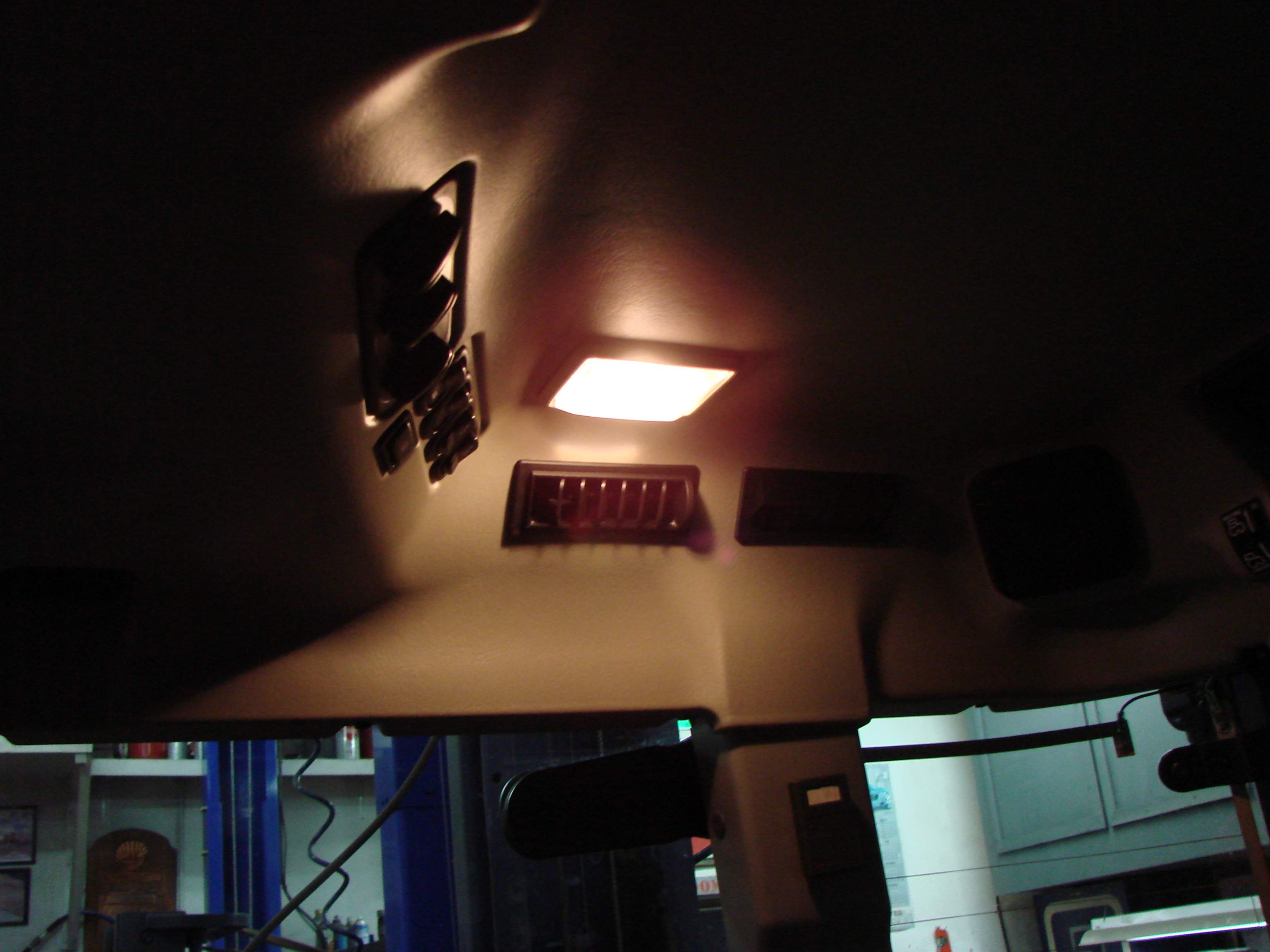

I have decided today not to put any switch in , the light is in and I can turn it on and off from the switch on the light.
Most of the time that i will need the light I will already be in the cab. Turn it on to get out and move something then shut it off when I get back in .
Looking at my door frame and the size of the hole I will have to drill in it and the nice flexible door gasket and what will happen to it over time , I think I am going to wait and see , I ran the wires down the pillars so if I decide at a later date they will be in reach. I looked thru a catalog of door switches today It's unbelievable how many different sizes and kinds they have, you would think even the same car manufactures would settle on one or two kinds of switches There had to be 100 different ones. What is also important is the pressure it takes to push the switch in, some have a very strong spring others very weak spring, all I have is glass with a very soft gasket on the door I don't want to mess it up and experiment with one that may make the door hard to close or the light go on and off while driving.
I really appreceate you passing that information to me.

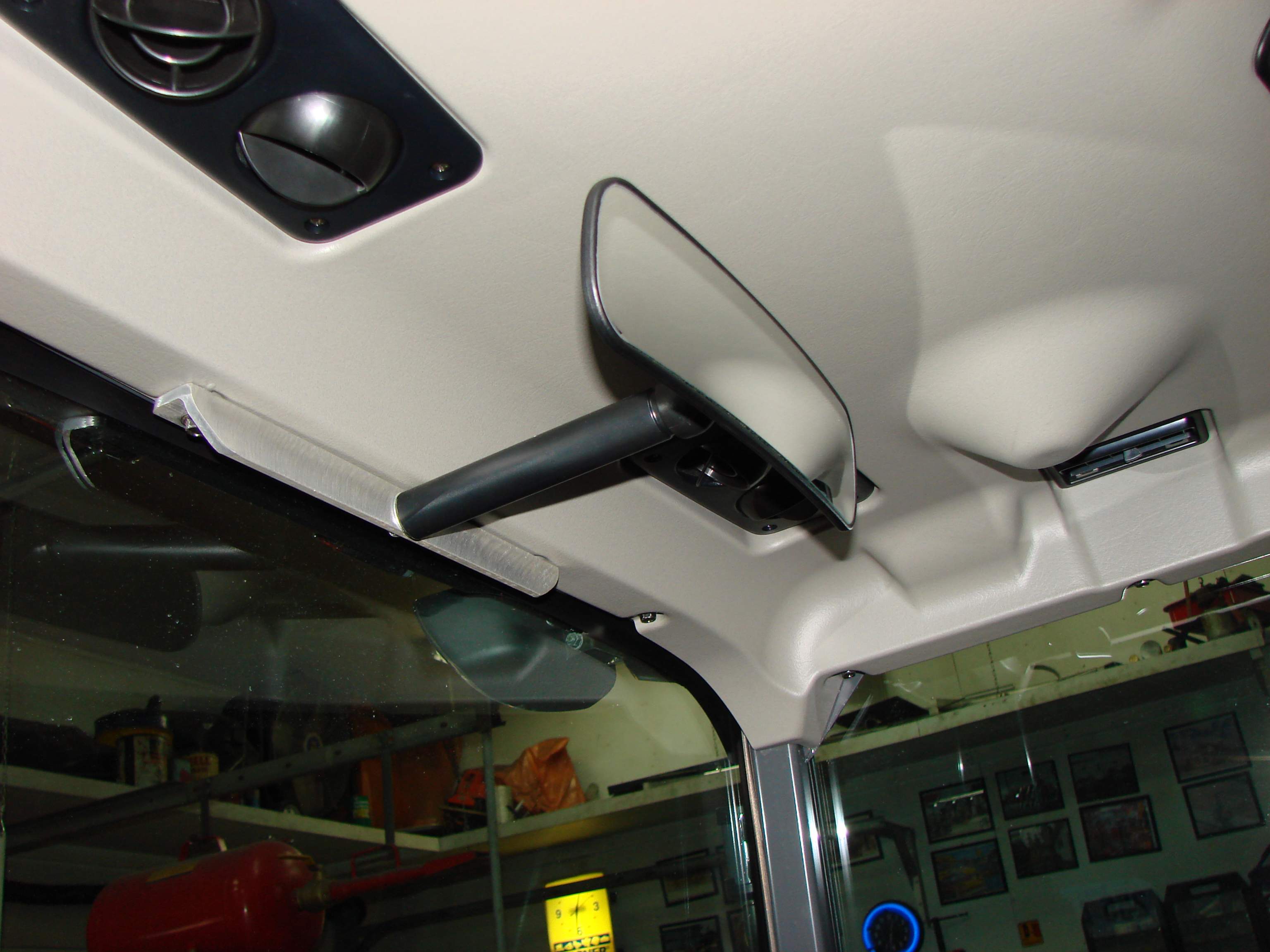

Here is a picture of the installed light. The spot lights are nice because it lights up the dash, the floor, out the door, and not me. If I switch to the middle light the whole cab lights up including me. At first I thought it was big but I happy with the amount of light it gives off and the pattern.

I like that dome light with spots WaxMan.
