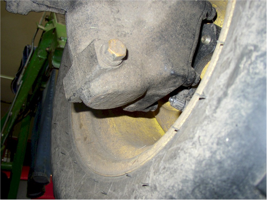

on a side note, the tech manual just says 'replace the cap'...it doesn't tell how it should be done.
the cap has a rubber lip, extending beyond the OD of the cap. does anyone know if you drive the cap in until the lip just hits the shoulder of the housing, or do you drive it in until the lip folds back up into the ID of the housing? i can see it going either way, and not sure if it matters. the factory cap looks different, so i can't compare.
/ another 4300 design flaw! #23
Drive the cap in until the flange contacts the 'shoulder' of the swivel housing.

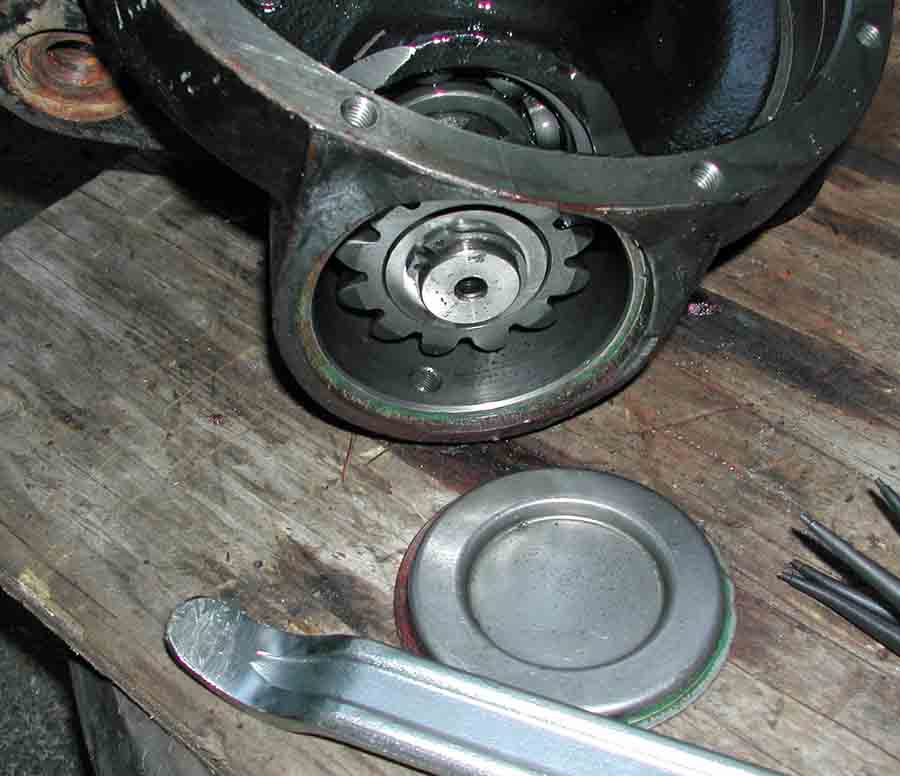

i took this picture from Dfkrug's 4300 rebuild thread...
his cap is all steel. my new cap looks similar, but the lip around the outside is rubber. his cap, you can tap up until it hits the steel flange, and it won't move unless it's crushed by something. if i tap mine in until the rubber hits, there is nothing to hold it from going in further, with minimal pressure.
the cap on the other side looks like his steel one...so it does look like they made a change on the replacement parts that is worse than the original. i will look into if they ever offered the 'all steel' caps later.

thanks, after seeing what an all steel original looks like, i do believe that it correct. don't know why they went from a steel lip to rubber.

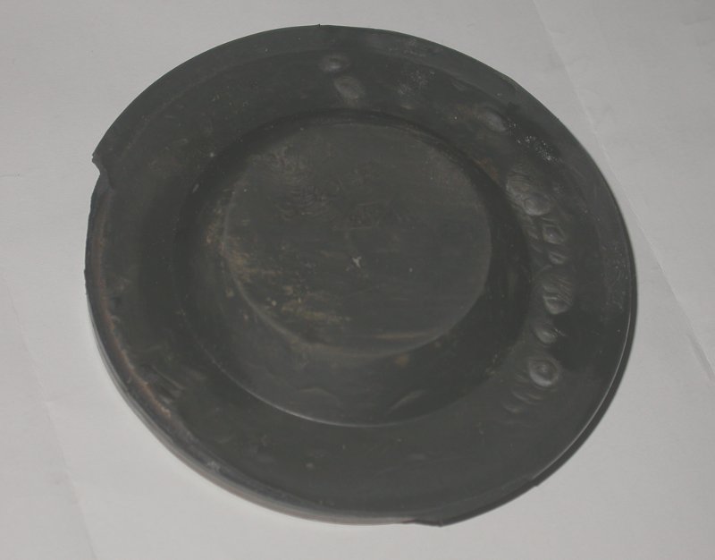

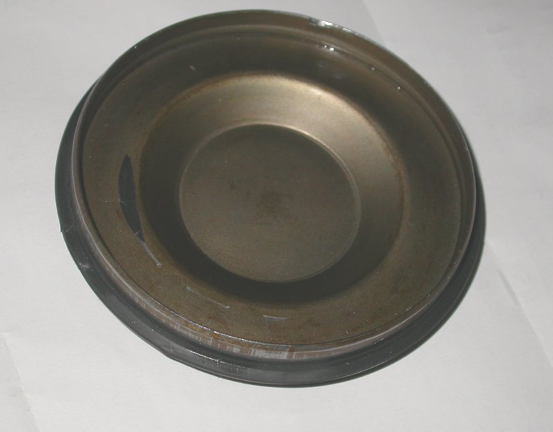

Beenthere, i have the new style cap here in the house if you would like to see a picture of it for comparison to what you have on yours.
/ another 4300 design flaw! #31
I would like to see the picture.
I did check mine and both are intact (no oil leaking ). Also could see where they are in a position to be quite vulnerable if catching a rock just right and rolling over caught underneath. OR in hard dirt compressed under the same place.
#32
you can see the rubber lip around the outside (some is torn from when i removed it), and the bump is tapered, instead of coming out square.
it also says 'spicer' on it, i can't see any wording on the factory original.
So, the metal lip on the new seal DOES NOT contact or seat on the inside lip of the final drive housing? But, the old metal seal DOES seat on the inside lip when installed! Correct?
That doesn't sound right... I can imagine the engineers adding a neopreme seal to reduce the likelihood that the metal cap will "seep". However, I CANNOT imagine that they would eliminate the metal base seating against the drive housing lip. They might reduce the size of the contact surface to allow for expansion room with the seal - but no metal to metal base - that's not good design work!
Do you have a big ol' socket that would fit around the circumference of the seal to use as a seal driver. I've got some great big ol' sockets that I used on the front axle nuts on an old IH 4x4 1200 series truck. Big honkin' things - 3/4" drive must be 4" diameter!
I wonder if you're installing the cap - all cattywompus..? And that's why it's leaking?
Have you picked the local JD mechanics brains on this problem? Be interesting to get their take on the solution.
AKfish
#35
AKfish
it is true. the old one is an all metal lip, the new one has NO metal in the lip, purely rubber. part of the rubber lip is torn off from when i removed it and i can see the metal part is cylindrical...meaning all the metal goes inside the housing w/ just the rubber on the outside. i commented to the parts guy and he was like, yea, that's not going to stop it from moving.
i didn't talk to the service guy because i didn't know at that time that the original was all metal. but i did want to ask them if i could get the all metal ones from somewhere.
the one that got pushed in was installed nicely, and didn't leak until it got knocked around. the new one, i did have a problem getting in there straight, it is a bit off, but w/ the sealant, it is currently sealed. as long as it is still good when the axle builds pressure, i'll go w/ it until it gets knocked out again!

i guess part of the confusion is my fault. i didn't know about the all metal cap until i talked to Dfkrug about his caps. the one that got pushed in was a rubber lip....which i THOUGHT was original equipment...since that is what they sell as replacements. so, i guess that side had already been worked on before i bought it, and the cap replaced. the other side, which i have never opened, seems to still have its original cap.
the one picture i showed was of Dfkrug's all metal cap. the post w/ 2 pics, is the old rubber lip that i removed...one pic of each side. the new rubber lip is never pictured and installed.
so, i removed a rubber lip and replaced w/ a rubber lip.
