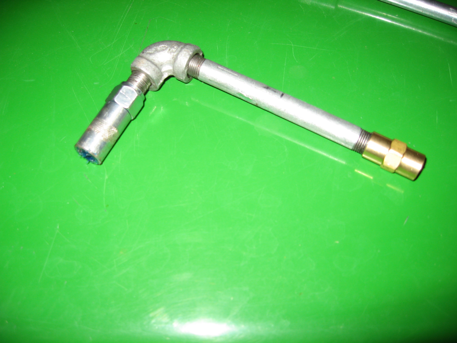

To grease the front you can make a 12" straight tube adapter for your grease gun to reach from the access panel on the left side of the kick panel.
To grease the rear u-joint, the dealer made me an L shaped adapter. Much harder to reach but you can get to it from underneath.
Enter from the front of the shield and reach toward the rear joint. Note the top of the L shaped adapter had to be grounded flat to get into the tight space. The tips of the grease tube fittings may have to be grounded to get into the space of the joint. The drive shafts are at a slight angle so the grease gun fitting can only be used at these particular spots/angle. (pointing towards the left side of tractor) I found that when you shut down the tractor the u-joints always stop in the same place (zirk's pointing to the left) so be sure to note the direction the zirk fittings are pointing and replace in the same direction. I discovered this after cutting a 2" hole from the floor and attempting to reach the zirk fitting from the top. Hope this helps and good luck.... IMG_1730.JPGIMG_1731.JPGIMG_1732.JPGIMG_1726.jpg

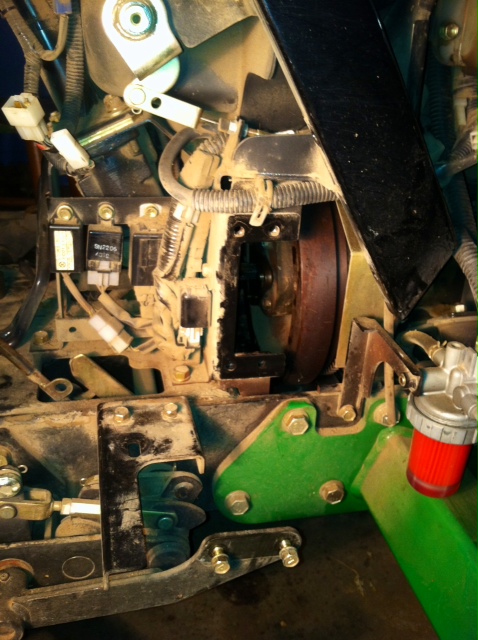

Now I know, to access the front u-joint remove the kick panel below the dash and a metal plate on the right side of the frame!

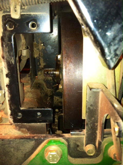

SUCCESS! Got the shaft removed without too much trouble. Thanks Gator6x4 for mentioning the metal plate on the right side-- it is really the only way to get the C-clip and 2 roll pins removed. I bought a set of roll pin punches, made it pretty easy-- removing the C-clip (in pieces!) was much more difficult.

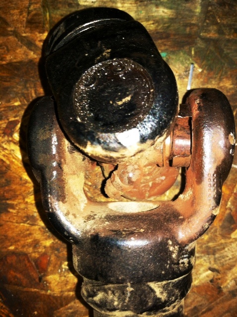

There is one cup that is simply annilhilated. The joint has begun to chew into the yoke, but it appears small and isolated, I am hoping it won't affect anything once a new cup is installed. That sucker was DRY as a BONE- i wonder if Deere forgot to lube that one from the factory.

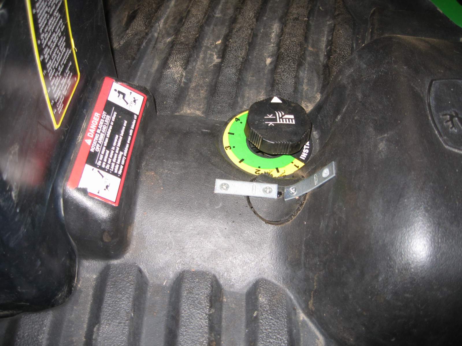

I completed the reassembly today (except the ROPs) and fired up my 2210 with fresh U-joints. It felt like VELVET! Much smoother than it's been in the past months. Can really feel the difference.
Thanks for all the tips. I also cut a neat new access hole in floorboard as suggested in another thread, perfectly matching the access plug from the kick panel. Ready to grease at next service. And soon, will be ready to plow.

Yep, my '03 2210 had failed driveshaft bearings at around 700 hours. There was nothing left of the bearings but a reddish powder! I have yet to find a way to grease the rear u joint even after cutting a hole in the floorboard so I have a feeling that in the next couple years I'm going to have to dissassemble the whole thing again! Now at over 900 hours.
