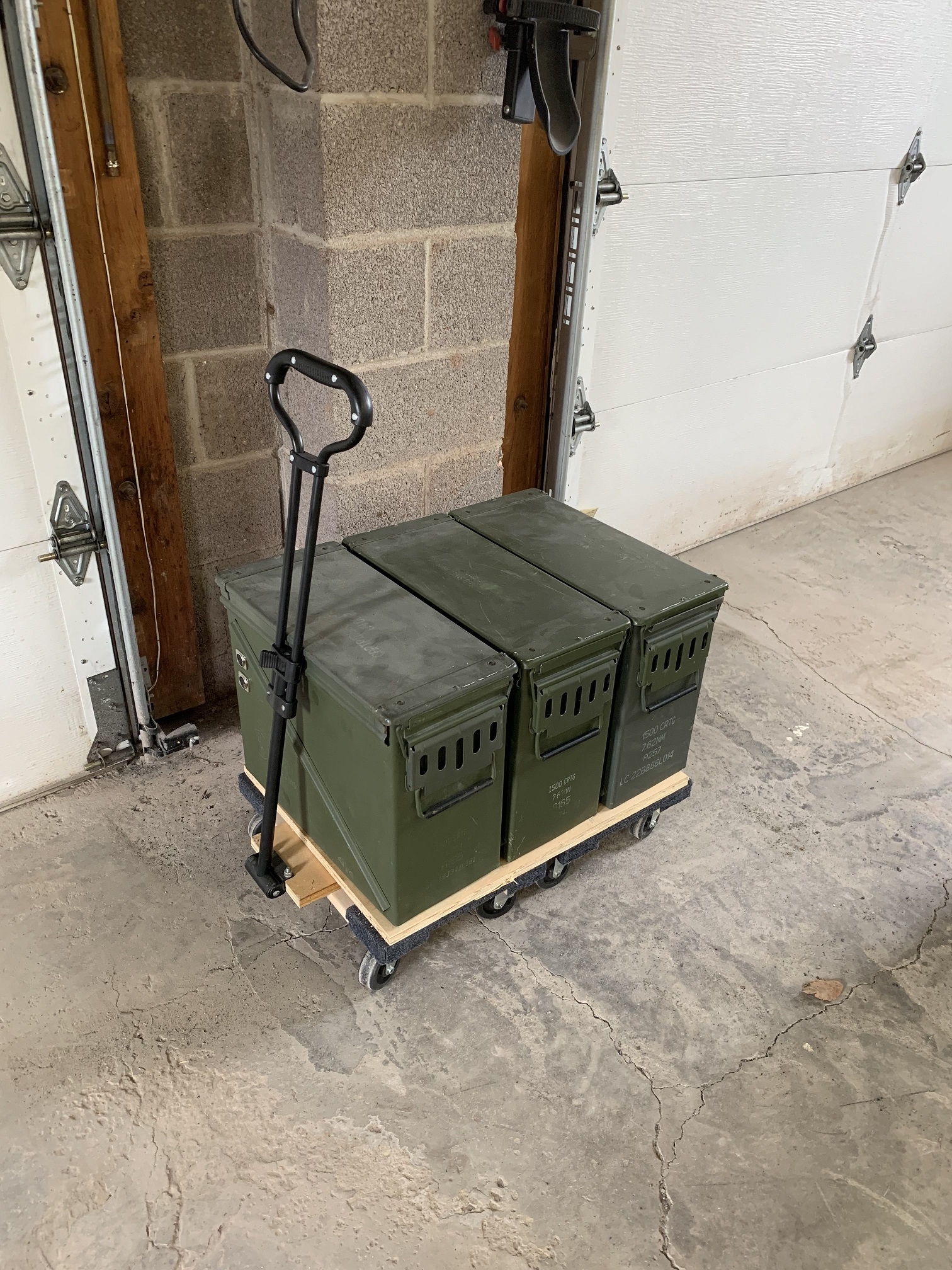

It's difficult to smother a lithium battery fire since it generates it's own oxygen. The kitty litter might help contain the fire though.
As others have mentioned earlier in the thread, I use a twist timer and never charge unattended.
I go a step further with my large lithium e-bike batteries. I charge them on a dolly on the concrete floor of the garage under a smoke / CO2 detector. Should a fire start, I can open the garage door and push the dolly outside with a garden rake in less that a minute.
When not on charge, I store them in steel ammo cans.
