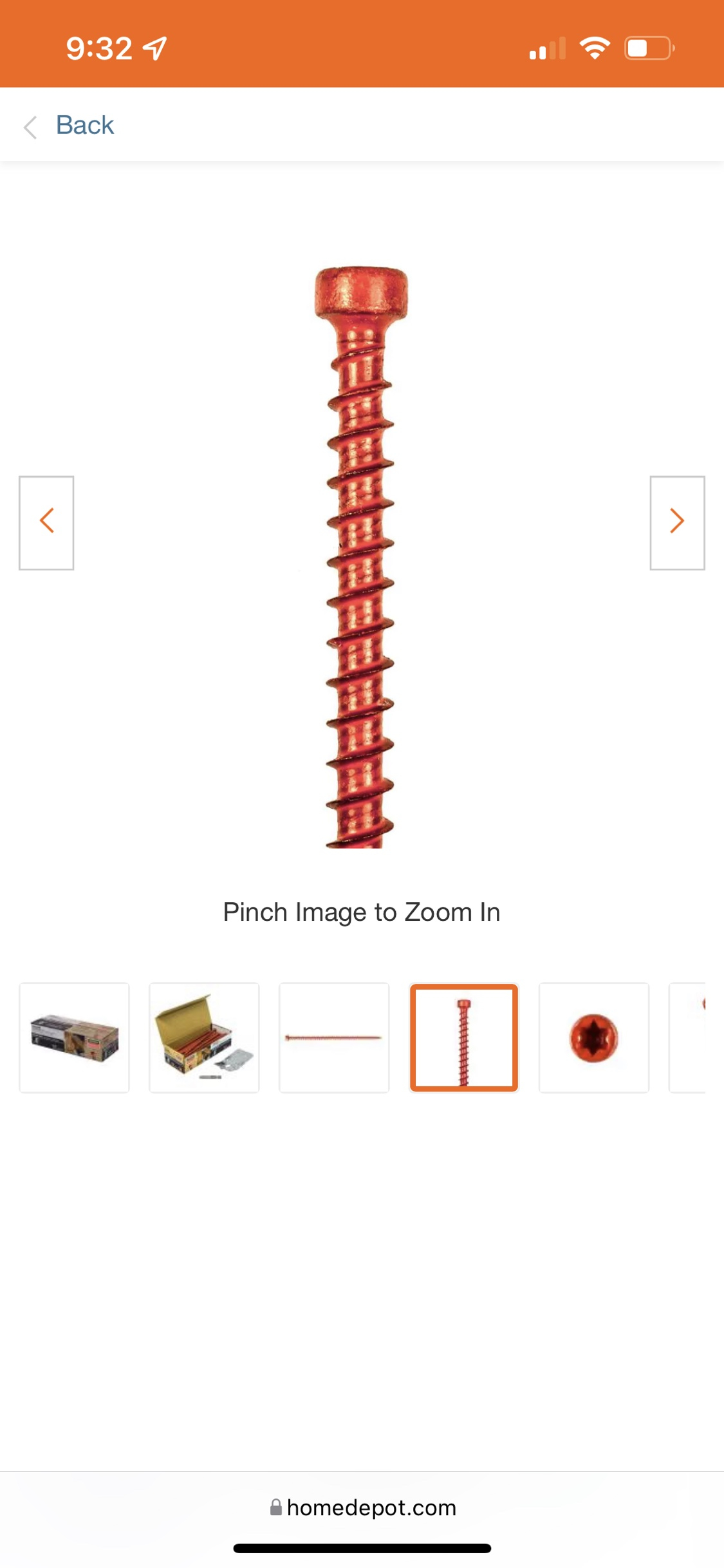

I'll likely use those nifty rafter screws if I build a new house. I'd love to be able to rent one of the tools for installing them: not sure what they're called.
It’s required by code to use those or a metal bracket to accomplish the same job just about everywhere now.
   / And you thought you knew something about nails and screws! #22
These???
Simpson Strong Tie also makes good framing screws
No the ones specifically intended for anchoring trusses have a smaller head.

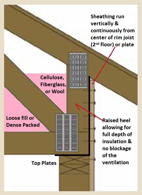

Yeah, I don't think I'd ever think/want to just toe-nail (minimum of brackets- just makes sense). But...
I also figure I'll be utilizing energy trusses and longer sheathing sheets (one manufacturer calls them "Tall Wall" panels). I'd think it would/should be the only way to go for high wind locations:
