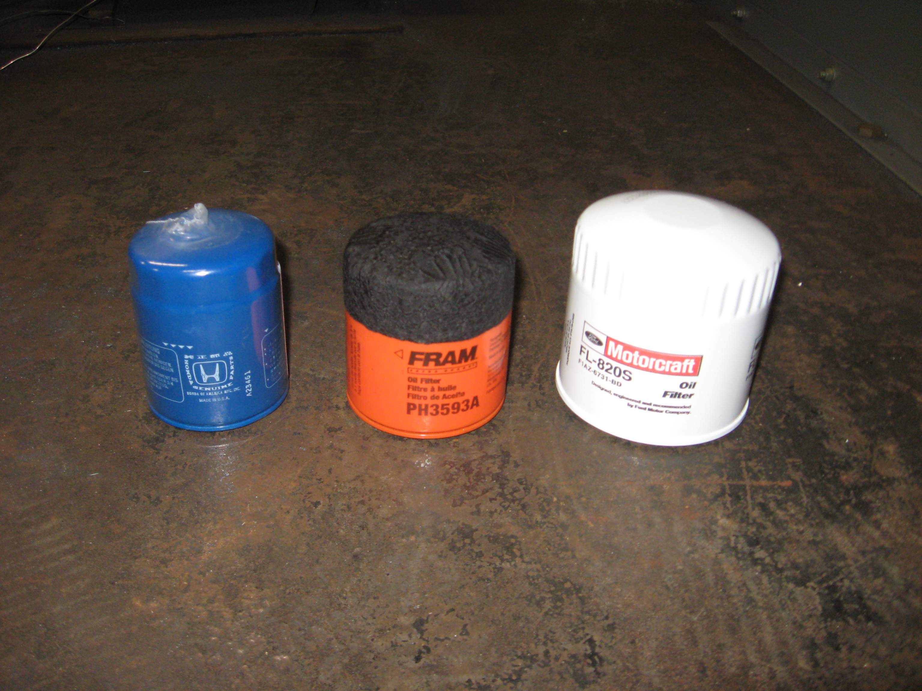

For reference, from left to right, 2010 Civic filter, 1990 Civic Filter, 2004 F350 V-10 filter. IMG_4357.jpg

For reference, from left to right, 2010 Civic filter, 1990 Civic Filter, 2004 F350 V-10 filter.<img src="http://www.tractorbynet.com/forums/attachment.php?attachmentid=296705"/>
The 2 Civic filters will interchange.
That's good information. I no longer own that car and still have a couple of those filters left over. Thanks.

I totally understand what you guys are saying, but....:), as oil quality has improved and you now have an oil that really can tolerate being in the engine 90% of the time and only rest 10% of the time, I don't see the advantage of a larger oil filter over a smaller one if they both offer the same filtration. So in an effort to help out Dave with his post. It's not so much the size of the filter as it is sufficient filtration that should be your concern.

"Same" filtration - depends how you define that. :)
For a given (specific) type of filter media and for the same fold pattern, a physically larger filter contains more media area, and can therefore trap more contaminants, before it goes into bypass. So, in terms of what I've been on about here, assume Larger = More Media, as that is a more correct way of putting it.
For a guy like me (belt and suspenders type), with all else equal, if I can safely put a larger filter (esp. an "authorized" one) on a vehicle for around the same money as the basic smaller one, then that is what floats my boat.
Yes, oils have improved quite a bit, even in the last 10 years. Some of that gain has been offset by higher specific power outputs, and other factors (ex. DI fuel loading).
Filter media has advanced (proportionally less than oils), but you only get that benefit by buying something other than low end filters.
So, agreed, compared to Olden Times (when I grew up) oil is better, pretty well across the board, and filters can be better - depending what you buy.
So.... why do old timers like me still prefer a larger (all else equal) filter ?
1) Extra insurance, at little or no cost.
2) Oil Change Intervals are pushing out. Sludge and contaminants are expected to accumulate a lot longer in a filter than days past. OCI at 10,000 miles was death to an engine in the past, not uncommon now.
