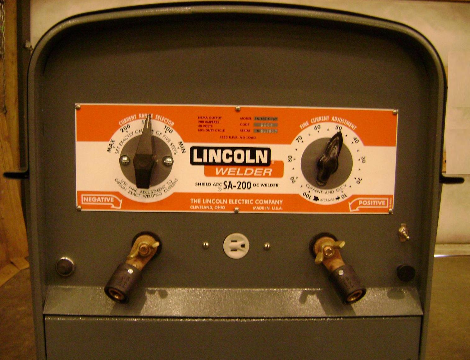

Alot of the confusion and problem with a question like this...IMO....is due to the fact that you dont actually know what amps you are running with the mig.
I remember when welding machines only came like this. Wonder how we ever got anything built not knowing where the amps, and volts where.:D
