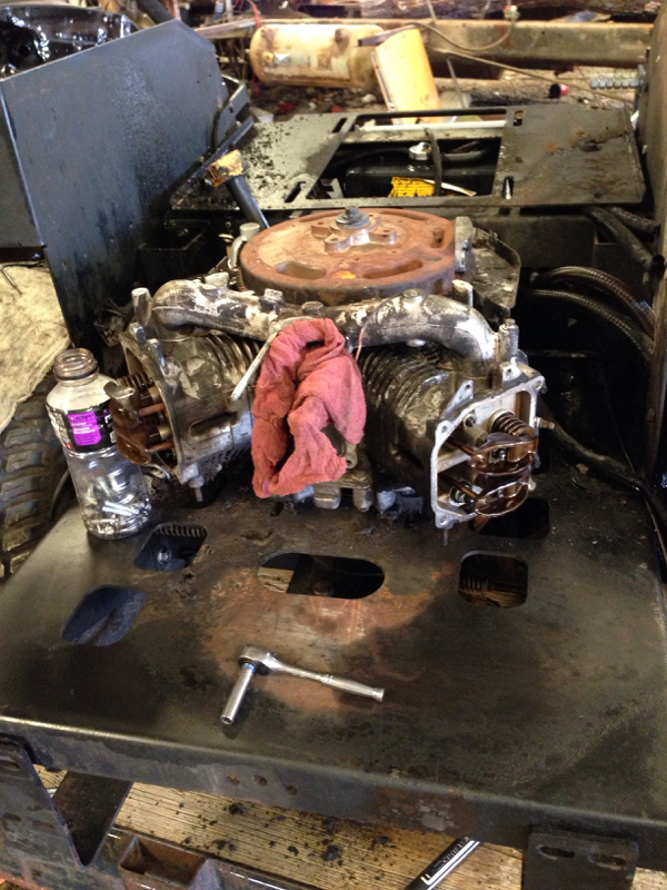

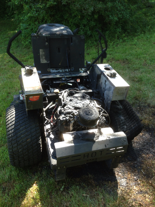

Hose came off the fuel filter. This mower has always been feed ethanol free gas. The mower died and I got off to investigate. The muffler itself wasn't hot enough to ignite it. The gas was boiling off that. It must have gotten on the headers and it was hotter.

It gets even crazier. One of my buddies was giving me crap about it. Guess what happened to his mower the next week. It burned although not as bad as mine. He believes the fire started at the fuel pump, but it's really a mystery what happened.

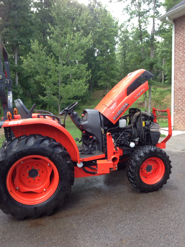

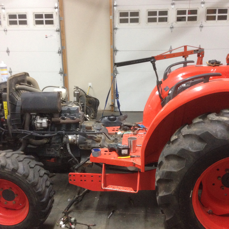

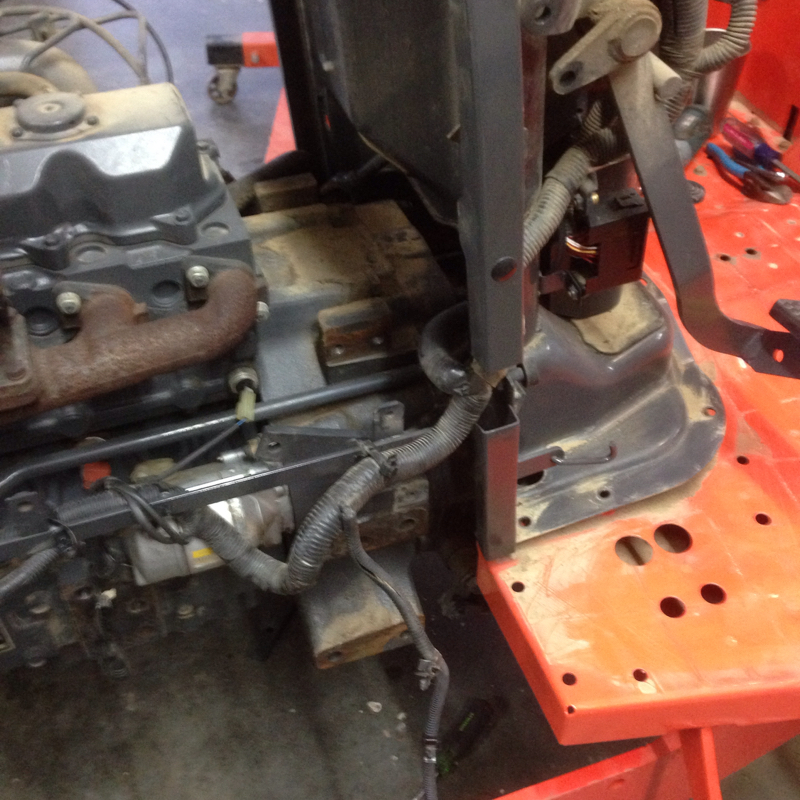

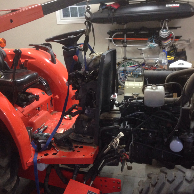

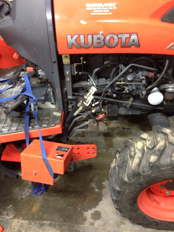

I got the steering column off the tractor. Hopefully I'll get it split tomorrow, but more realistically it'll be Thursday.
I don't want to ruin your day, but I believe you will need to remove the wiring harness from the front of the tractor in order to get the two halves split. I had to do it on my project. You'll need to start on the fuel solenoid side first. It wraps around the front of the tractor and goes toward the back on the alternator side. It isn't too bad to do. The connectors are all different for the most part so you really can't plug them into the wrong spot.
I don't think there is enough slack in the harness in the middle for you to be able to work on it otherwise...

My neighbor just started his on fire too. Actually a grass buildup over the muffler was the cause in his case, but the plastic hood was on fire and it's very close to the carb. Good reminder to clean and inspect those things and maybe mount a fire extinguisher.

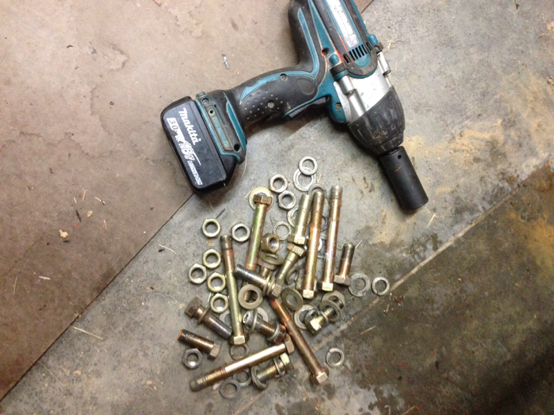

I got it split! image-2093559509.jpg image-2012440365.jpg I also bought this.
/ Am I going to have to split my tractor to fix this? #27
Awesome job! Remember, if you jack up the housing by the throw out bearing, you will lose very little fluid. On the lower seal, I ended up taking a couple of flat head screwdrivers, heating the tips up with a torch and bending the very tip over 90 degrees in order to get the old seal out. This is also when you want help to have someone keep constant pressure on the end of the driveshaft.
I was also able to pack a bunch of grease in the throw out bearing. Use plenty of grease on the shafts also. We had trouble getting the 4wd output shaft seal back in. We found a piece of plastic pipe that worked, but I would have preferred to have been prepared before. Get yourself something that will fit over the shaft and will allow you to tap the seal in evenly.

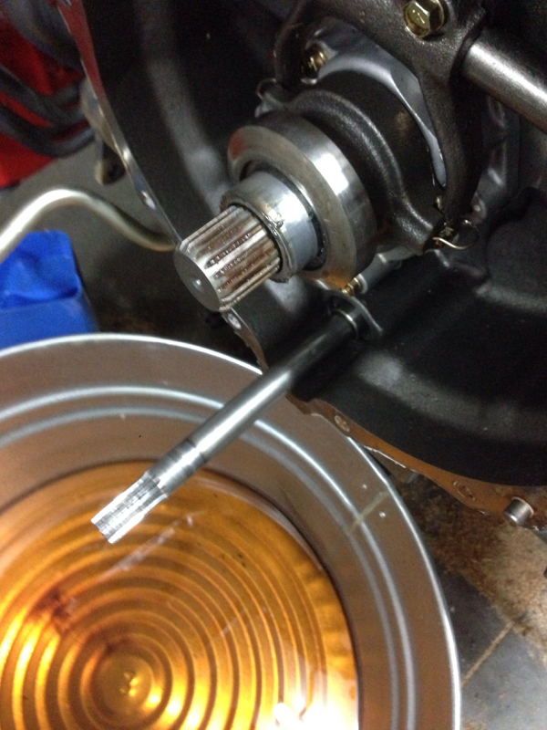

Here is my L5740 after 2 weeks at the dealer. Leak resulted from seal failure on the front wheel drive output (lower shaft in the detail pic). Not that difficult to replace one getting to this point but a lot of man hours getting to this point.
How quickly mine failed - never an oil spot on the machine shed floor until week of failure. Checked oil level at last fuel fill and was at the full mark. When leak discovered it took a 2.5 gallon jug to get it between full and low for loading.

Once down to this point the front drive shaft sequence is external snap ring, oil seal, collar, then bearing. The WSM says the drive shaft needs to be removed from the rear side. In my case, only the seal needs replacement so its remove the snap ring and seal. Dealer mechanic had it to this point and was waiting on the new seal.
