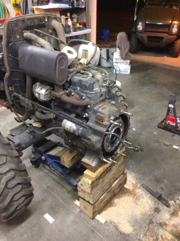

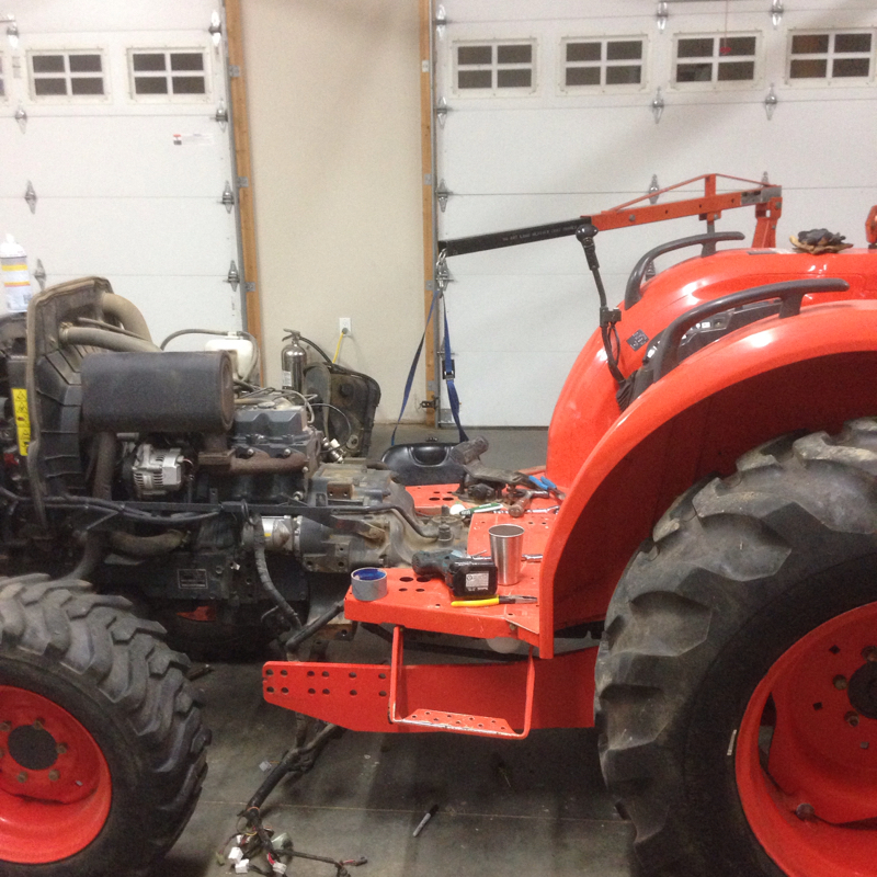

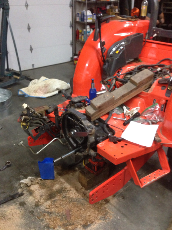

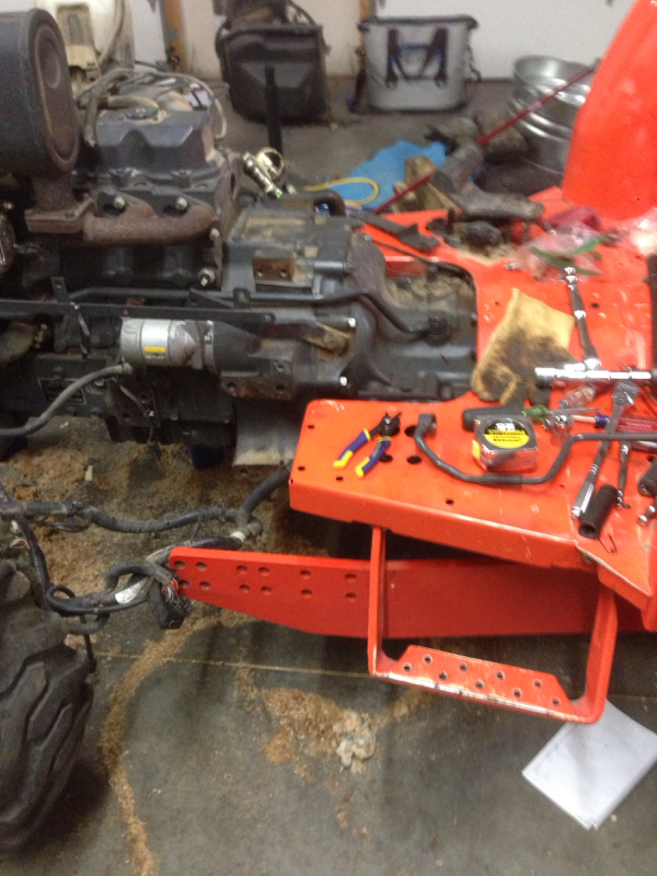

I was hoping for a picture of your tractor apart, someday my L3400 will need the clutch replaced, hoping I don't have to remove the front drive shaft to do it. The dealer wants 3k for the job and at 900 hrs. Im not sure how long the clutch is suppose to last, it's acting up now.
   / Am I going to have to split my tractor to fix this?
#48
Here's the only picture I have of the front half.

   / Am I going to have to split my tractor to fix this? #51
Good pics, hope you get it going soon with no extra bolts left over..........
