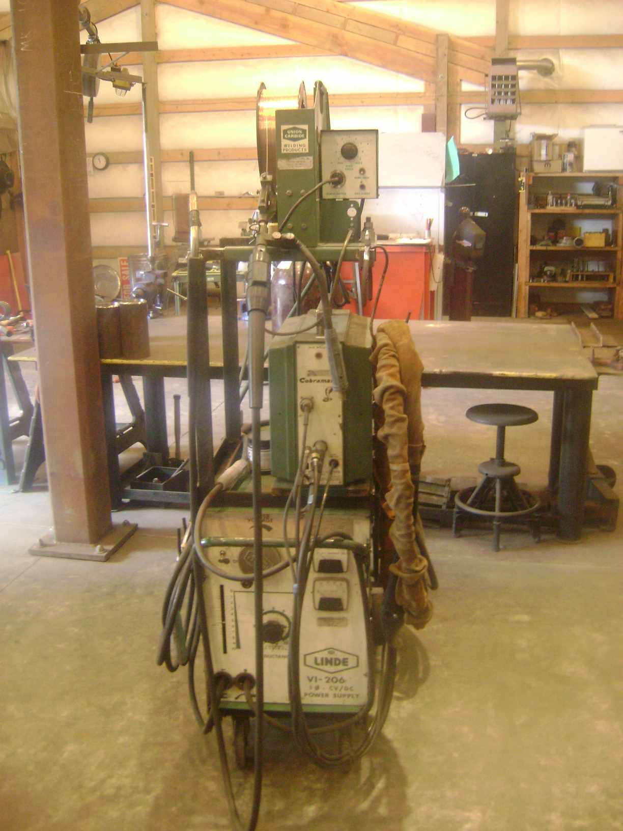

I'll add this to the already great advice given, if you can raise your machine above the work, let gravity help you.
I had a Cobramatic I ran off my Mig machine for years, sold it when I bought the V350-Pro and SG spool gun.
Here is a picture of the Cobramatic and Mig machine.

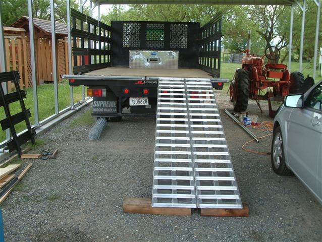

Here are a couple of videos showing welding of aluminum ramps. Looks pretty straightforward assuming you have decent equipment and a lot of practice:thumbsup:. But that's true for any type of welding:).
[ame="http://www.youtube.com/watch?v=635ER9EH7pc"]Aluminium Ramp Welding Part 1 - YouTube[/ame]
[ame="http://www.youtube.com/watch?v=SdMZBaQiobo"]Aluminium Ramp Welding Part 2 - YouTube[/ame]
I bought a couple of these ramps (10 ft long x 16" wide, 48 lb weight) to load my parade tractors onto my Isuzu NPR stakebed truck.

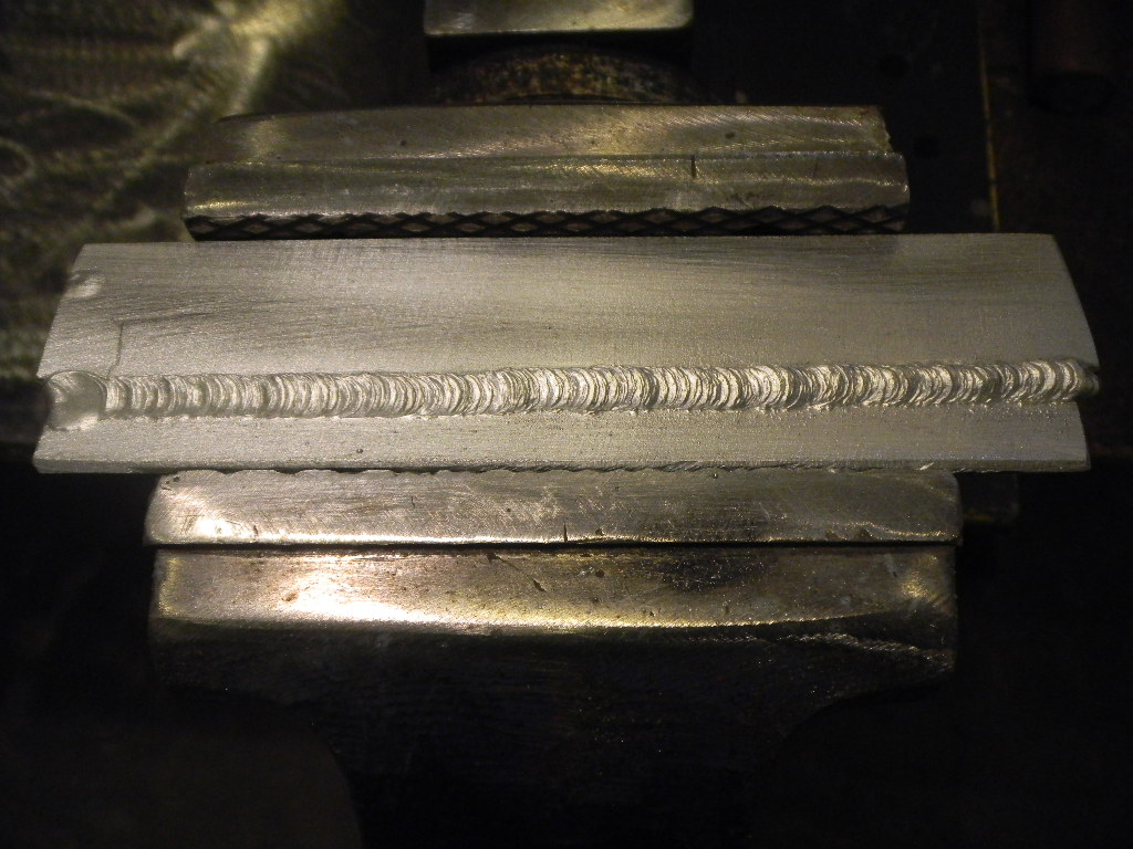

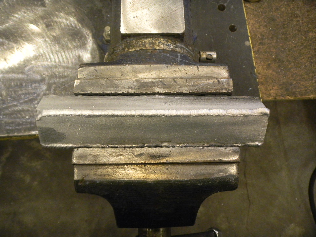

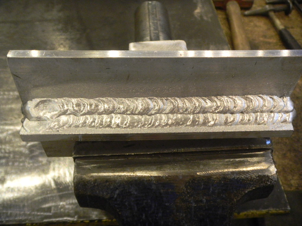

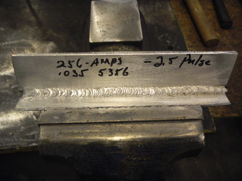

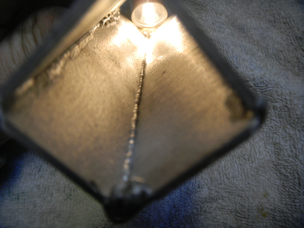

I don't hardly ever work with aluminum. When I got my new Lincoln Invertec V350-Pro w/ pulse, and SG spool gun I gave it a whirl. First two pictures are with pulse, not sure I like the pulse, travel speed is really slow, compared to with out it. With aluminum I push. With Mig steel I try to push, but I'll pull / drag too. Anything with slag I'll drag!
