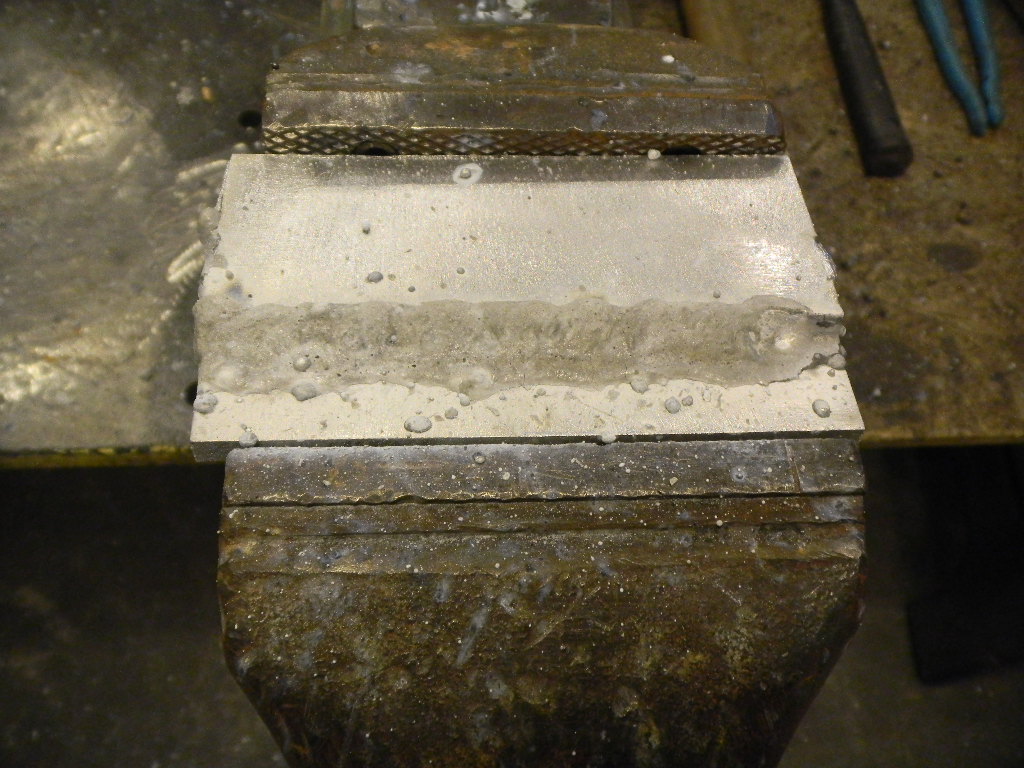

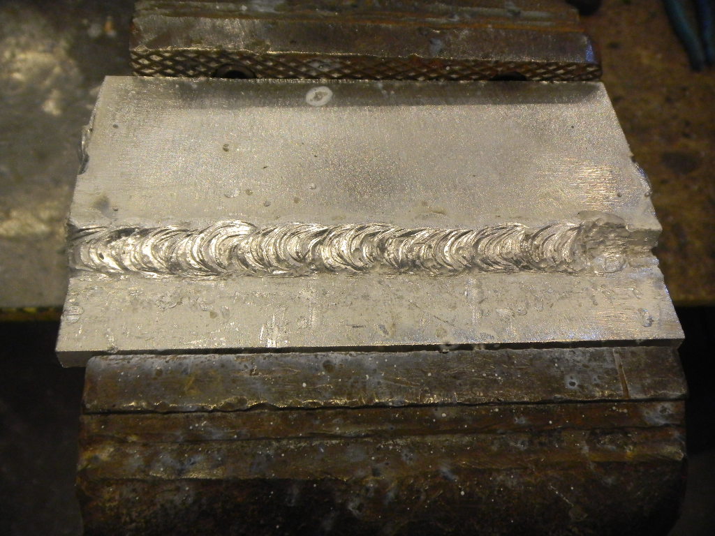

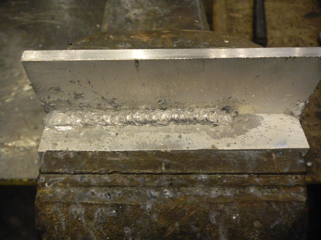

Picked up some 1/8-inch Lincoln Aluminweld 43 rod the other day. Did some playing around with it this morning. I've had this 1/4-inch aluminum plate for at least 30-years laying in the junk pile. Took a stainless steel wire wheel and cleaned it up, and tacked up some lap joints. I played with the arc force, but it seemed to work best at 0.0 on the arc force, and 125-amps. I ran it with a back and forth whip motion, (like 6010) with a lot of rod angle trying to force the slag behind the puddle. This stuff burns fast, you have to make sure your hands are not in any kind of a bind, because you won't have time to adjust. You also have to hold a very close arc, I found it ran best when I just jammed the rod right into the puddle! This weld is 4 3/4-inches long, one rod! She don't go very far.:eek:

Tried it years ago and did not like the results. I only ran a few rods but I guess I didn't really give it a chance
/ Aluminum Stick welding
I don't like the results either! I need to spend more time with it. Next time I think I'll do a side to side weave instead of a back and forth whip. It burns up so fast, and there is such a heavy slag, you have to really search for the puddle through the slag.

Might look better if I didn't have to beat the crap out of the weld with a chipping hammer. :rolleyes:

Are the welds strong with good penetration. Have you tried cutting your lap joint? Or could you severe the weld so that we can see how much penetration you got

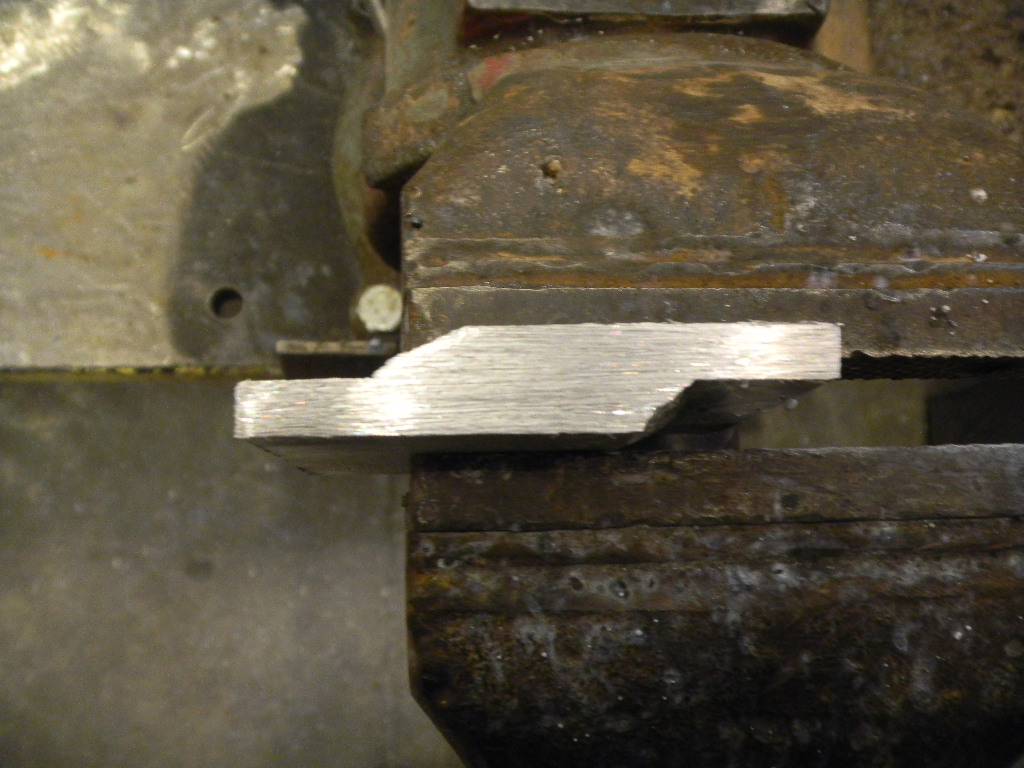

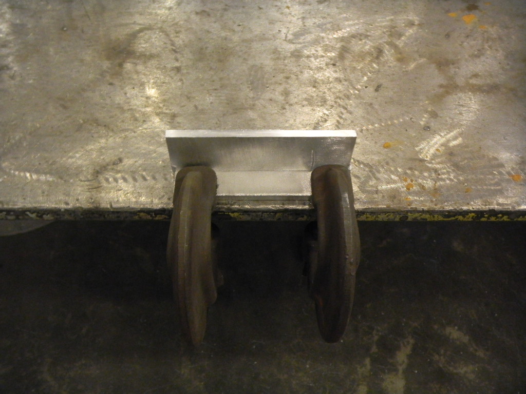

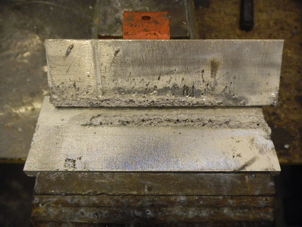

I'm not impressed at all with this stuff! Maybe I need to go back to school.:eek:
I did cut the lap joint weld in half. Can't really see much. But the fillet weld is horrible! Only took one blow of a 4-lb hammer to break the top plate off.:thumbdown:

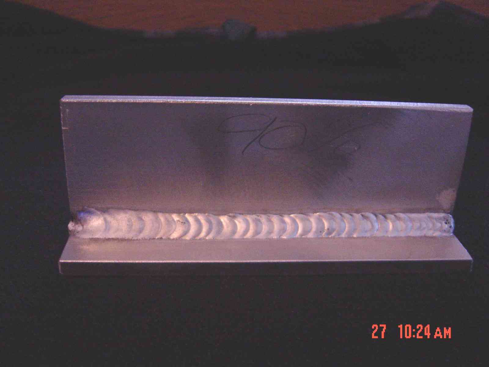

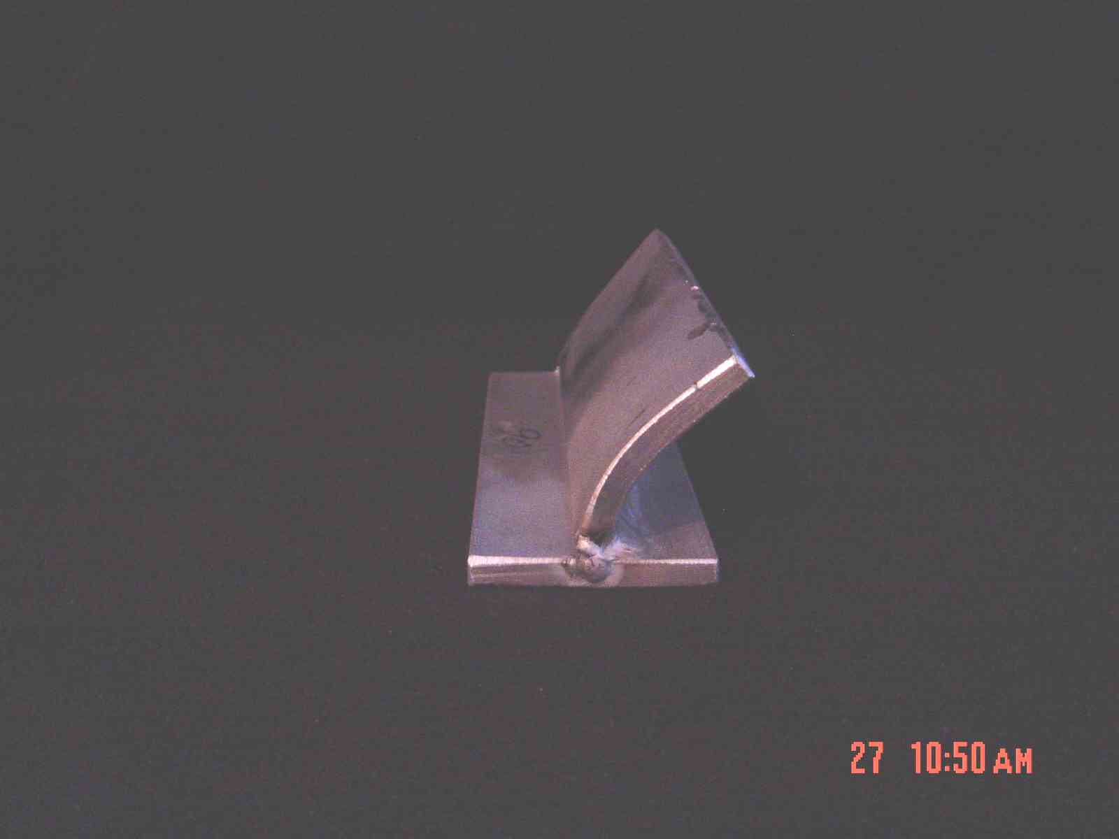

Here's a Tig weld I did when I first got my Dynasty 300, (7-years ago). I can't remember any details, but looks like the top plate in the second picture took several hits.

Wow - lots of porosity in that one!

Yes, shocking! Maybe it's the base material, I have know idea what type of aluminum it is.
