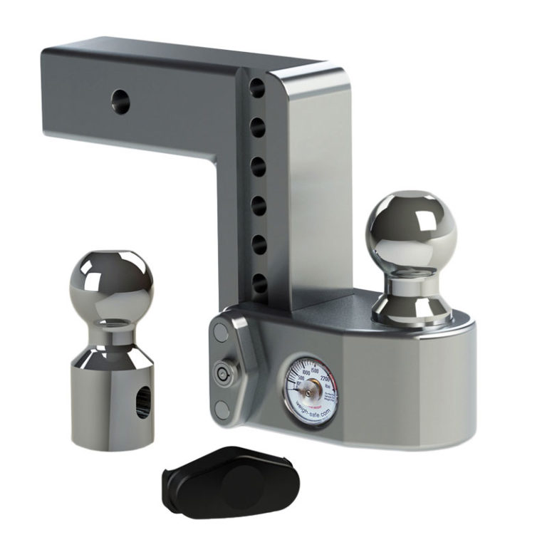

I have the Weigh Safe hitch. No complaints. It's actually a lot lighter than it looks.
Weigh Safe Trailer Drop Hitch | Award-Winning Tongue Weight Scale

The fastway 18000 lb and the weigh safe 180 @ 14500lbs are the 2 I am looking at. The way safe locks on and has stainless steel balls, both options I like. My largest trailer is a 14000 lb trailer. When loaded with my tractor the calculated weight is apron 13200 lbs. Would the 14500 lb weigh safe be acceptable or is it too close to hitch capacity. I wish I didn't have to over analyze everything I purchase.
/ Aluminum ball mount #8
Why bother, get the 18k for piece of mind. Fastway has an optional ball lock you can purchase if you wish.
I can tell you hauling what I think is xxxxxLBS can often be a good deal more than what I estimated, why risk it.

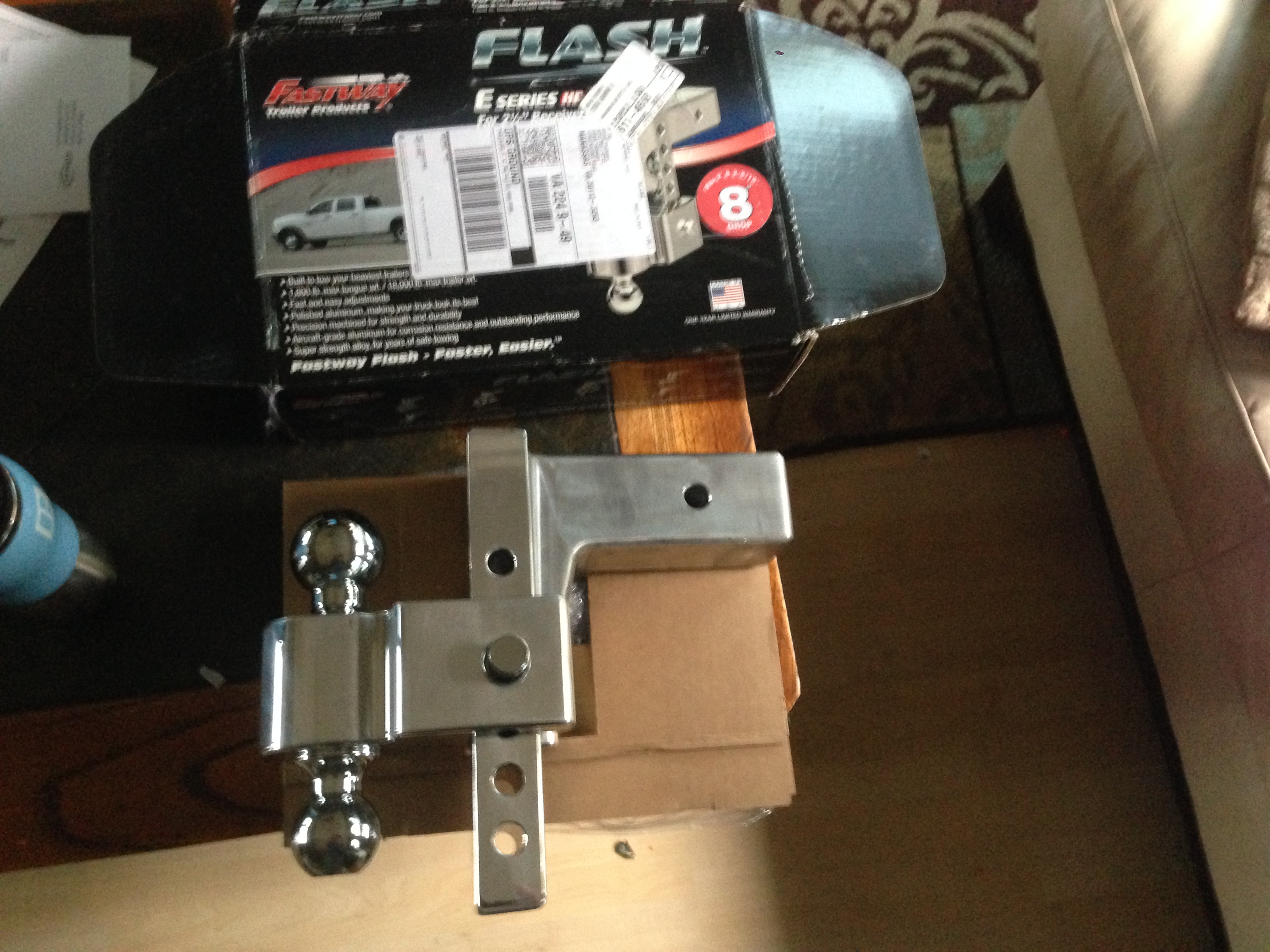

When I got my 2013 Ram 3500 I had to upgrade to the larger 2-1/2 receiver, did not want to run the spacer they provide. I went with this big chunk of aluminum, it hangs on the truck all the time and has dragged some pretty heavy loads.
Fastway E series HD 18k capacity.
2nd for this Fastway. This is what I have on my F250. Same 18k version. Heavy and very well made.

Thanks for all the advise. I went with the Fastway 18000 lb for the xtra peace of mind and purchased the lock pins for it. Sometime you know the right thing to do but you just need to hear it repeated back to ya.
