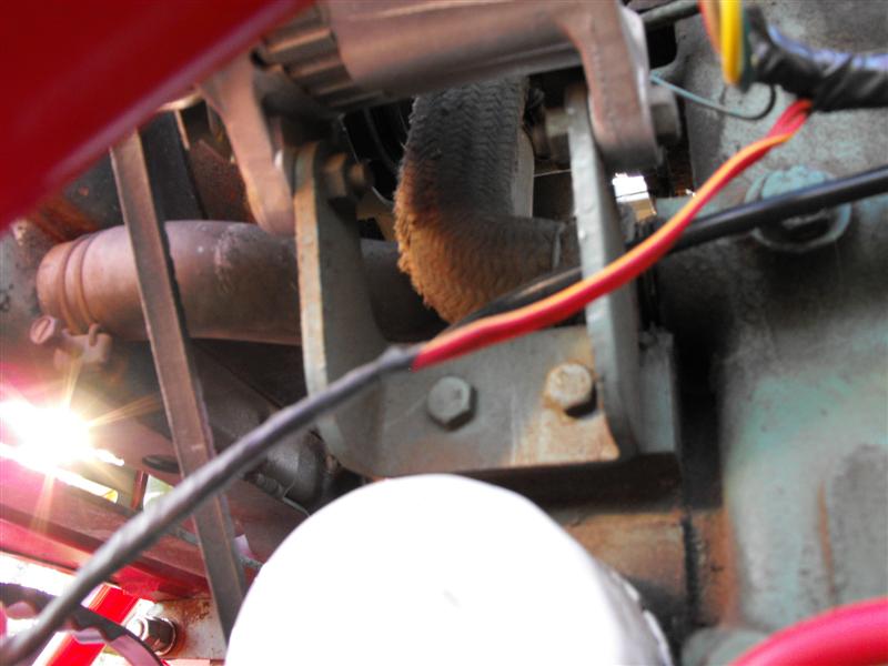

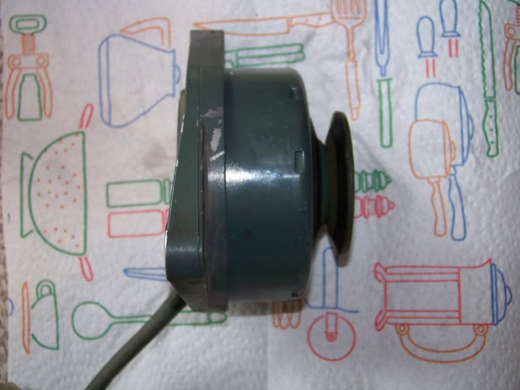

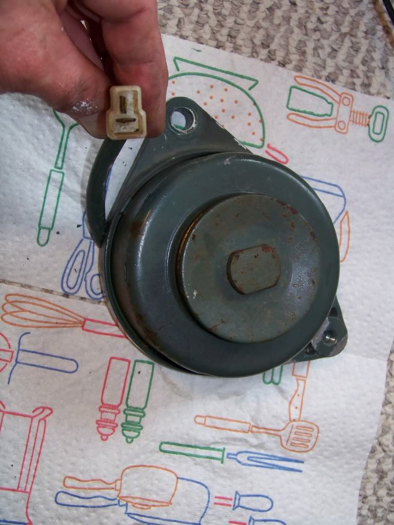

Need some info folks. I want to run some additional lights on my YM 2020D and need more than the 15 amps or so the dynamo provides. Can I direct swap the dynamo for the 1972 Datsun 510 alternator? This Dynamo has a real small foot print and I am wondering if I am out of luck.
Couple of other questions -
1. does the dynamo provide 15 amps? Is there a higher capacity dynamo available?
2. If there Datsun alternator is an option - is the regulator I have reusable from the dynamo to the alternator?

I have considered the LED's but they are far more expensive.
I do not mind replacing both the alternator and regulator - I think it would run about $60 total. I was hoping that the datsun alternator was the same width as the dynamo. Do you know if it is?

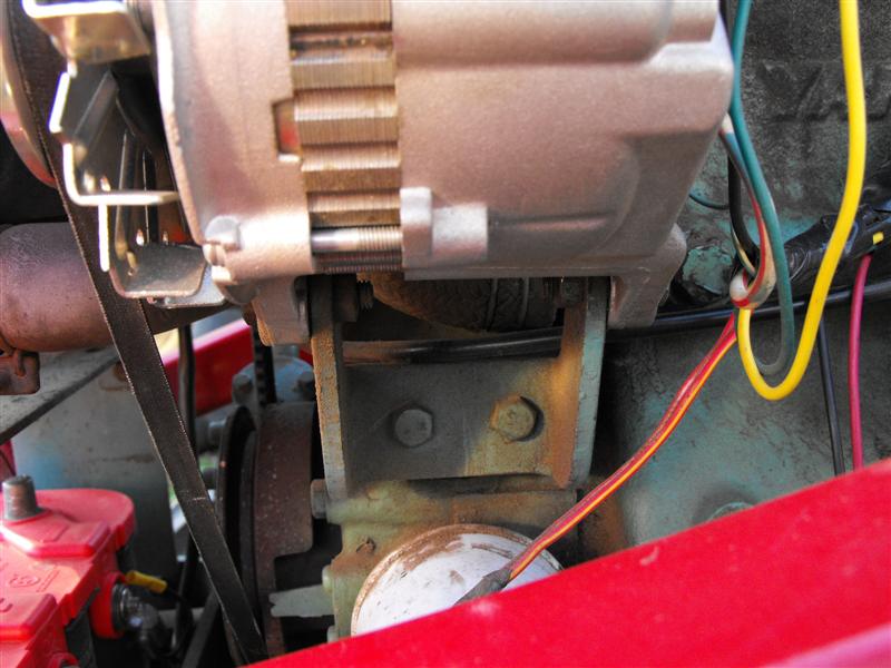

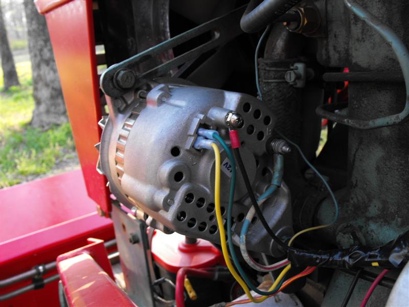

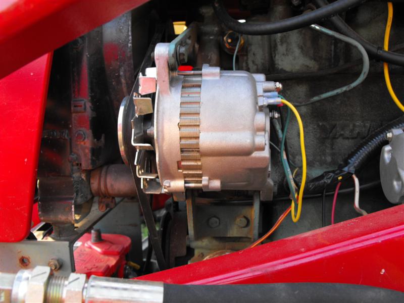

Here is the Datsun alternator and the mount it needs. Hoye can probably supply you with the mount or you can build your own. Your plug should fit right in the back of it. I couldn't find a plug so I used two coated connectors. I also had the the original 15 amp alternator and my voltage regulator is working fine with the new 35 amp alternator.

No, I replaced my 15 amp alternator with a 35 amp. Kept the same voltage regulator. I was saying it shouldn't matter to the voltage regulator what amperage you are using if it is an old style mechanical regulator. The new solid state regulators will likely have a limit to what they can control. Mechanical regulators sense the voltage difference and pass the current across the relay contacts. Solid state use transistors, diodes and such and will have a limit to what they can pass and dissipate the heat.
