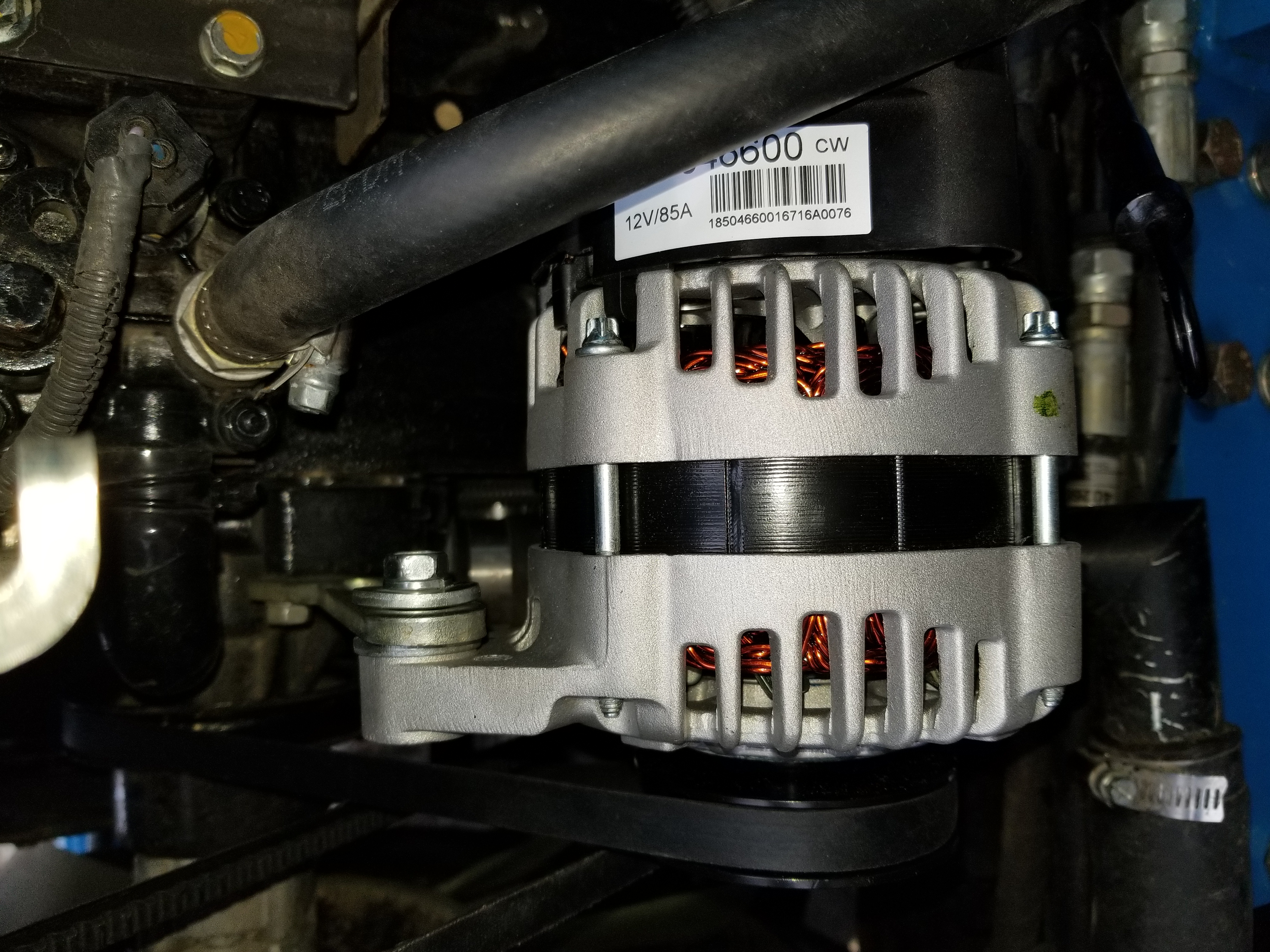

Have no doubt That I will , never seen this before during all my years with diesels ... just thought maybe someone here might have an ideal as to what causing this being this is a LS tractor form. ... Some good ideals but so far none has located the issues ....
/ Alternator Belt #24
Alternator spins free also no noise ... Alternator shouldn't get hot when starting engine.

What size is your alternator? 50-60 amp or 100+.
If you are pulling the battery way down and then the alternator is maxing out, it would be pulling hard.
Is your alternator pulley polished or glazed?
Is your belt the right width for the pulley? I have seen belts that were to narrow and would run in the bottom of the pulley, if they do they have very limited power transfer, they need to grip the sides of the pulley. If it has a half inch wide belt try a 5/8 width one.
/ Alternator Belt
#26
Book calls for "A" belt did look a bit small for the pulley but that's what came from factory...Don t knothinkw about the amps will check when I place the altnator on a tester this evening...Thinking you may be on to something

_called dealer , he is calling in factory rep. Going to test alternator this evening after work ...dealer says it's a 85 amp
/ Alternator Belt
#30
Just got a call back from dealer , factory rep thinks it's the air pump , kind of doubt it being it's not driven by this belt ,will check to be sure , if it was locked parts from it's belt could have damage the fan /alternator belt..seems they have history of getting water in them and locking up when below freezing......

Air pump had slipped , alternator checked out electrically bearings could still be bad ...next step is to wait for some clod weather and have someone start the tractor while I watch the pump and alternator pulleys ....marked both with paint pen ..waiting on some old weather...when all else fails return to the basics

Only have trouble in cold weather , check with a mechanic ,he thinks something is breaking down in the alternator when dips below freezing , LS has sent me a replacement ...going to install and send the old one to a local repair shop for a full rebuild an see if they can locate the problem.....got to love LS some other brands would have left me holding the bag.....

When the belt is slipping get a IR temp gauge and see what pulley is hot. If it is the alternator I would suspect you have some sort of short that is causing the field to be on full at crank. How is that air pump driven? When it won't crank loosen the belt and see if it starts. Then check each pulley to see what is tight. Might be tight only under a load of a bearing is going and binding when a side load is applied but I would think you would feel some roughness. If you think it is the alternator you can pull the connector to the back as well to se if that changes anything

Dealer sent me a new alternator, problem seems to be solved
Taking old one to shop for repair...

Alternator and water pump are on a common belt .
Air pump his it's own belt
The air conditioning pump has its own belt also and all tree are a diffent size....

I'd venture a wild guess that the cold shrinks a bushing in the alternator to the point of seizure.
OK, a wild guess but for sure a possibility.
Only 2 things run on that belt. Alternator and water pump and you eliminated the pump.
What else could burn up a belt? also the new alternator now runs OK.
So, sounds like a good polishing of the alternator shaft and or reaming of the bushing would cure the problem.
Generally alternators have a ball bearing at front end with bushing at the rear.
