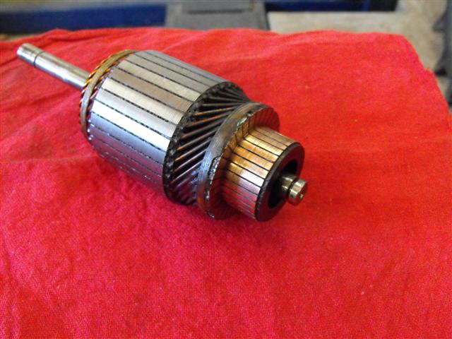

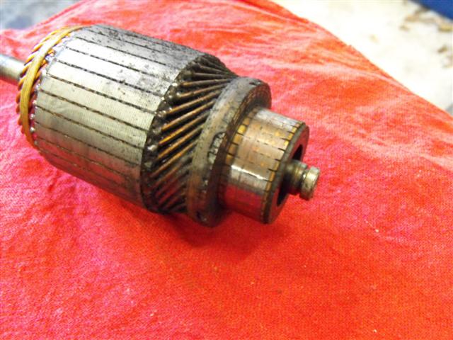

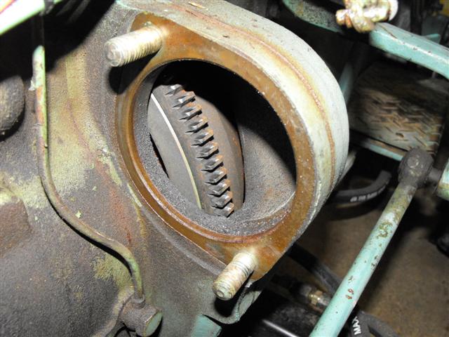

Just wanted to post some things I found while working on the alternator and starter. It got to the point of having to use the compression release to get the engine to spin as the starter wouldn't turn the engine over without it. Took it apart to see if it could be cleaned and maybe get some more life out of it. This is what I found. Cleaned everything and lubed and re-cut the armature to get the gap's back. The starter turned the engine over without having to use the compression release but not all that fast as I had hoped.

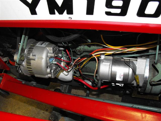

I didn't bother with trying to do anything with the alternator, just replaced it with the help from the posts on here. Found one and it went in perfect and works great.

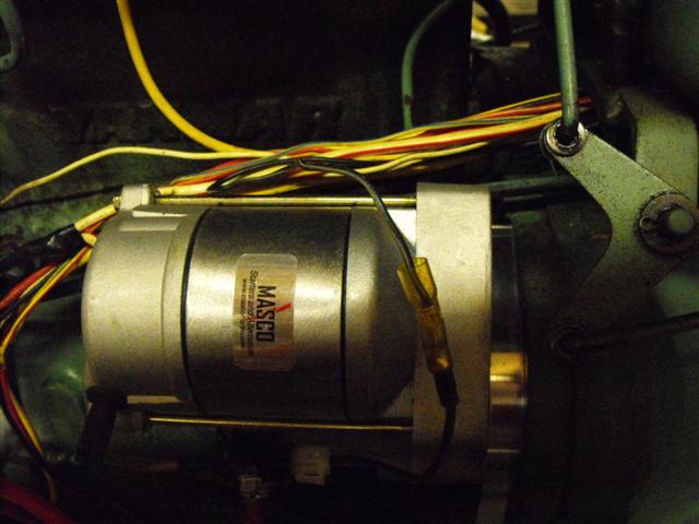

I went ahead and replaced the starter and glad I did. This one spins the engine much faster than the original and costs considerably less. Hope it lasts a few years as I'm really happy with it. It's a higher torque version than the original replacement and you can really tell the difference. I think it spins the engine faster without the compression release than the old one did with the release pulled.

I found the starter and alternator surfing the web. The starter is from Masco and the alternator form Compact Tractor Service. Both seemed to have quite a few useful parts for Yanmars.
I had heard some say that there are starters that don't fit or the teeth don't go all the way into the flywheel. I measured the starter gear travel on the new one and it matches the length of the old one so hopefully it meshes completely. I thought about bluing the starter teeth to see if it actually does. One nice thing also about the starter is that you can get a socket on the bolts unlike the old one.

Mine has 4 brushes but it was still showing signs of a lot of wear. If you notice in the photos, about 1/8" of the bendix teeth have ground off and and is laying in the bell housing. The solenoid was dragging a little and probably lead to the teeth grinding off over time. There was a lot of buildup in the starter too. It worked better after cleaning and re-grooving the armature but still not as fast as I wanted. The new starter spins the engine like a car starter does. Don't even have to touch the compression release even at 30 degrees.

Each starter tells what model it fits. I used the one for the YM2000/YM1700 since the YM1900 is about 90% the same as a 2000. The part number it says it fits is the same part number in my manual.
