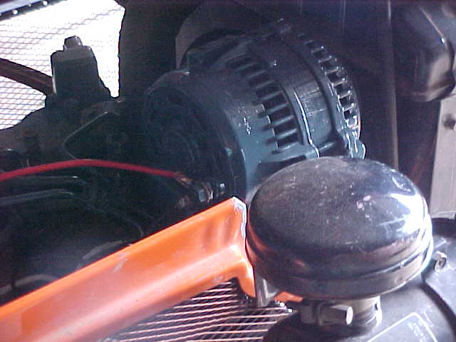

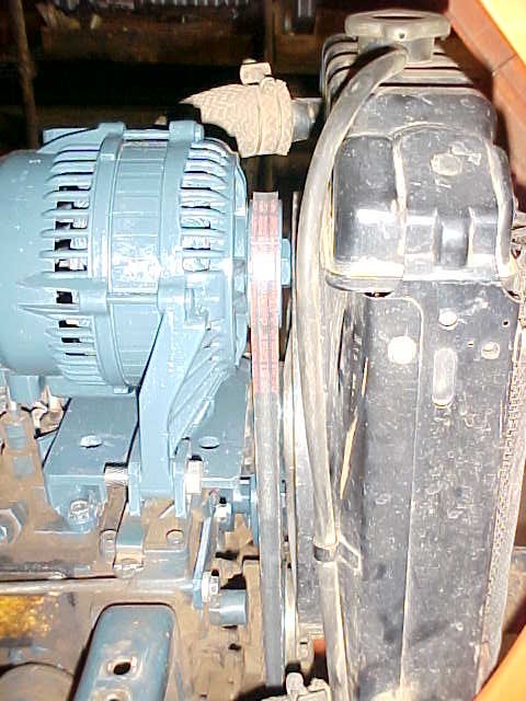

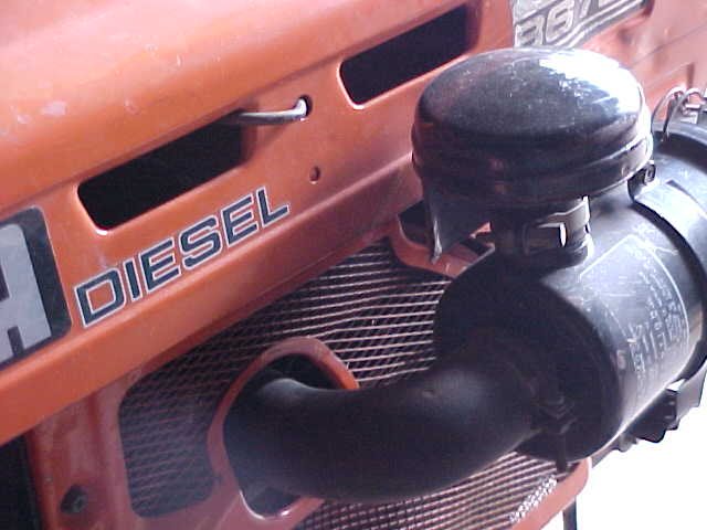

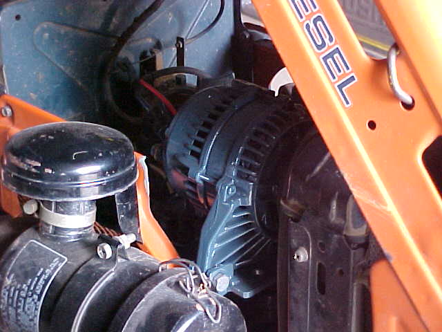

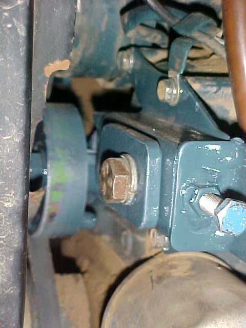

Recently fitted a car alternator to my aged Kubota B6100E which only came with a little dynamo.
Had to weld up a base plate which attaches to bolts on the head and fuel injector pump of engine.
Also needed to cut away the bit of the side panel which is hidden anyway when the hood is down.
Modified the jockey pulley on the LHS so it pushes the belt in under the water pump pulley to tighten the belt but at the same time provide more contact with that pulley.
