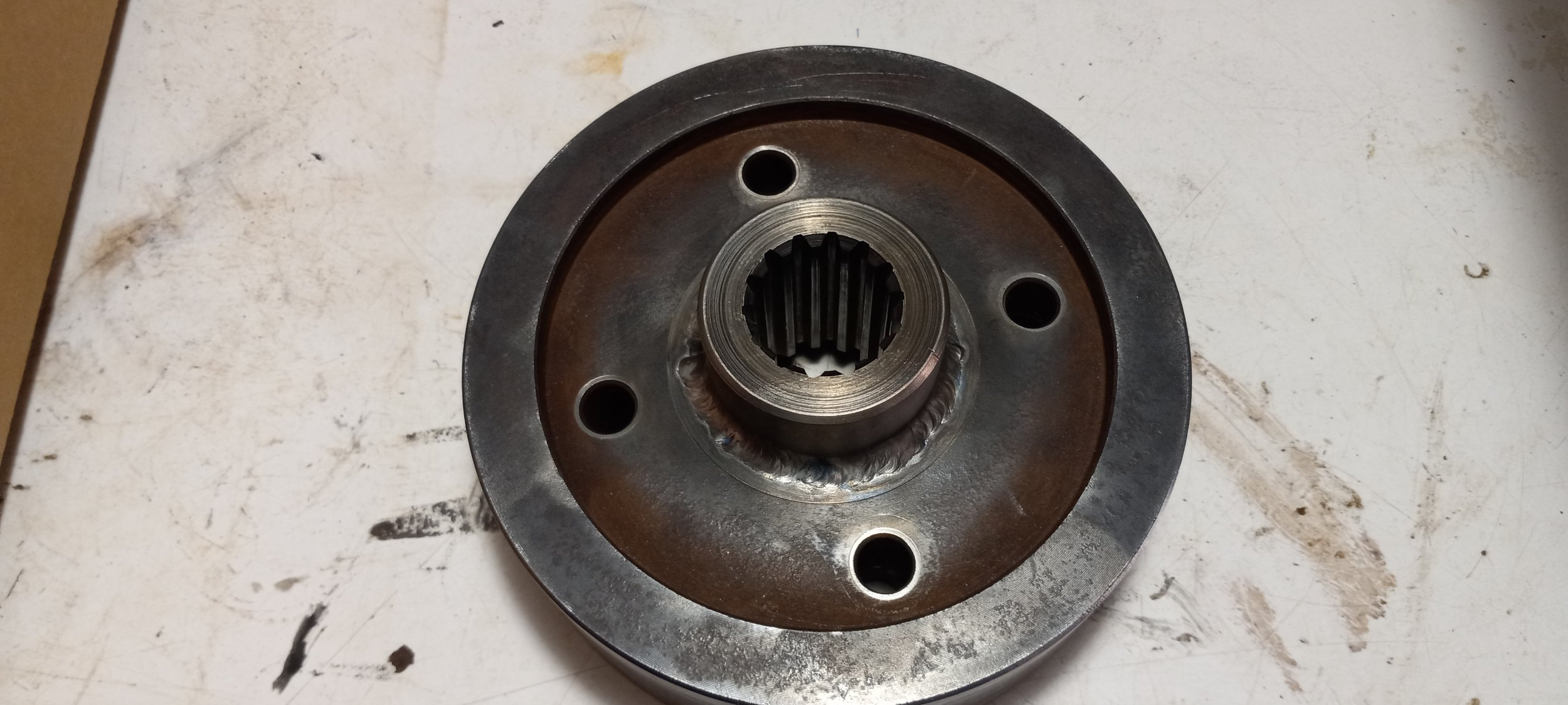

Here's a picture of the drive coupler (center)and TorqMotor (left) before I sent it out to the local machine shop.
The splines in the coupler were stripped out.
The machine shop took the 1-1/4" 14T Splined "WeldaCoupling" from G & G Mfg (left) and integrated /welded it into the center of the hub (see below)

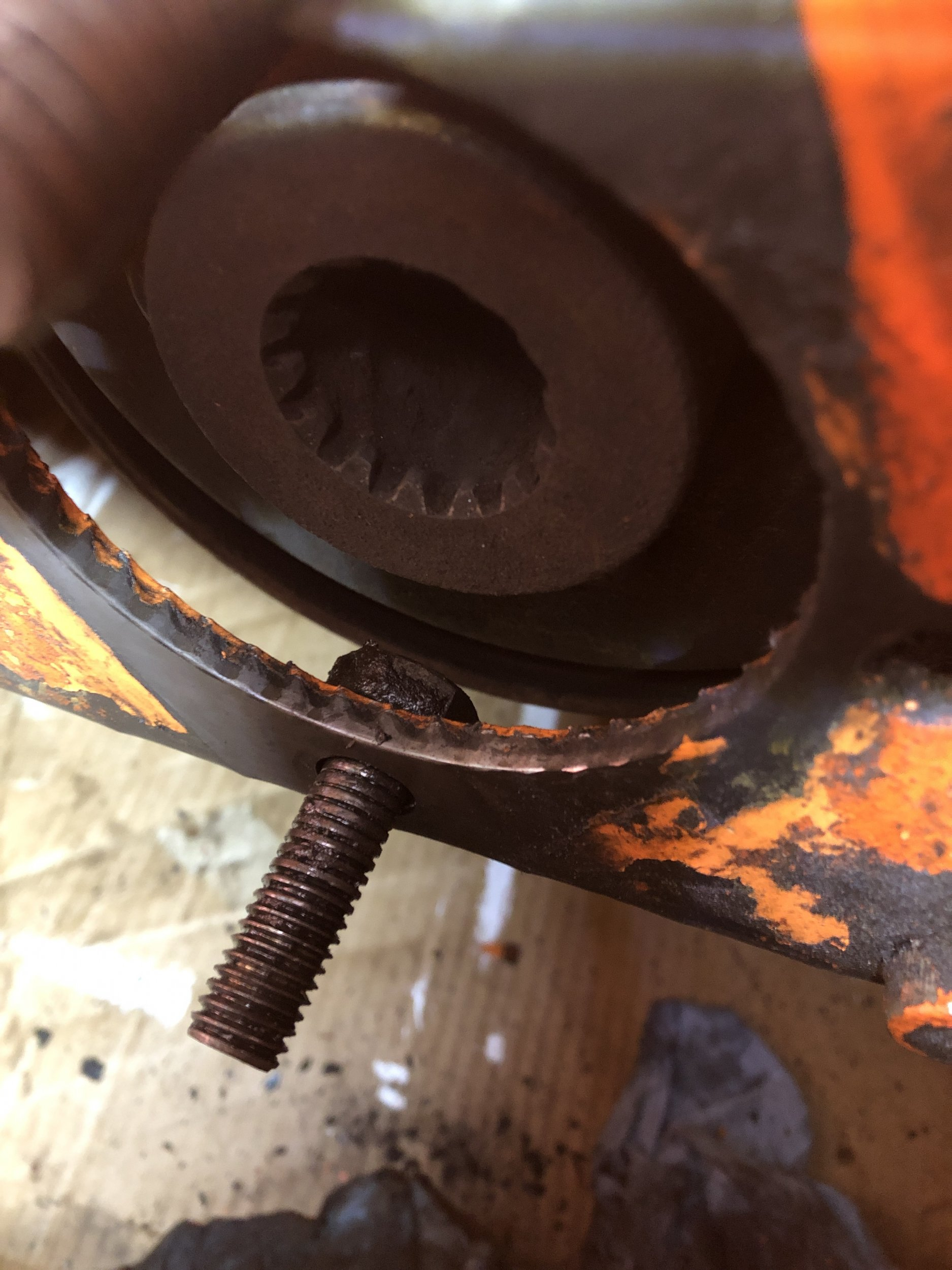

I’m pretty sure the doubled up nuts rattled loose and that’s what caused the shaft to loosen a bit from the coupler leaving it to strip. Once I pull mine apart if it matches up exactly to yours I’ll prob do the same fix you did. Do you have a name for the machine shop you used? I’m considering using the same shop since you have already used them and they understand what needs to be done. I just have to make sure my hydraulic motor didn’t get twisted up in the process because when I had the wheels off the ground I could see the motor wiggling as it was trying to spin the tires. Luckily I bought a set of those jic cap and plugs off Amazon a year or two ago so if it has the right size I can atleast plug the lines so it’s not dripping everywhere. The kit was around $70 and has made dealing with hydraulic lines a lot easier when running to get new lines made or routing the hoses. Highly suggest a kit like that. What other problems are you having getting yours back together? I’m all ears if you need any help

The guy that I used is:
Marc Bois
M & B Machining & Welding LLC
11 Spalding Avenue
Nashua, NH 03060-5101
(603)882-4327
mbmachining@comcast.net
He did a great job and it cost $200. The dimension on the shaft on my motor is 1.25 inch in diameter with 14 splines. I bought the weld on coupler on line for for @22.00 dollars

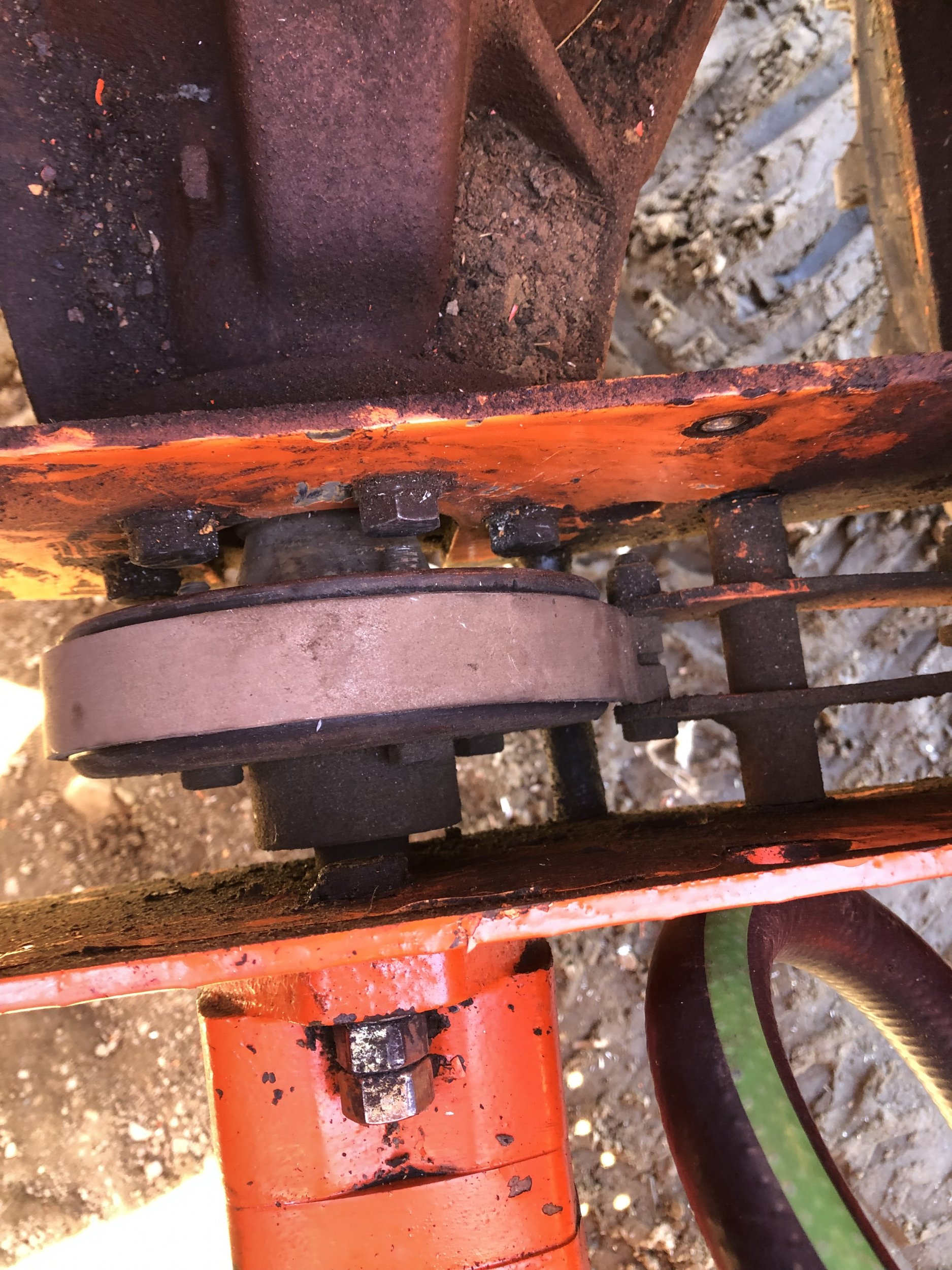

Thanks for the info! Have you messed with adjusting the pedal at all? I recently loosened the locknut on the long threaded rod that connects down to the pump and gave the rod a few turns. I felt like I wasn’t getting the full throw of the foward reverse pedal even though the pedal itself was bottoming out in both directions on the foot rest. I have a replacement motor on my tractor so the neutral switch wasn’t connected when I bought it. Recently I took out the mechanism completely if you need one it’s yours. When cranking the tractor have you tried depressing the pedal for foward or reverse a little? My tractor won’t really start if the pedal isn’t in neutral anyway because it causes the pump to have to work and it is to much strain for the little starter. It will try but a quick jiggle on the pedal usually does it

No, I haven't touched any adjustments on the pedal /rod at all. The hydraulic shop took the pump apart to do an inspection and test. I don't know if any of the adjustments changed.My plan is to engage the dump valve bypass on the pump. That allows the tractor to be towed so no fluid to drive motor. Then use the auxiliary pump to raise the tractor off its rear wheels. Then disengage the bypass with rear end in the air. Then, I can figure out what's going on. Thanks for the offer, but I'm good with the neutral switch.
/ Allmand TLB 25K (not hydraulics) #13
When trying to engage the pedal I noticed the cam follower was loose on mine. So I tightened #32 I believe it was. It’s the lone nut that holds the whole assembly to the shaft coming out of the pump. I also might take a dremel to the follower plate #37 because mine was worn to the point it made an extra grove and wasn’t rolling smooth.

When trying to engage the pedal I noticed the cam follower was loose on mine. So I tightened #32 I believe it was. It’s the lone nut that holds the whole assembly to the shaft coming out of the pump. I also might take a dremel to the follower plate because mine was worn to the point it wasn’t rolling smooth
#24 in the diagram is what I originally adjusted because reverse was barely engaging. Then worked my way towards the pump end of #24 and tightened a few things. I had a service bulletin in the paper copy of the manual that came with the tractor stating how these parts loosen up over time

I used an cordless impact gun. I took the mounting plate for the hydro motor off. That give you a better shot at them. The brake band assembly can stay in place. I also found it easier to disconnect the the brake cable (down by the brake band)so I can get to the bolts that hold the motor mounting plate on. W hen I put it back together I used anti seize.
Got almost everything back together. The reverse creep was corrected by following the guide in the manual. Installed the battery tray and belly pan. I moved it closer to the garage today so I can finish it off. I have a temp gas tank ( 1 gallon) strapped to the rear fender. I plan on getting the rear axle seals replace. I had them done about 14 years ago and there leaking on the rear wheels. I use a shop in Manchester. The job requires a press. When that's done, I'll install the main gas tank. The thing with the 1 gallon tank, you really can see what a gas pig these Kohler Twin engines are.
Look like a 14 T spline count on that coupling. Same exact failure. I though about moving the hydro motor forward about 3/4 inch to catch the remaining splines in the coupler, but that's cheating.
Nice! I did end up getting it off doing the same exact process. Kinda nice to have it all apart to clean it up a bit. Until the shaft coupler wore out the drive motor and differential were the only parts I haven’t done some sort of messing around with yet because they seemed good. I guess a little further inspection will be needed because I’ve never even had the rear wheels off the tractor or even checked the torque of the lug nuts. I did tighten the parking brake with the handle adjustment at one point. I have a replacement predator 22hp engine which is basically a Koehler clone. My gas tank is in front up between the engine and oil cooler/ nose piece. Usually 5 gallons will get me a full day of running the tractor which isn’t too bad considering the amount of dirt it moves in that time. Because my tank is up front I have an empty cavity in the tractor from the battery back to the backhoe. At some point I’d like to fab up a toolbox for chains and the backhoe thumb piece so everything stays with the tractor. I’m glad you got yours moving for now. It’s a struggle moving these tractors when the drive is out haha. I had a flatbed tow mine home for me. Do you happen to know the size in cubic inch of the drive motor? I’m looking around for a replacement just in case I put everything back together and the shaft got tweaked.
